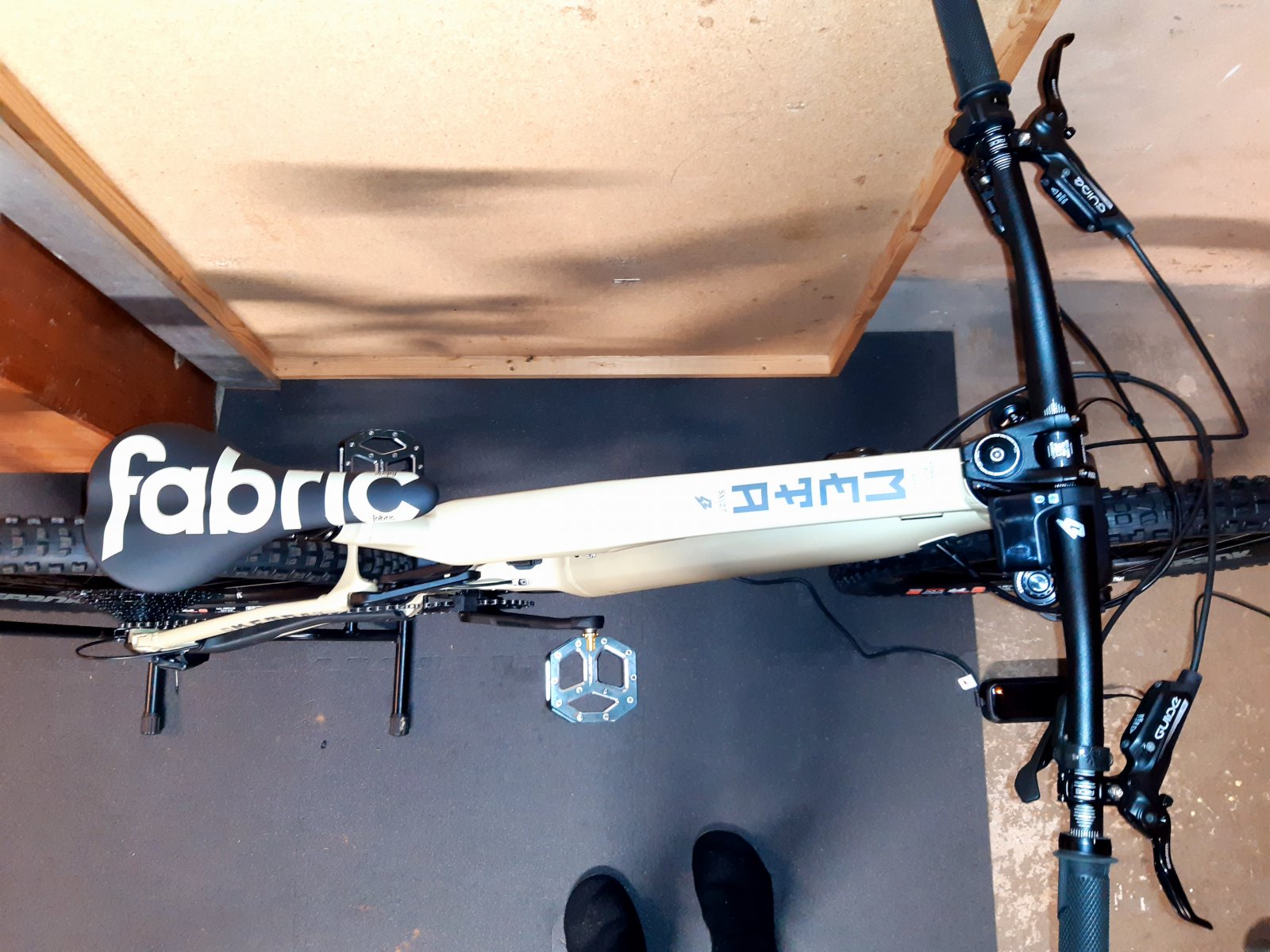

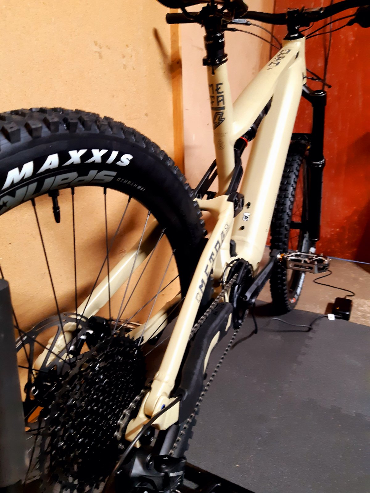

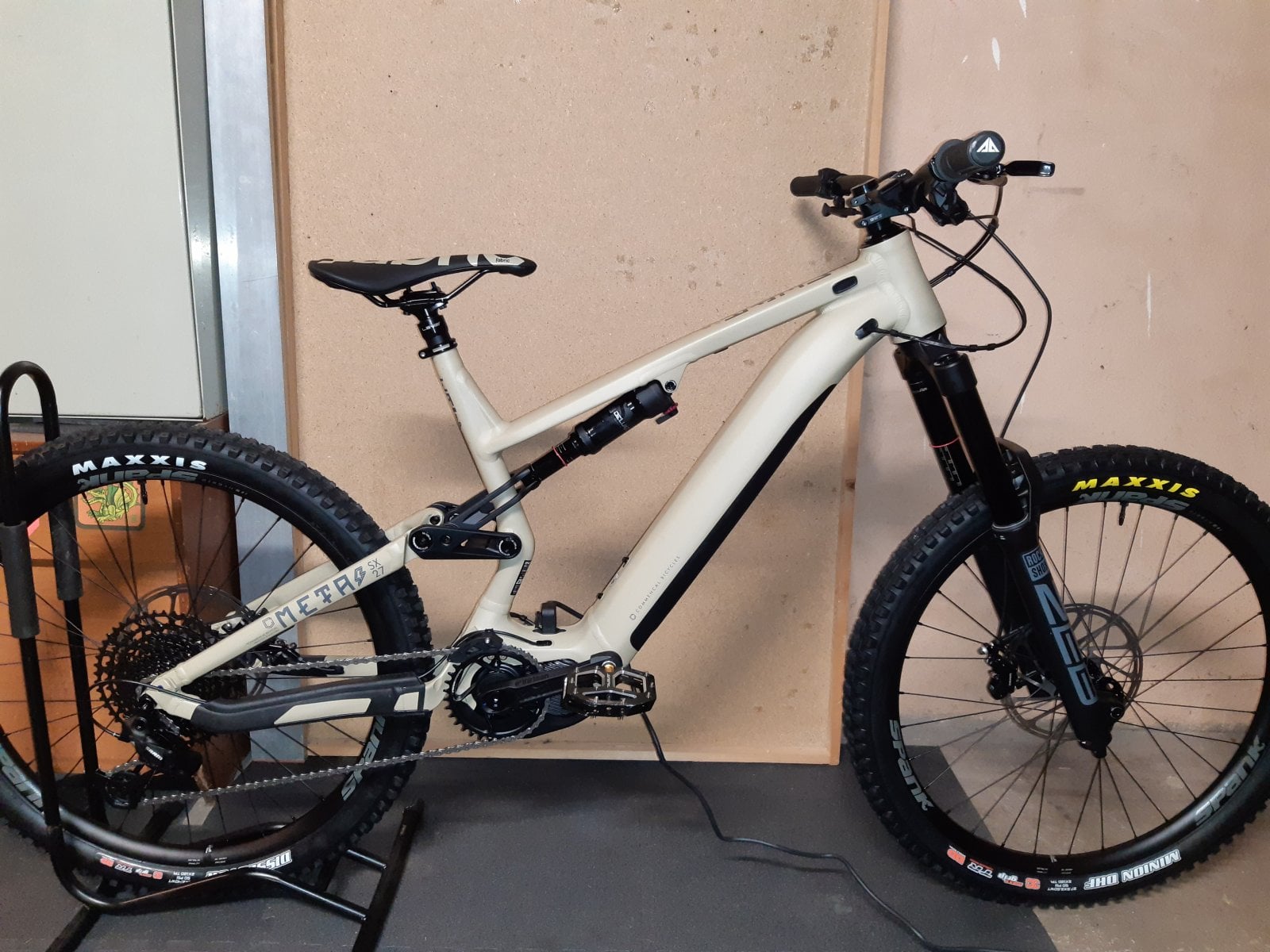

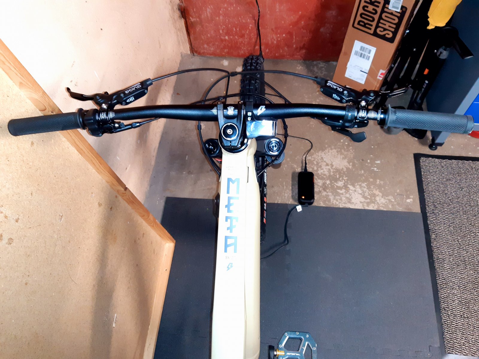

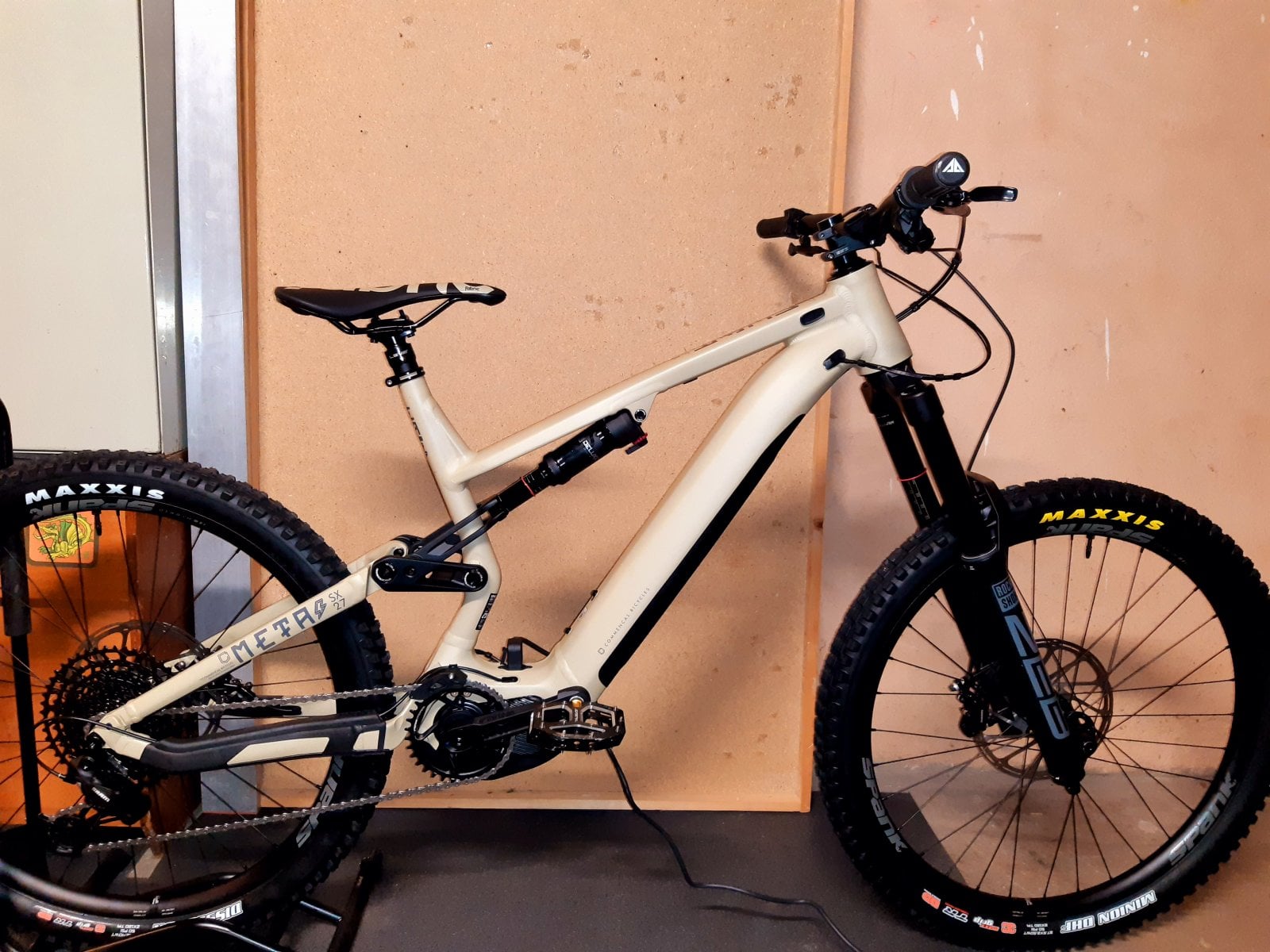

Ive just recieved my Meta Power a few hours ago thought id share some pictures. x)
Didnt have the chance to ride it jet and now the sun went down so i cant tell anything about the Riding characteristics jet.
Gonna hit the trails tomorrow. ;)
Swapped the front tire to a DHF. Rear derallier following same goes for the fork cartridge as soon as its available.
Oh btw, the welding/frame quality isnt one of the best ive seen so far.... but it looks solid enough for me. :D

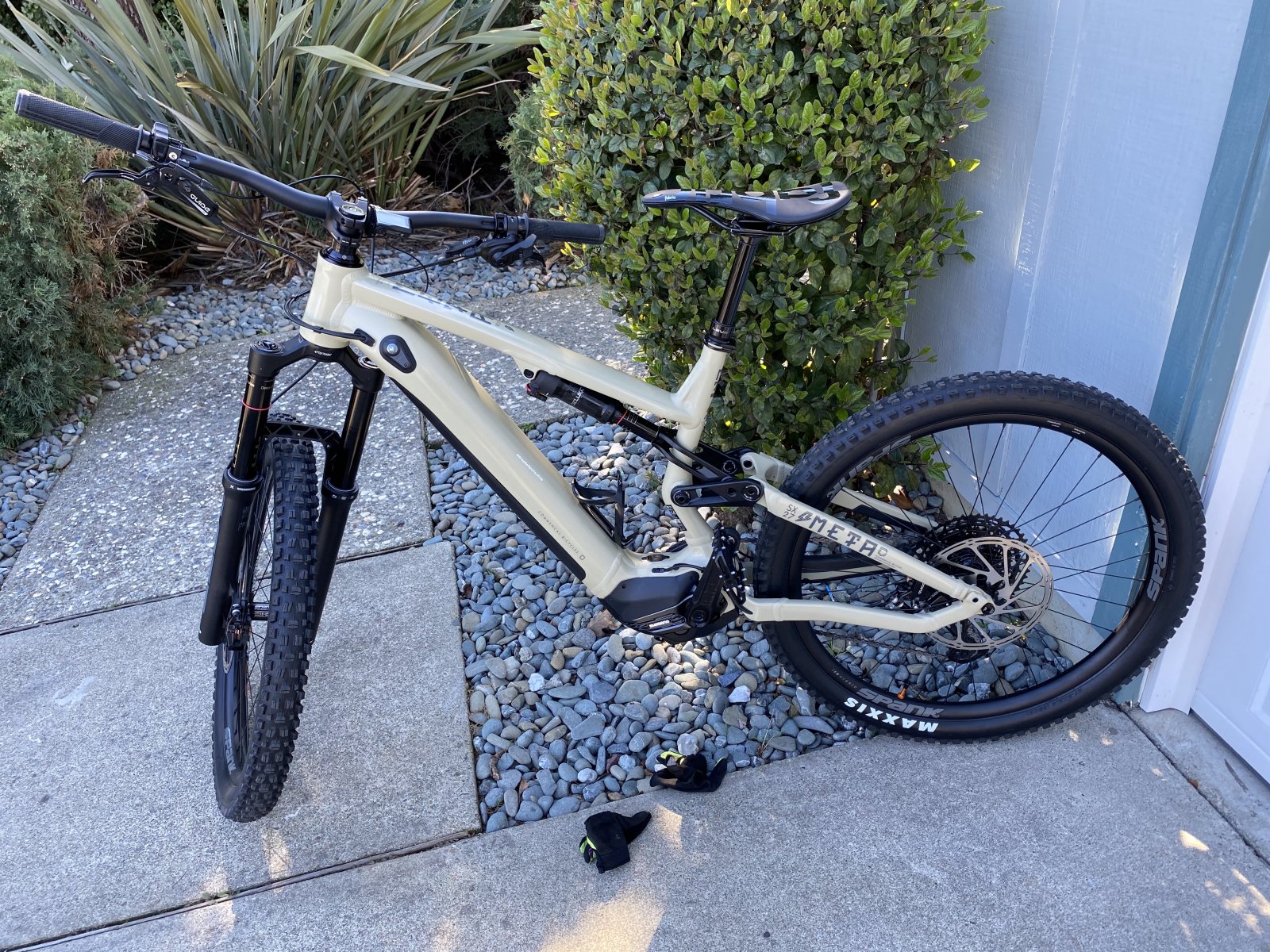

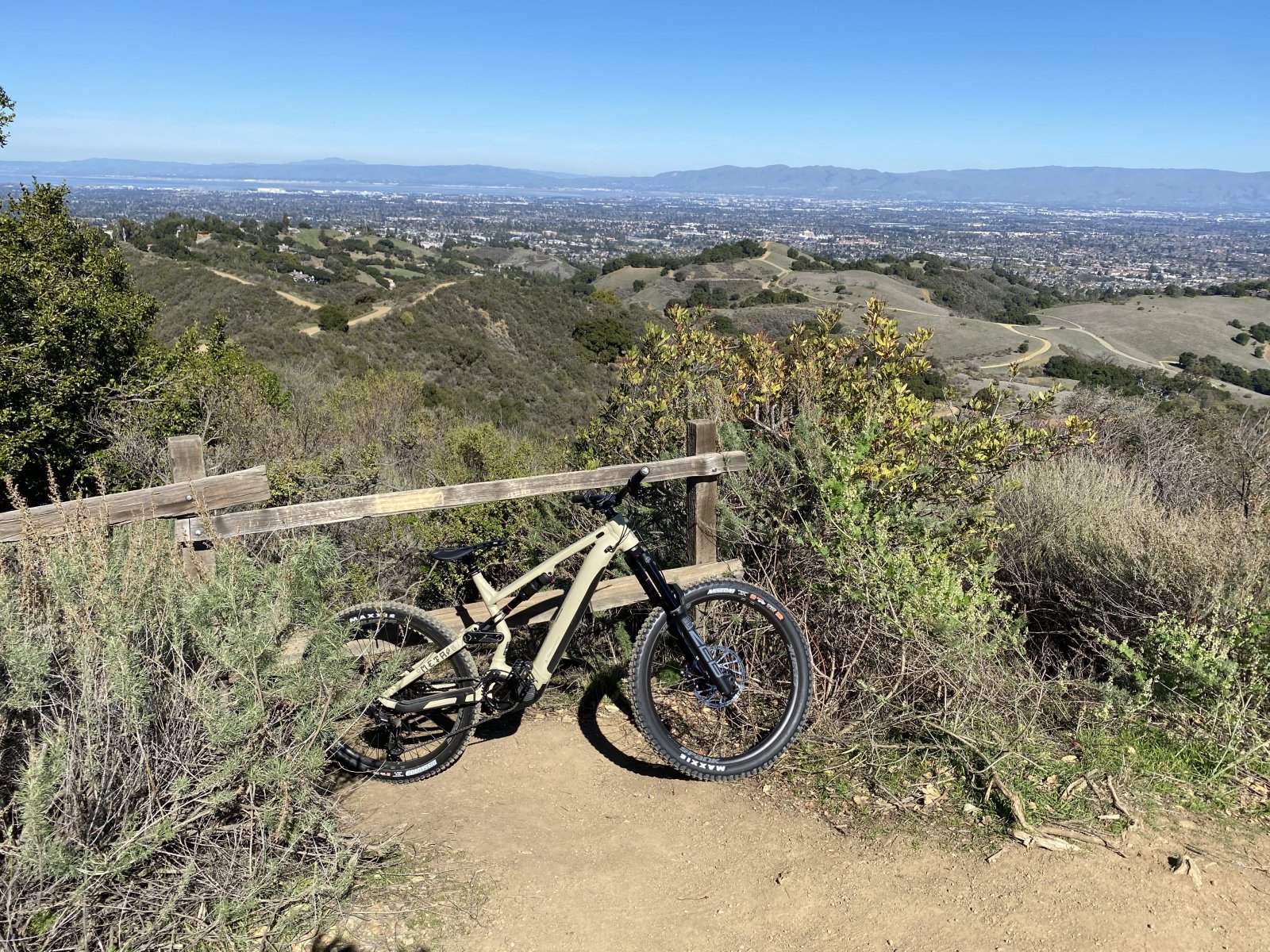

Got my bike two weeks ago just got it out yesterday. Had to wait for the ride wrap to get here and to be installed. I love how it handles still having some issues getting my shock setup right, the fork feels sticky need to look into it maybe just needs to break in. I have a coil coming this week can't wait to see how it does on the steep stuff. Congrats on the bike!!
View attachment 53921 View attachment 53922 View attachment 53923 View attachment 53924 View attachment 53925
View attachment 53930 View attachment 53931
Hey Stiggy, is that the top of the switchback in NP?
I’m in Cam, how do we connect so we can go shred together?

Hey S
Just got my Meta yesterday.
That's actually Cupertino/Saratoga, its at the top of Fremont Older. Just one of the local trails where I can get a quick ride, that is until they start cracking down on EMTB but when I go no one is really around.
Nice place to ride.
If you ever come down to VTA County let me know.
Have fun with the bike!
