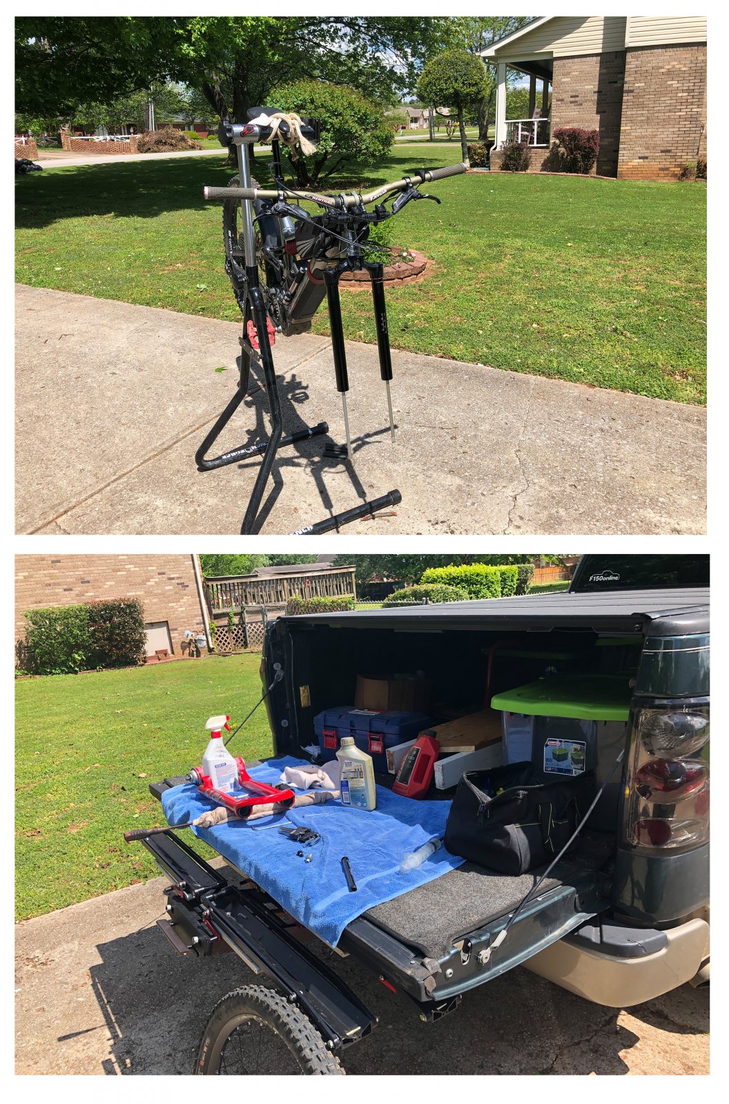

Yeah, seems like it took RockShox about 5 years to figure this one out. I remember all the people saying "Oh, the transfer port is plugged with grease...that's what causes it". You took your fork apart, and that's what fixed it temporarily, you let the excess negative pressure escape.
You're like "I guess the transfer port was plugged...it seems OK now".
Then a few hours of use later, it's right back to "suck-down" mode.
Remember the zip tie trick?
I'm so glad they finally figured this out.
