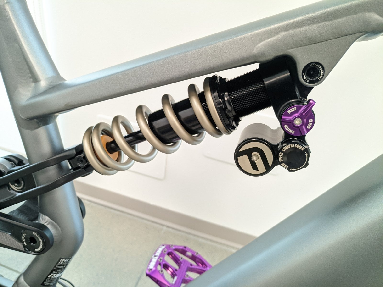

This fast suspension work perfectly
This fast suspension work perfectlyView attachment 53347
That's a pretty shock, just bought myself a MRP Hazzard off pinkbike. Never say never was fully against coil but found a deal on a MRP with their new SS shaft and they said there would be no issues with the yoke or weight of the e-bike so giving it a try.
