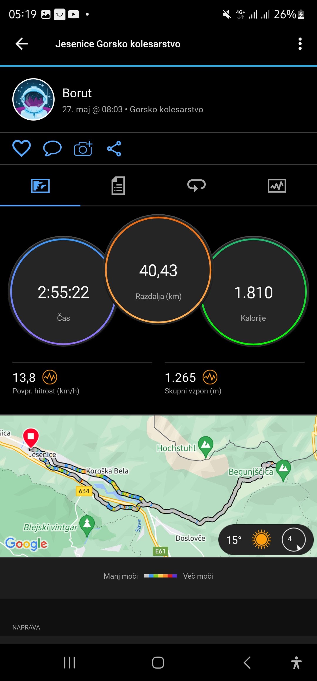

I confirm. This engine is perfect for those who want to get tired. I see you live in the Alps. I have a question: what are your battery ranges up (I know it depends on the level of support, but how much on average?)
Hello Pean,
for example yestrday i did 1200m elevation and 40km, when i end i had 52% of battery left, i have bike for exercise and to reach places where otherwise i couldnt reach.
I love lumen now, only thing where still needs to be improved is rider power input, thats shown 20% less then acctualy is, new motor is dead silent also when used in highest mode, yestrday one man in moutains said "look this man how quick he goes, and no electric bike 🤣🤣🤣"

Hello Borut,
Thanks for showing the data. These are very good battery results. I also use the Lumen for very steep climbs. I normally drive without assistance.😁

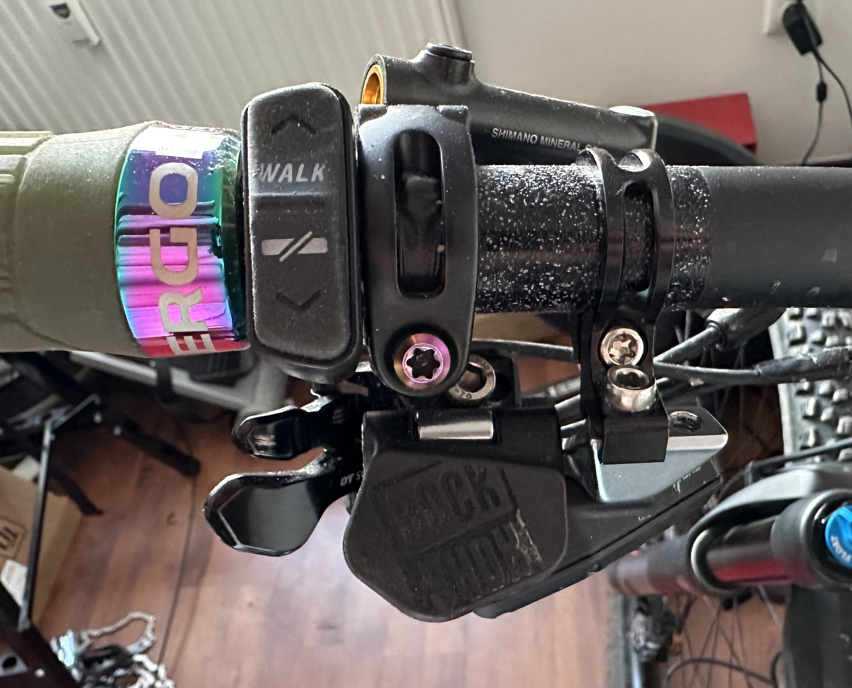

It is. Just myb u somehow limited with upgrades, regarding forks or damper because of twin lock....but i like twin lock...
Why limited, you can upgrade almost anything, I changed twinlock for DT Swiss remote 2 levers only as I installed AXS dropper and all works like a charm
Regarding fork, going to replace Rythm with 34 Factory. was a non remote one, but Fox service center has parts to rebuild it to remote. Although the Rythm one also works very nicely.
Yes it does, but you get used to it 😀, if you want AXS dropper you do not have many choices 😂. Either the big axs remote (as I have now) or new axs pod, which is smaller, but was not really ergonomically better.
Ergonomically it fits my needs and fingers 100%.
And the DT swiss remote is a little bit better in terms of switching as it has click like feel, alsmost never you mis-unlock fully like it used to be with twinlock.
