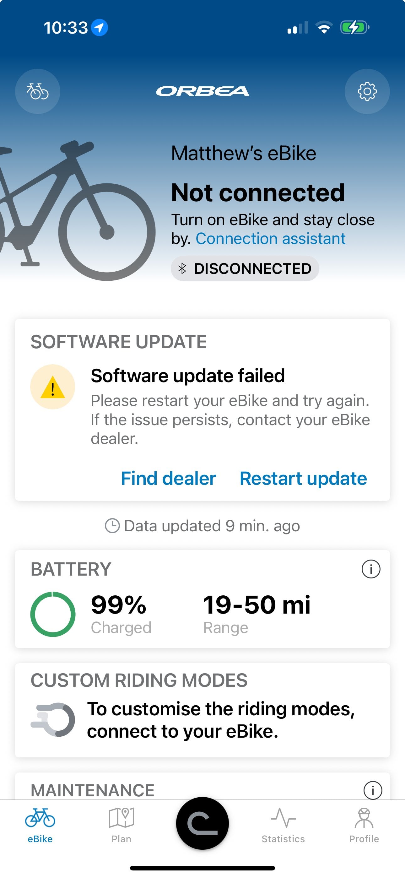

Anyone else in the US trying to update but can't? Everything seems to be working fine. The final step is that it turns itself off and upon turning on it should complete the update but when I turn it back on I get a "Software update failed" message. I have removed my bike from the app and unlinked it from my phone then restarted my phone and the bike and re-paired everything as the Bosch website says if an update fails but no luck. Anyone have any insight?

I’m having the same issue, updates haven’t been a problem in the past. Let me know if you find a fix
I’m in the UK, but every Bosch update I’ve tried to install (except the latest!) had the same issue. My solution was to give up, try again tomorrow, and eventually it would install? Having a good internet connection seemed to improve things, but may be just coincidence??
Same issue here. I'm on an Android phone. tried dozens of times, reinstalled, and used different internet connections, but so far, no luck!
I finally got the 750/100 install on the first try using a buddy's much faster than mine internet connection.
it sounds like the update got corrupted. There are 2 comms protocols being used. Firstly wifi to transmit the update to Flow on your phone....then blutooth from Flow to the bikes controller. Wifi is generally pretty reliable in terms of transmitting a large file..................blutooth is pretty poor ( no professional network uses blutooth!).
To increase your chances of success firstly make sure when you try to do the update to be as close to your wifi hub as possible. Second stay close to the bike when doing the update and well away from any other device that uses the same frequency band as blutooth....that includes items like baby alarms, video doorbells etc. Blutooth is prone to interference from other devices using the same frequency band......and there are lot of them!! If you have a well insulated house bring the bike indoors and do the update there.............modern insulation with foil helps to create the house as a type of Faraday Box!!
Took my Regulator in to the shop on Friday, the first update no issues but the second would not install. I closed the Bosh app on our update computer, restarted it and lo and behold the second update went through!

Had a similar experience to this. My Gen4(smart) didn't want to update no matter what I did at home -- frustrating. Went for a ride and for kicks took a look at the flow app update status when I paused from my ride to take a break and the update went ahead and finished. Must be some interference in or around my home that causes problems b/c the first update after I got the bike always failed as well (that time I took it to a LBS to sort out). Would be nice if there was better diagnostic info so I could determine what the hiccup is.
