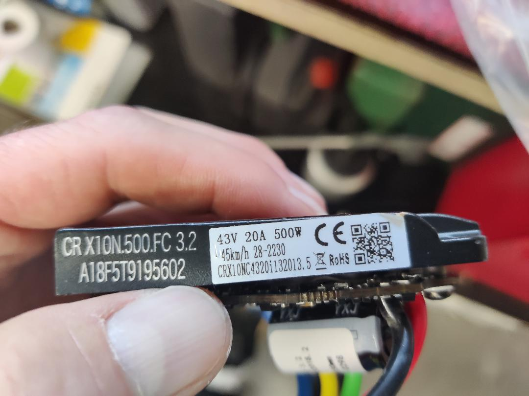

Hello , just put out my info on the range for M600 ....I drive another controller 43V 20A from FLX (=battery 48Volt 840wh).
I can reach about 85km on 1 battery and about 600hm in totall (mostly pas2 from 5) ,there is no real mountain overhere but more like smaller hills ,country riding !

Did you get that controller for a specific reason?
Yes looking for more range but still some punch and lower consumption 😎💪...i ride with an extra battery in backpack what makes longer rides (= marathon)of 120km and more possible ....

I am curious, how is the PAS and torque applied with that controller Compared to the stock controller? As smooth?
Hello ,in pas 1 is for athletes and lower assistent ...(-; pas2 is the one you need ...3 is the same as pas1 original ... Torque is good as you push harder you get more power .. feel is better ,what i think and believe tobe happening on a ebike ....on a normall flat road you get even 95 km with Average speed of 29.4 kmh on 1 battery .(840wh)

I drive a 48v m600 to. Would you advise me to do the same mod?

guys, you dont need to change the controller, its enough to change firmware. Controllers are same hardaware, the difference is software.

Hello Guys ,did some testing on the PAS1 off 5 from controller above ...got 140km on a flat surface (+-300hm) .You have to work a bit harder .The big power isn't there in PAS1 but if you are getting started ,and keeping the speed at 26-28km is easy on a 90ish cadence .
