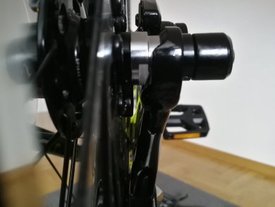

@2manytickets could you take a picture like the one I'm attaching of the I9 hub on your bike?rear end image request.jpg
So, bike upside down, taken on the non-drive side so that the camera is looking directly at the outer edge of the magnet & weld connecting the dropout and the seat stay. I'd like to see the gap and if my thingamajig might be doable for the I9 hubs.
Thanks in advance :)

I can but it won’t be until this weekend as I am working out of town. What is this thingamajig you speak of?

hope this helps
