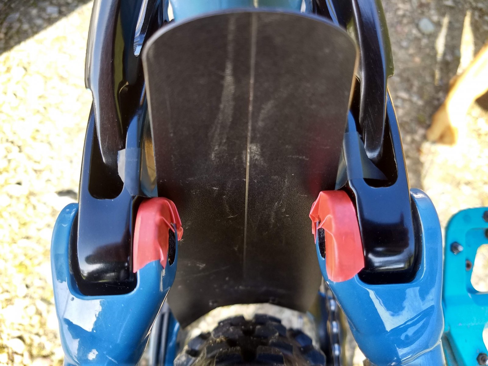

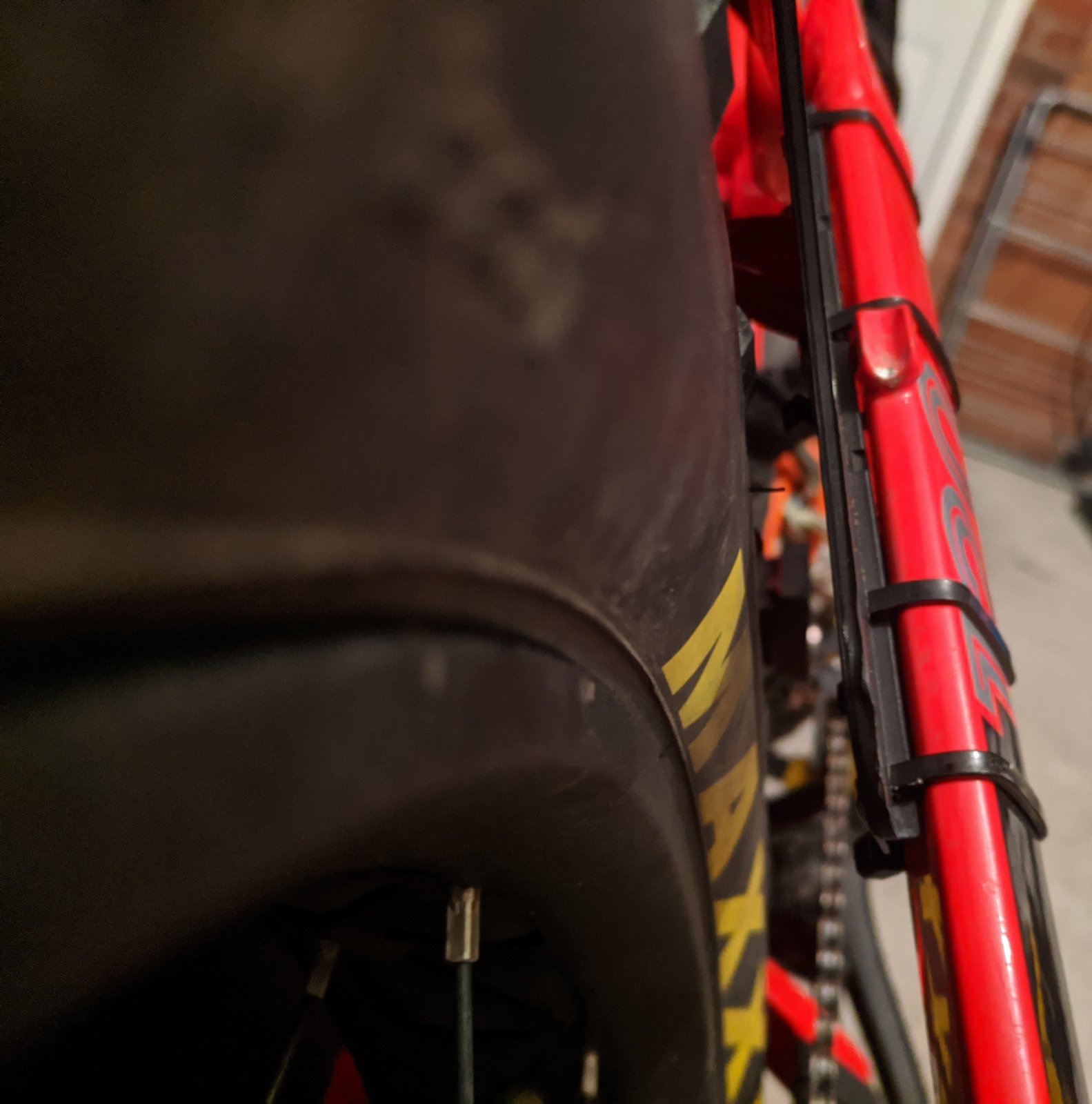

Mine seems to have a twist in from transportation. I tried repeatedly holding it the other way but it always springs back twisted. I brought it into the house last night and it straightened itself out with the extra warmth. Unfortunately, it settle back into it's twisted shape once it had cooled back down to zero. So some more manipulation is required there.
Hellitape is supplied to protect your stays. It was too cold to apply it this morning and I was short on time, so that's a job for later.

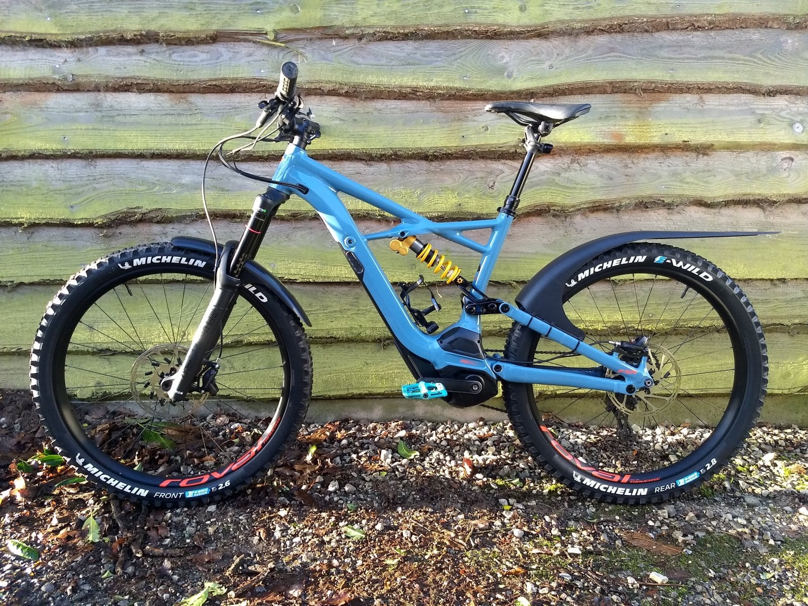

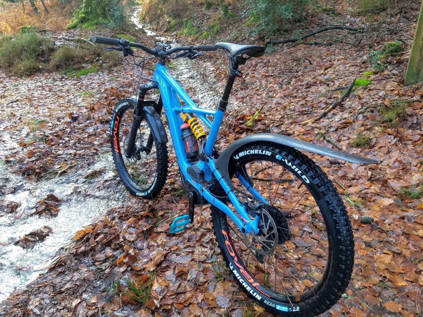

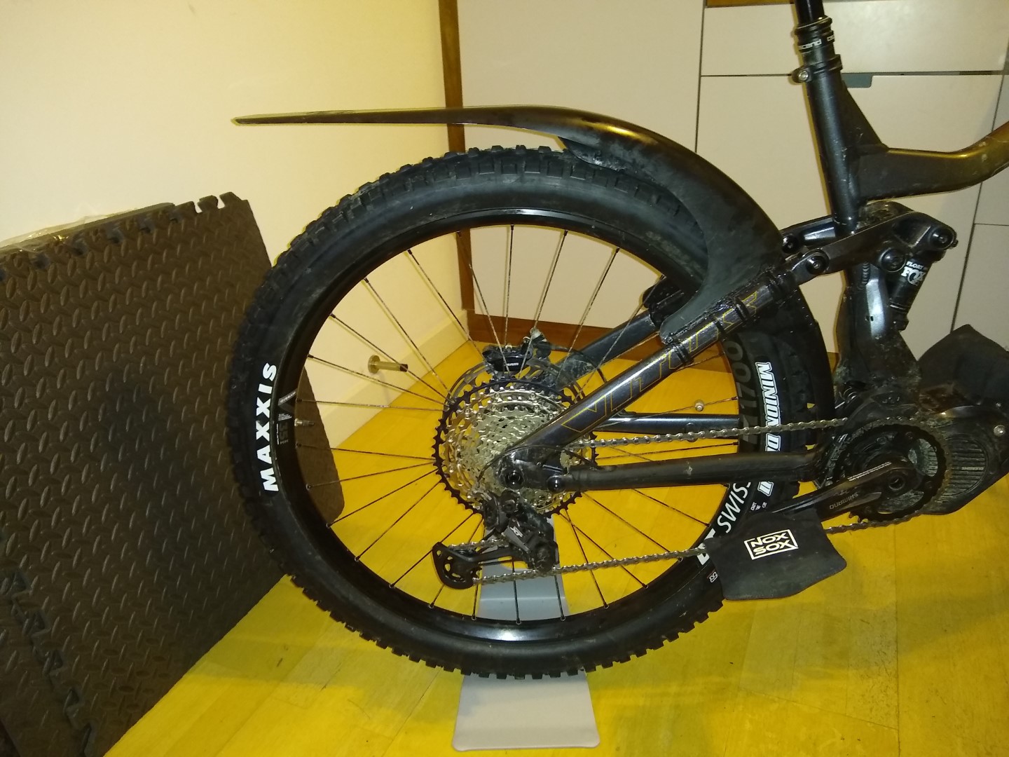

Installed :

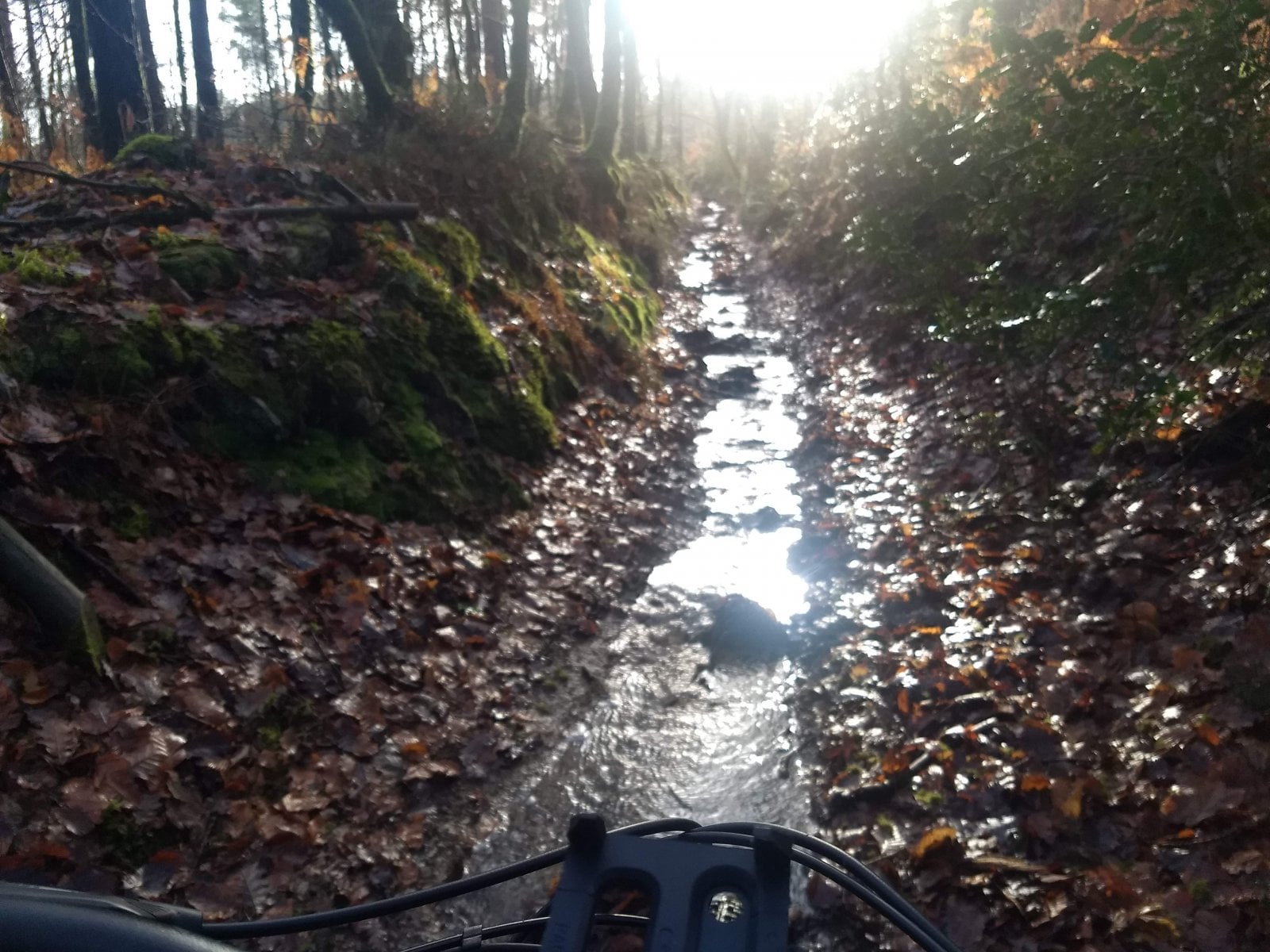

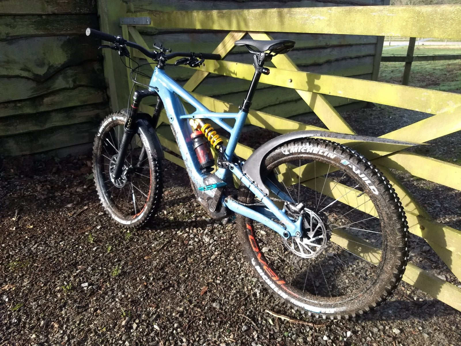

Then took it out for a quick ride in search of mud and water ..
A crap picture, but rode up here as fast as possible for 300 meters :

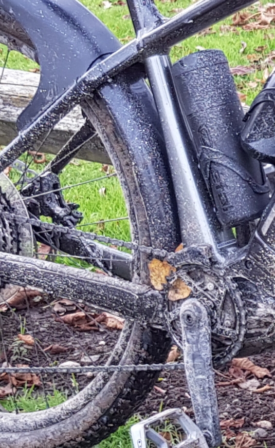

And after - hardly any forward spray and splash. Apart from the expected front splash, I was dry.

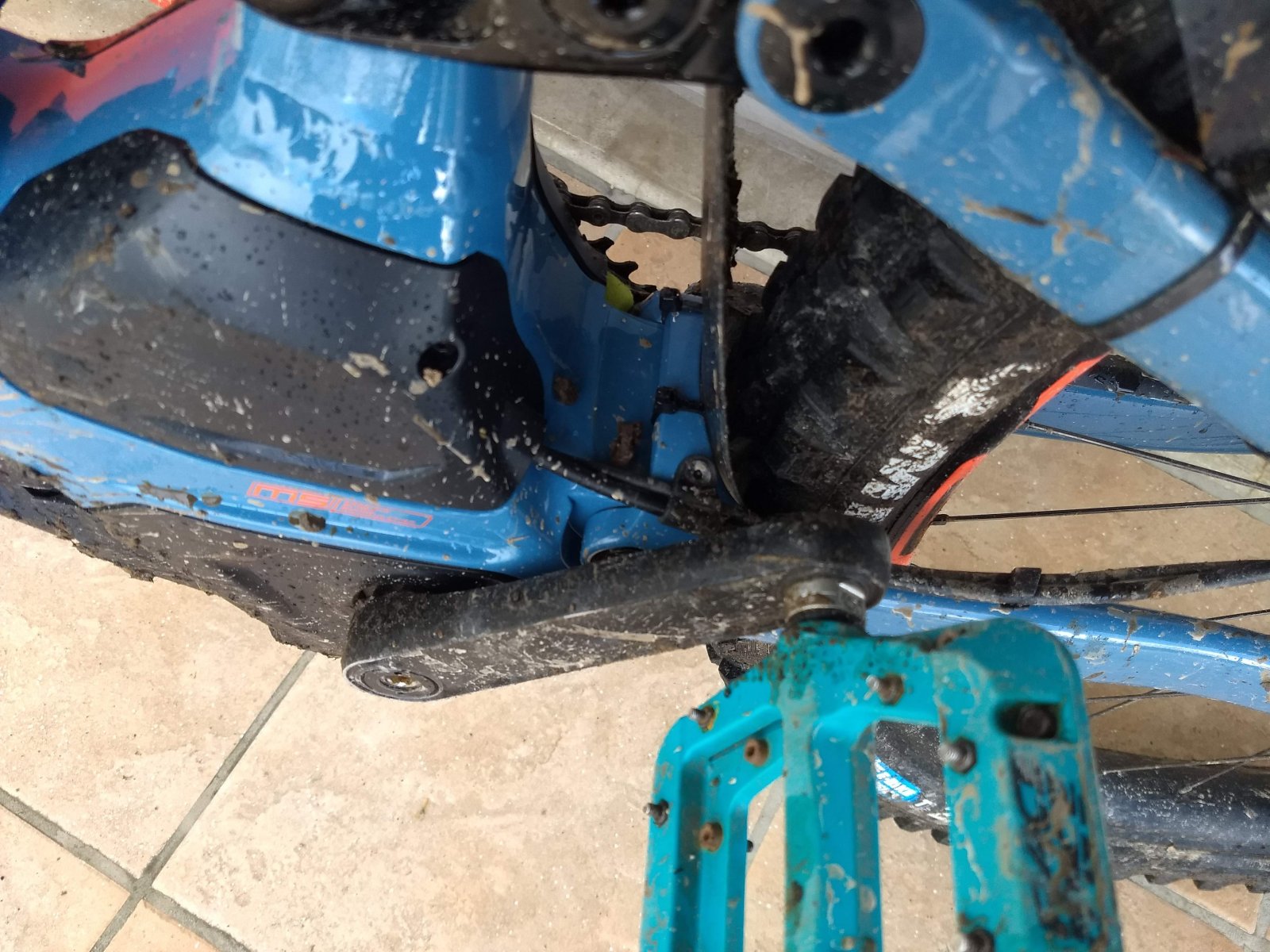

After some more mud .. good results .. Some crap is getting through to the lower linkage area, but no more than when I had the "mudhugger front" on the back. Ideally it still wants a second guard to stop that too.

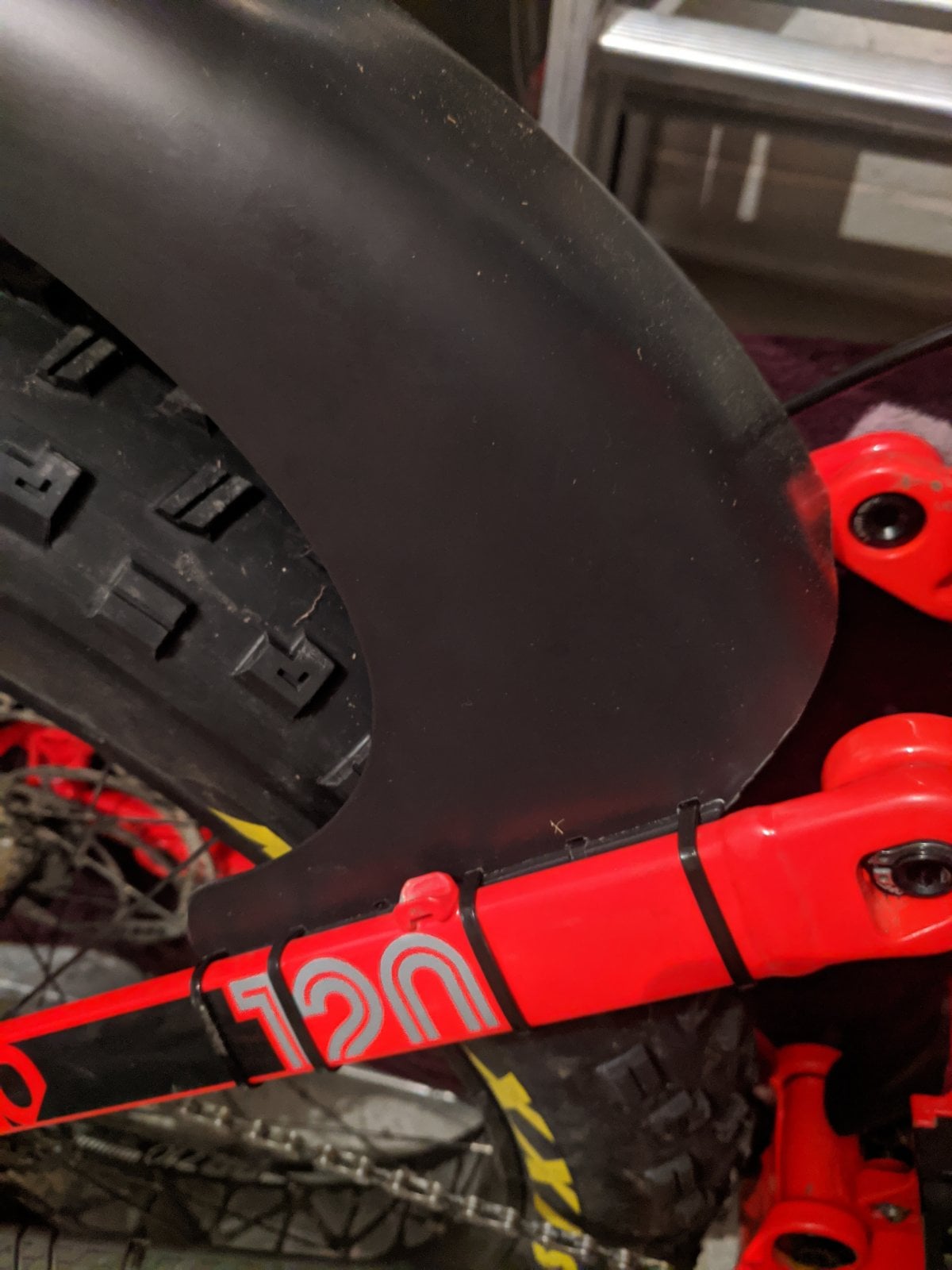

Cleaned everything and took it off to install the (supplied) helitape.
The guard had scratched the seat stays a lot just in that time, so it's imperative that you install the protection. It was about -2 this morning, so the tape was solid. Stuck it in front of the woodburner for a short time and that softened it up. Taking it back outside and then touching a cold bike quickly reversed that .. :) It was more pliable than yesterday though and managed to shape it round the stays. Then the humble hair dryer did a fantastic job of softening it enough to work the shape to fit correctly. Installed it with just 4 zip ties this time and it still feels solid.

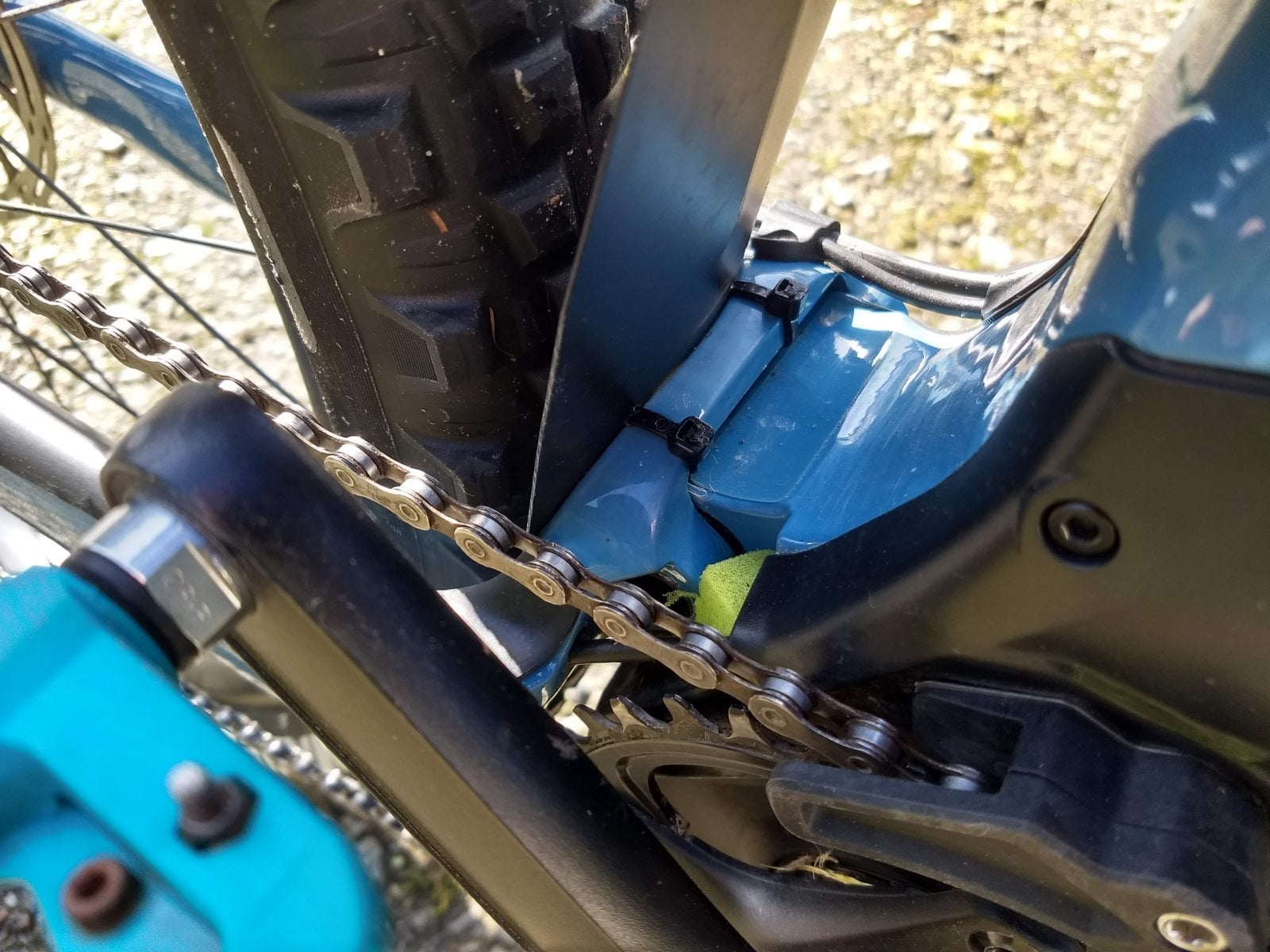

You still get junk collecting above the bottom linkage, so if you want to keep that clean, you'll need an @Will Hesch guard on a newer levo/kenevo or something else for all the other bikes. I tried various configurations with the old mudhugger front, but couldn't get anything where it would sit on the outside of the new guard and not foul the wheel by the bottom linkage.

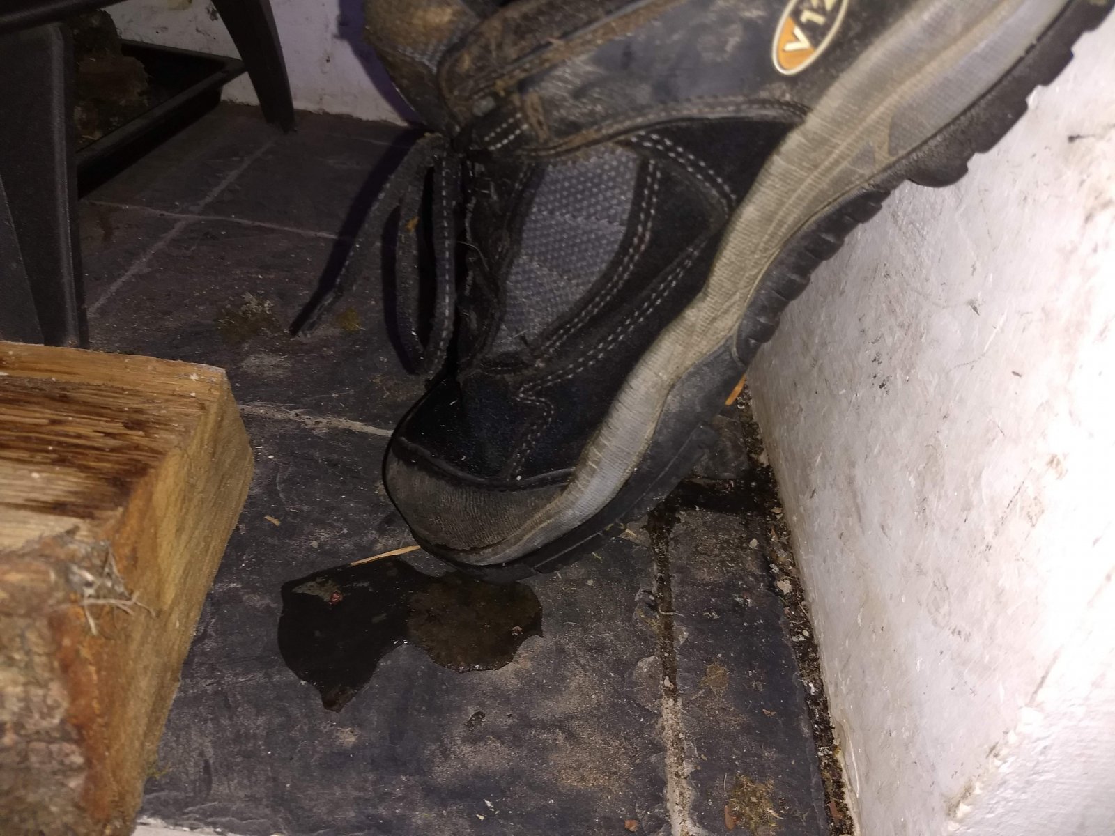

Several hours later .. my shoes were still draining .. :confused::unsure:
EDIT : With the helitape installed and the slightly tapered stays, the guard managed to slide down and loosen itself on the gnarly stuff .. it must have been pretty gnarly as my gear's unindexed themselves and the gear selector came loose .. (though the two there could be connected ! :) )
So pit stop back home and three zip ties either side have held it firm ..

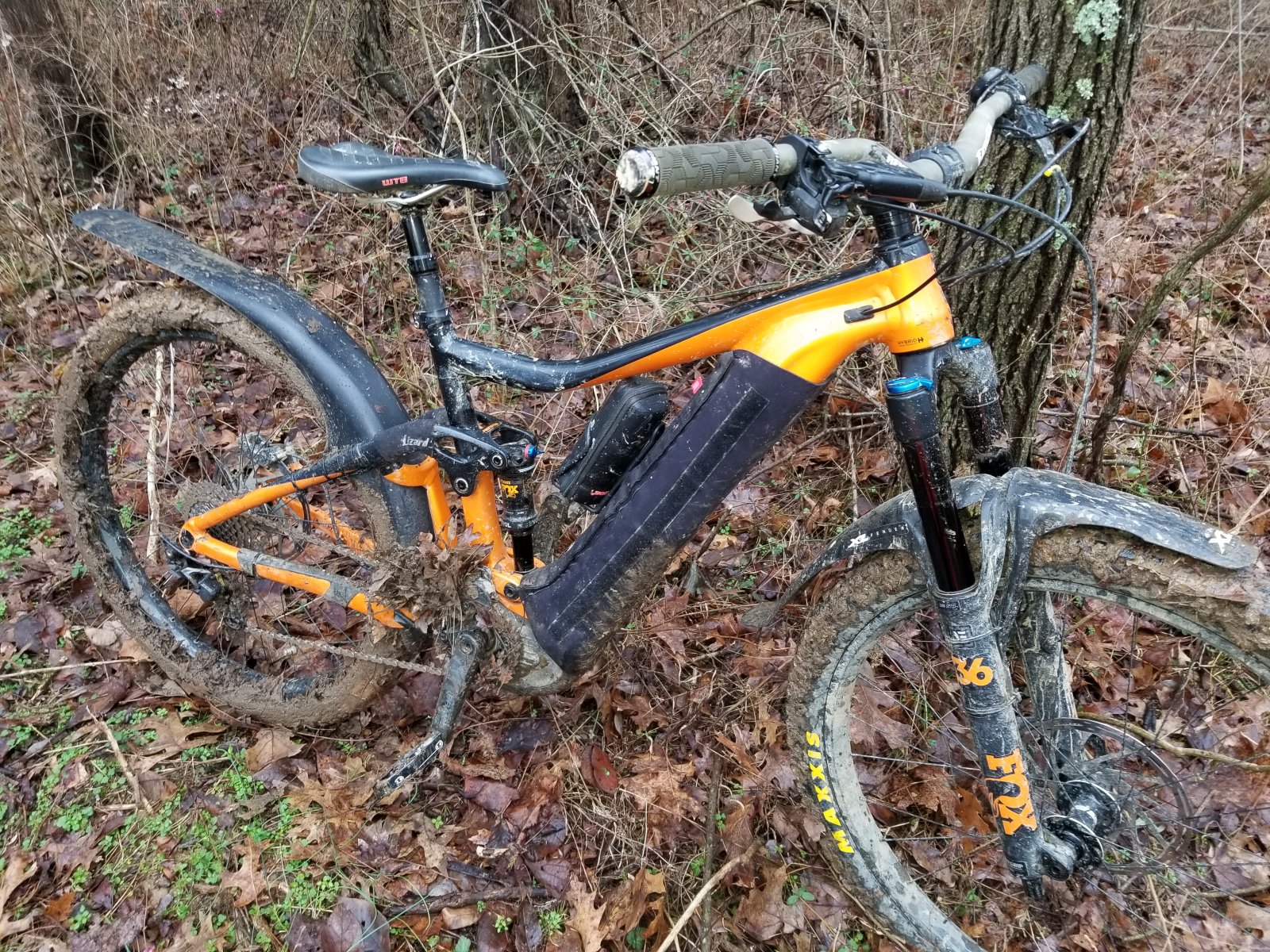

When I saw the amount of crud that was wedged into the motor cover from the rear linkage, just from 6 or 7 winter rides on a brand new bike, I can forego the loss of style caused by add-on plastic bits until Spring/Summer.
I too have left style behind. I've already posted this photo on another thread ... I think I may be working through my shame in posting it again. My beautiful bike is currently rocking this mutant monstrosity - a bodged Proguard Front Max overlaid with a Mudhugger.
I have the same bodged combo too - works great on my hardtail:

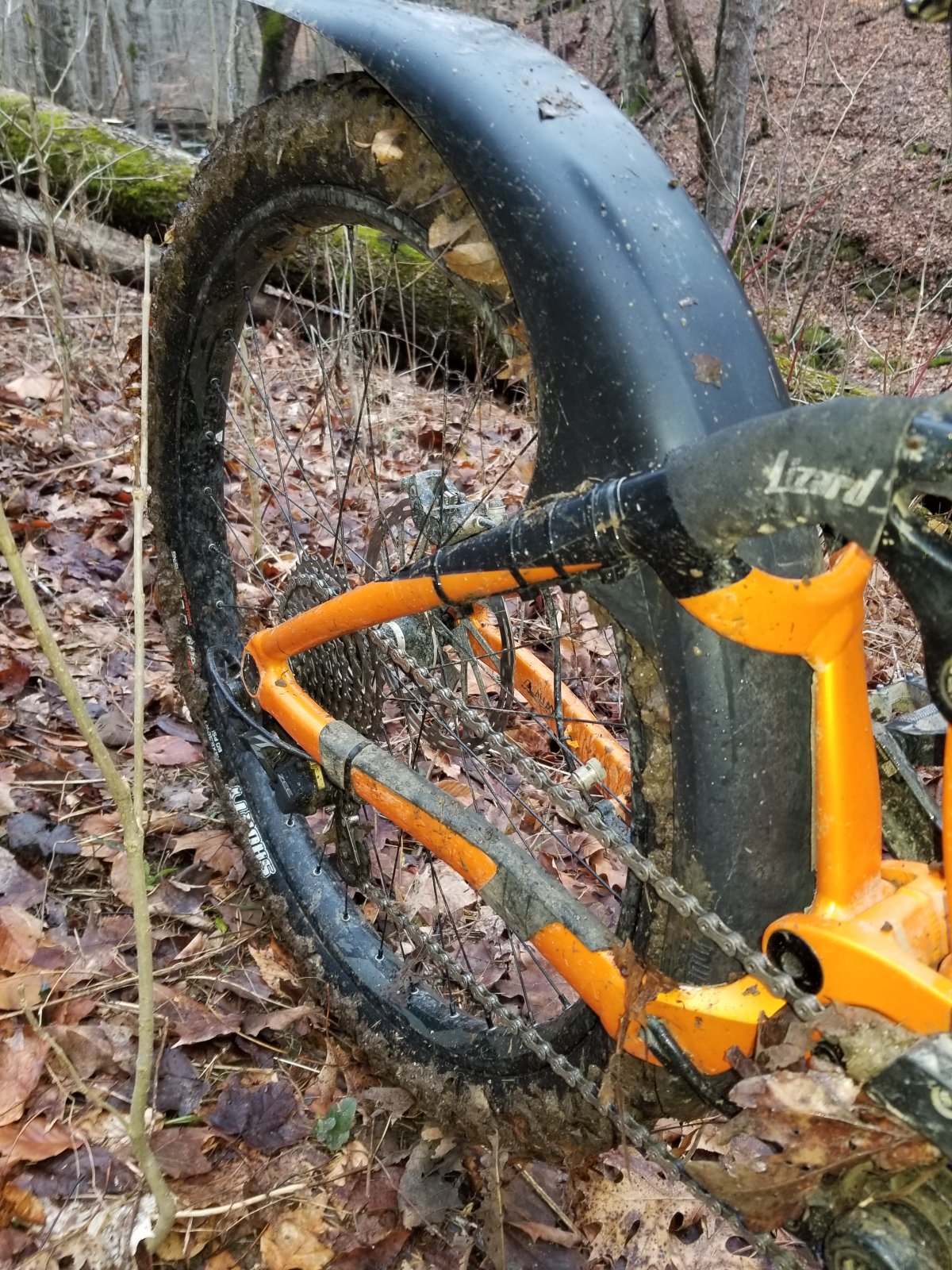

I did the same thing, at about the same time as everyone else, once it got stupid muddy.
As a college professor once told somebody else, (not me) "great minds think alike."
This make for really sturdy fender.
The only thing that's gonna stop the leaves and crap from gathering around the chain guide … is to remove the chain guide, lol, I think:unsure:(ex nihilo, nihil fit). I did just this- removing the chain guide- but started dropping chains occasionally while I do stupid stuff. Now I cant just give up doing stupid stuff, so I put the guide back on.
13,805
20,497
I did just that, but started dropping chains occassionally doing stupid stuff.
Can you not make a zip tie "loop" around the chain a few inches back from the guide - fastened to the suspension linkage or something ? So the chain runs through the loop - but not restrictively and so the "loop" can move around a bit ? Then leaves being "conveyored" along the chain are knocked off by the loop before they jam into the chain guide ?

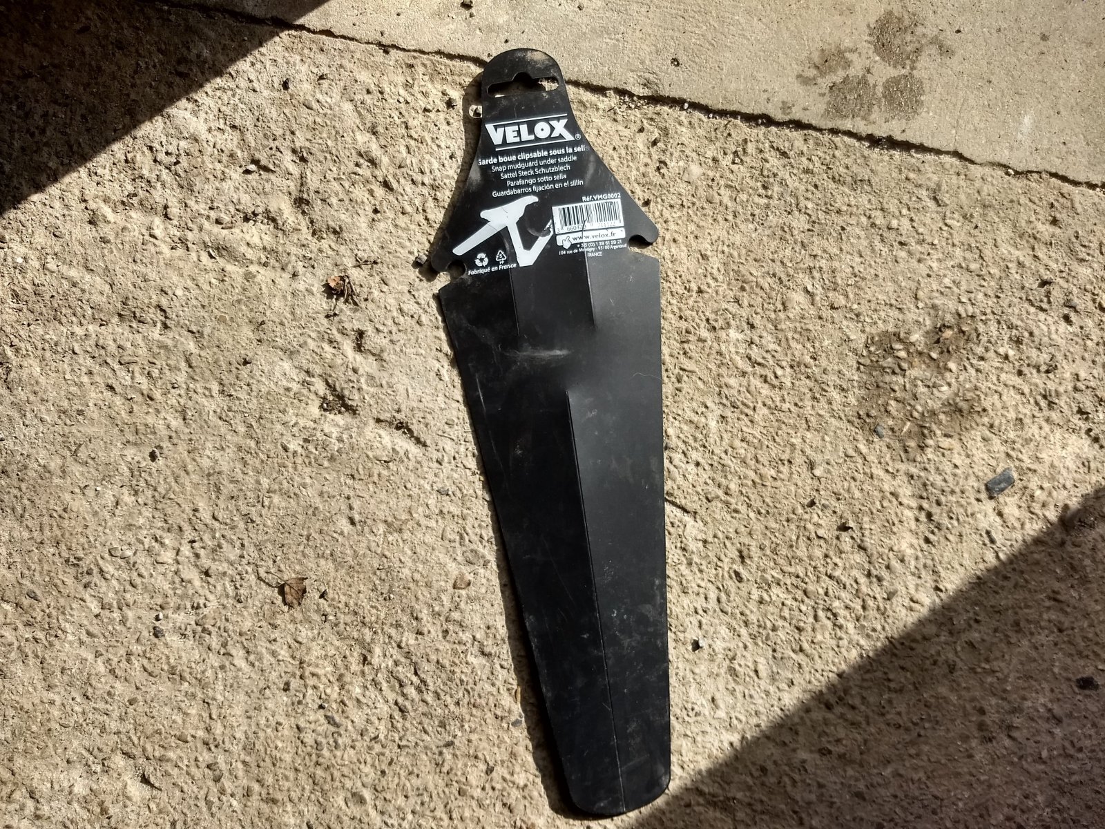

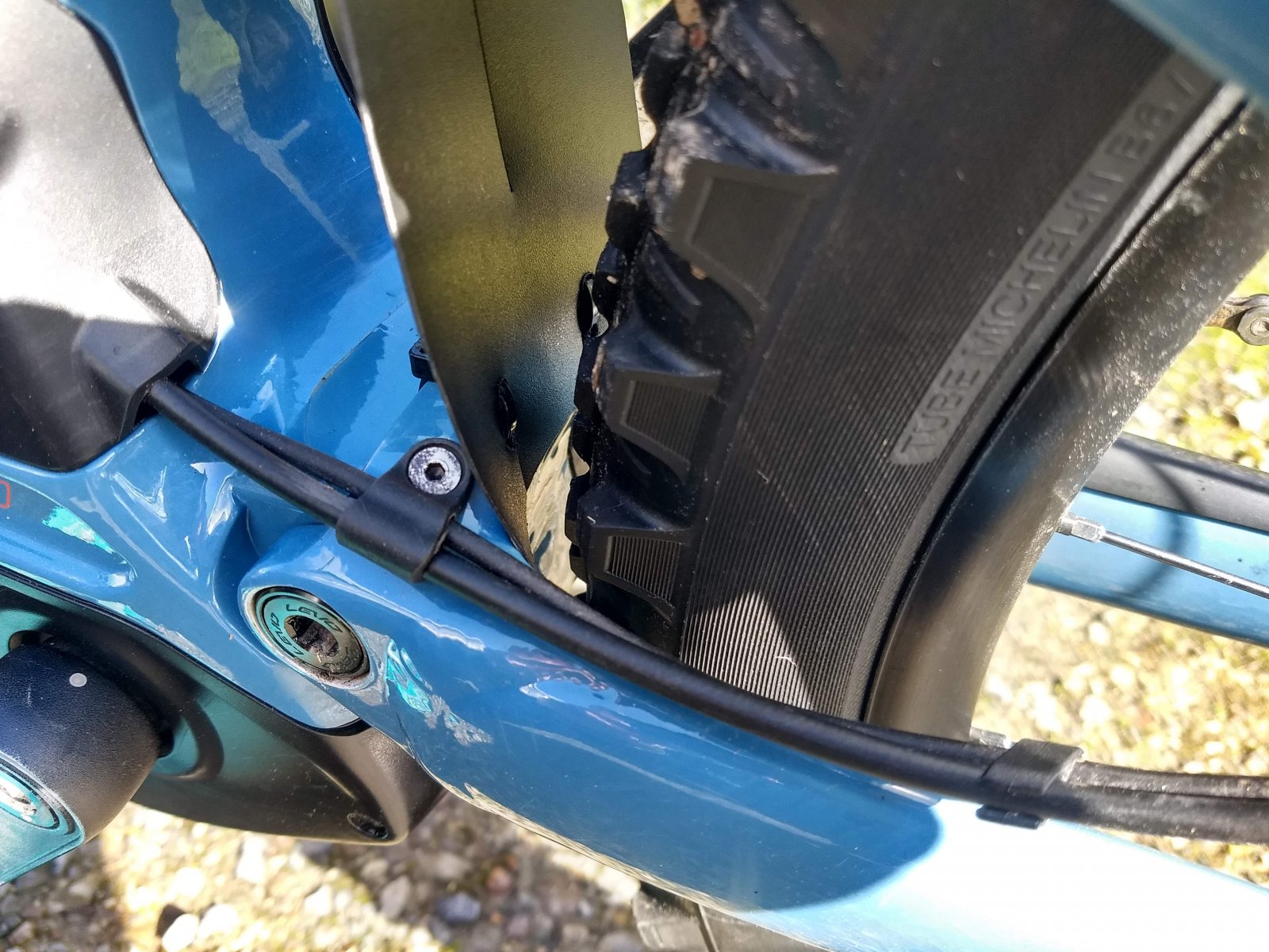

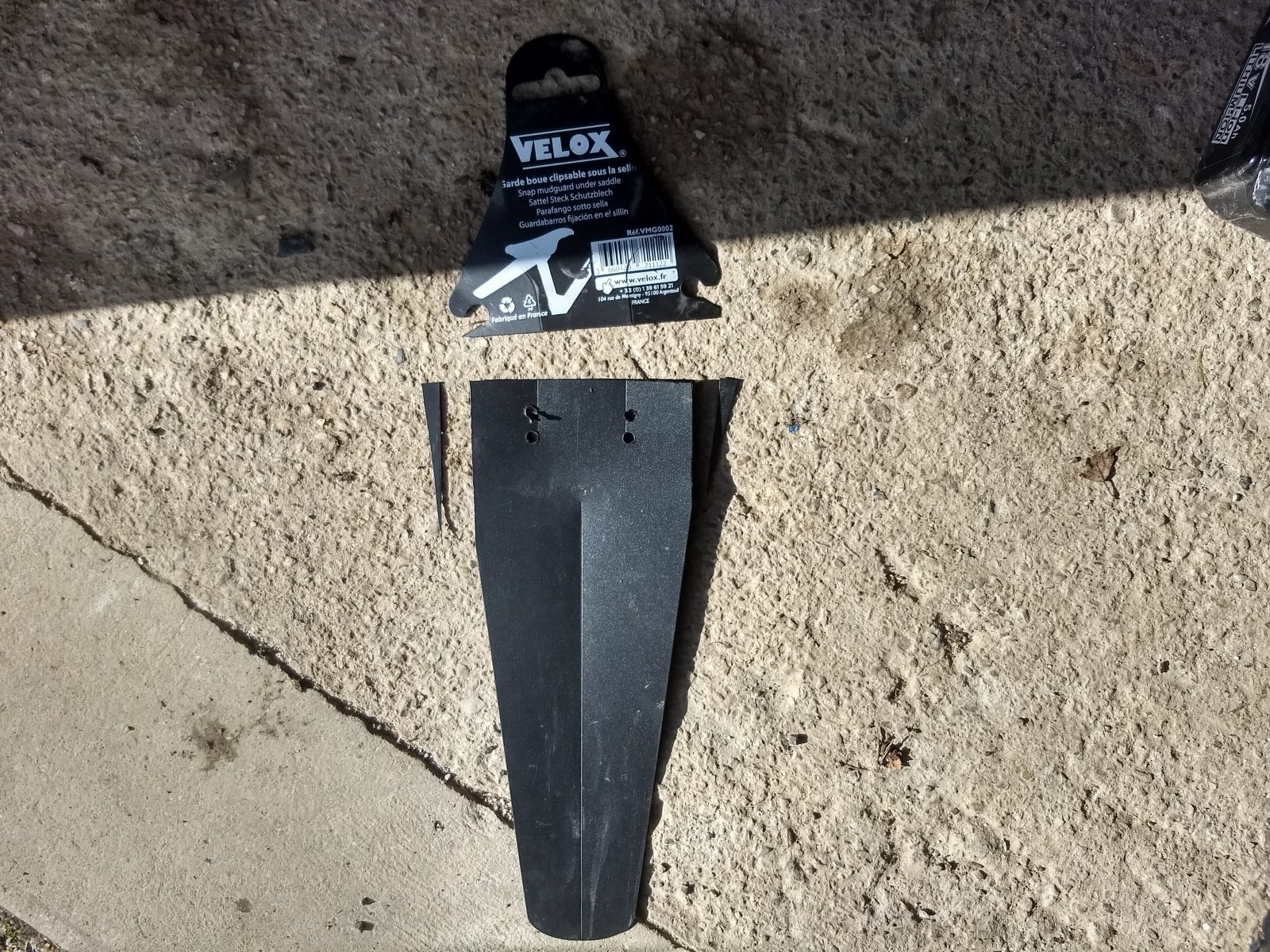

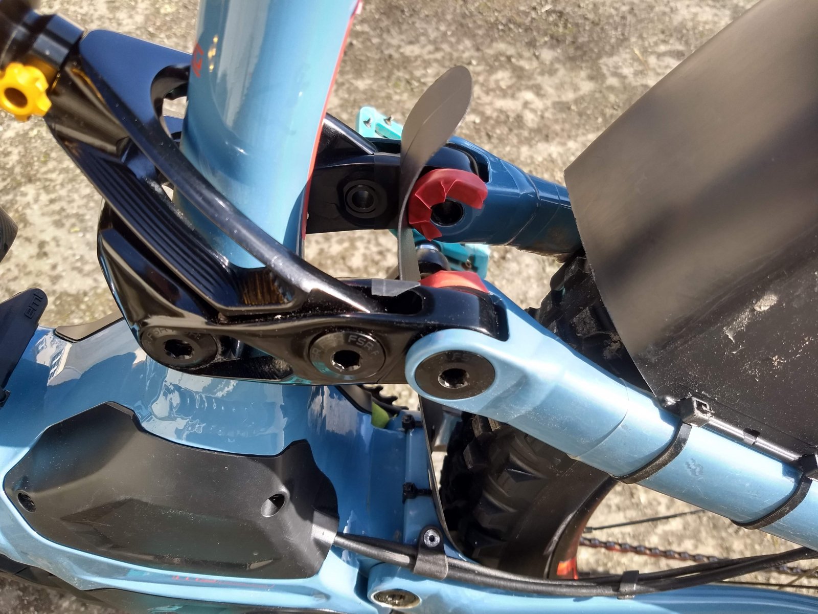

Ok .. So finally found some time to stick on a secondary "lower" mudguard to catch up the crap which the mudhugger so efficiently channels to the lower linkage/back of the motor area.
After playing around with various options which didn't seem to sit very well. I went with this for "prototype 1". Which will probably be tweaked and stay as the permanent solution.
Starting with a cheapo underseat clip on guard (this tapers, which means it fits up nicely between the upper linkage mechanism on a Kenevo):
Go all Blue Peter on it and remove the underseat clip section as that would make it too long. Trim a bit off the sides so it doesn't foul the chain/keep it symmetrical as it naturally tries to spring back into shape. Drill 4 holes. The fold lines on this one lined up perfectly with the limits for mounting zip ties, then I drilled with hole centres about 10mm apart.
Thread some zip ties through and lob it on there !
For that professional look :confused:, when testing, add some electrical tape so the plastic doesn't wear your paint off. Once you're decided where it's actually sitting, you might want to add some hellitape as the top part will move around as the suspension compresses.
I then bent the top "tongue" over, virtually back on itself, to form a curve - otherwise as the suspension compresses, the point of the tongue will jam into your seat tube. If I'd had some hellitape, I might have bent the whole thing further back so it sat behind the linkages - but it would rub the blue paint where it tapers to the linkages. I also stuck a length of electrical tape vertically on the seat tube in the "contact zone".
If you've got a 1.2/1.3 Kenevo, this is also a good time to stuff either some moto foam or a small piece of kitchen sponge in the bottom drive side linkage hole to stop crap getting into the motor housing.
After 10km's. Keep in mind that this area normally has a fist sized lump of compacted mud in here after about 2km's.
And after about 55km's :
It seems to work really well. The only problem so far is that under compression, it can move forward and catch on the next upper linkage. So it either needs bending so it stays in that forward position anyway, or trimming a couple of mm thinner at that point so it can spring back again and not get caught :

Installed :
Very good. At certain angles I wouldn’t even have spotted those mudguards.
