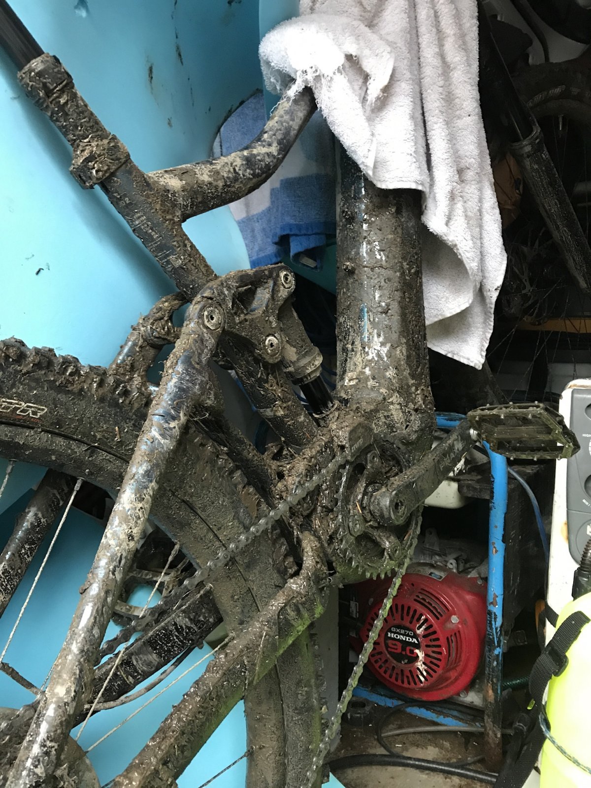

Pic of her usual home when this is all over... Just for some colour.

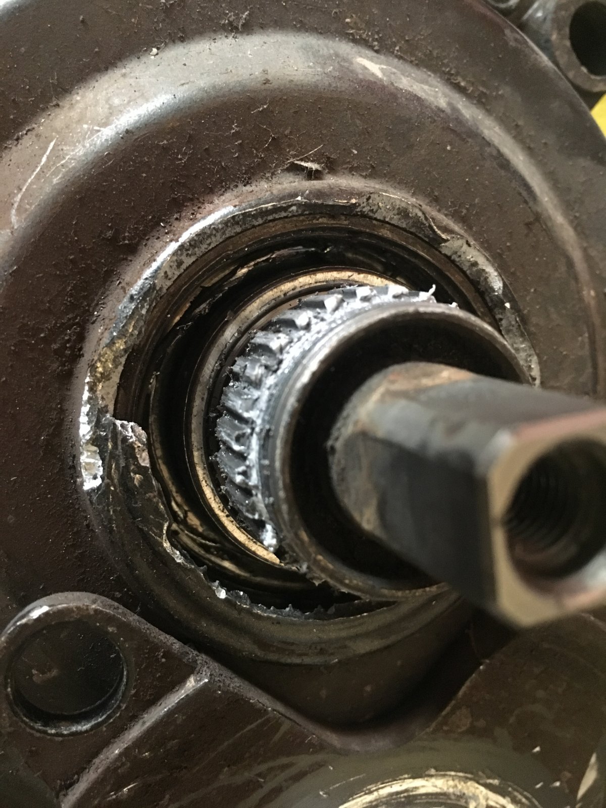

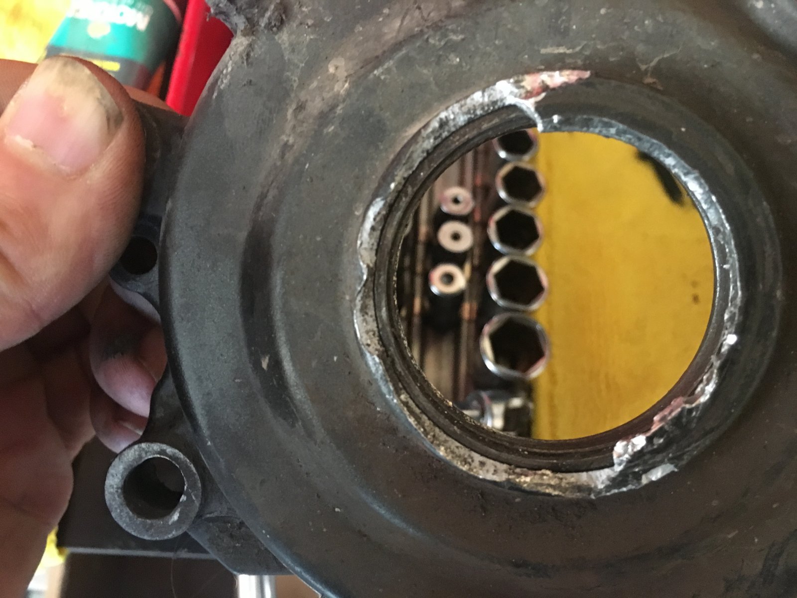

Interesting question this, I do repair a lot of courier bikes from Deliveroo riders etc. And I have seen damage on Yamaha motors where heavy pedal pressure has eventually stretched or worn the soft aluminium of the right-hand motor case around the bearing, causing the bearing to become loose.
I have also seen this in very high mileage Bosch motors when the bike is used mainly in it's eco mode.

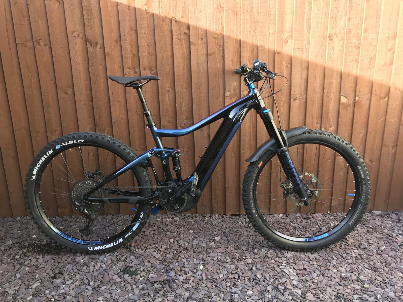

Nice shiny bike Stu.
She only looks like that now we are locked to tarmac riding here! This was her in the van, the same day I bought her. Lol.

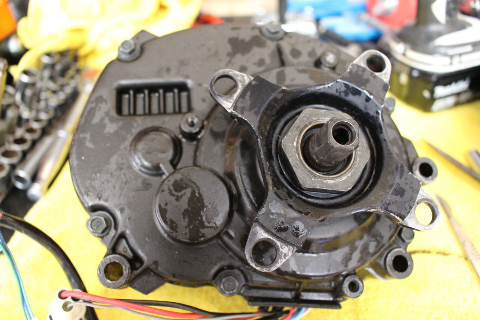

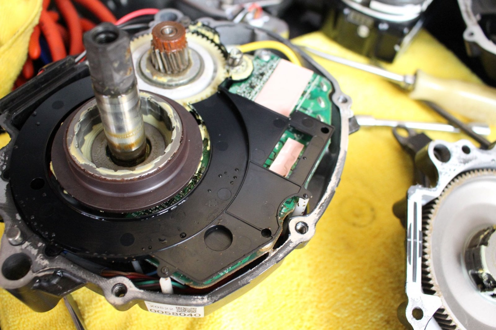

Would you like horror pictures of the insides of motors or nice shiny motors?
Yes please. Would love to see the power flow through the tranny so I can visualise what’s still wearing out whilst the motor is running passively. ???

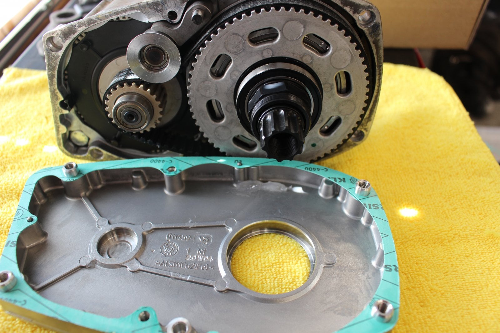

Ok, so here's a Yamaha :) When you turn the crank without assistance, you just turn the crank, the freewheel mechanism, the large steel drive gear and the gear shaft through the plastic drive gear.
When you peddle unassisted, the large steel gear is locked by the freewheel mechanism to the crankshaft so there is no wear or friction. When the large steel gear turns the gear shaft of the white plastic gear it has a clutch bearing that allows it to freewheel, so again very little wear or friction.

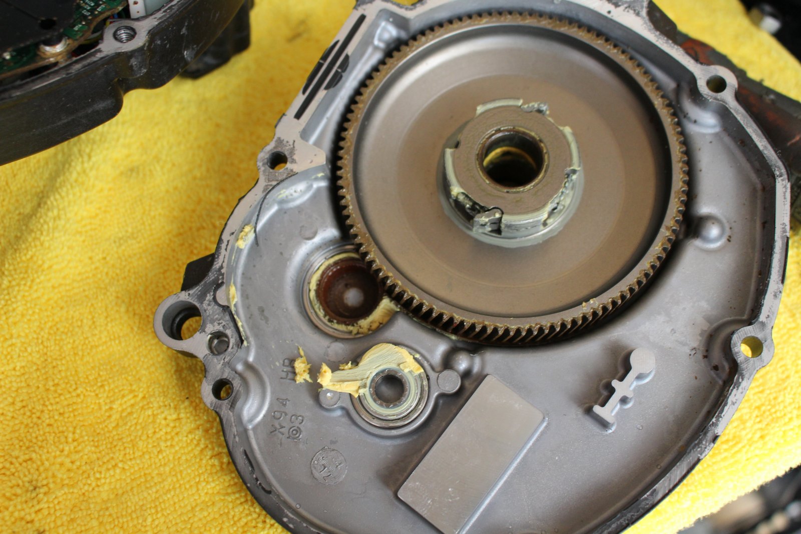

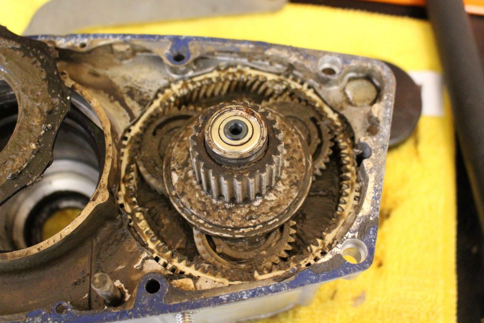

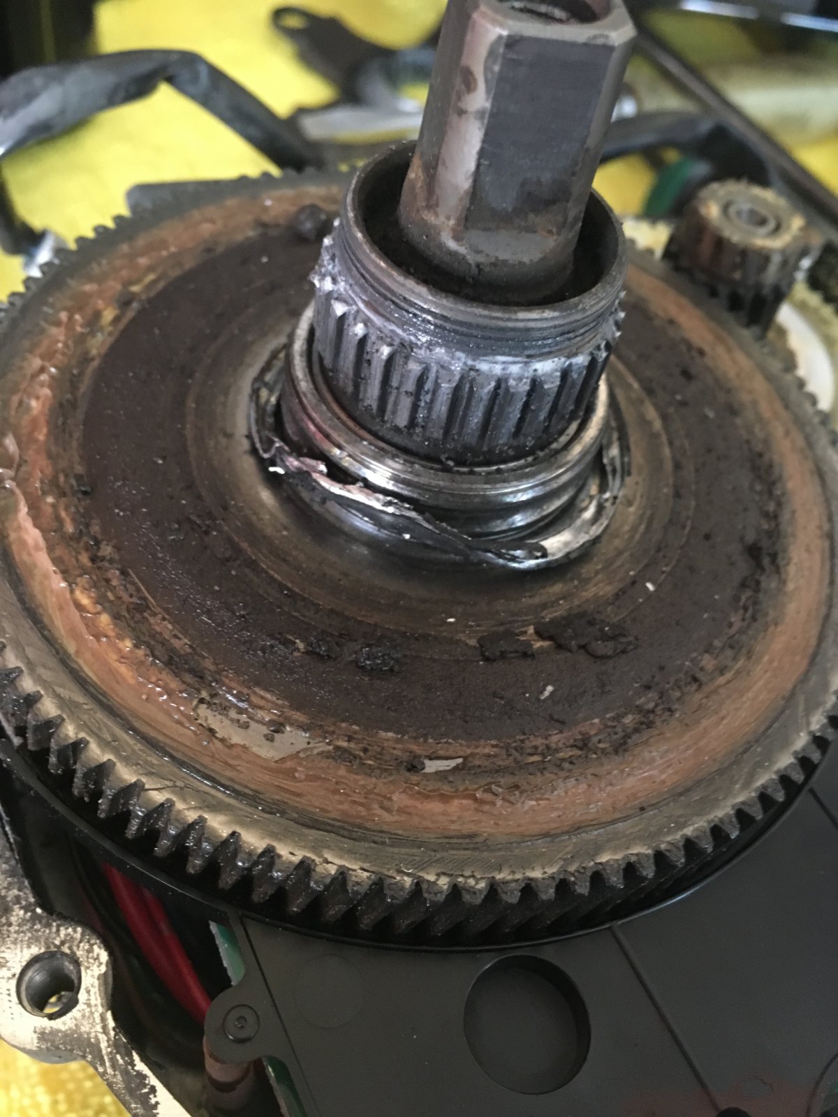

Added a couple of horror pics just to even things up.

Yamaha, Impulse and Panasonic all use bronze bush bearings on some of their components, and these really benefit from a clean and re-grease every 2,000 to 3,000 miles. There is also a ratchet and pawl freewheel mechanism that also benefits from a good clean and re-grease.
