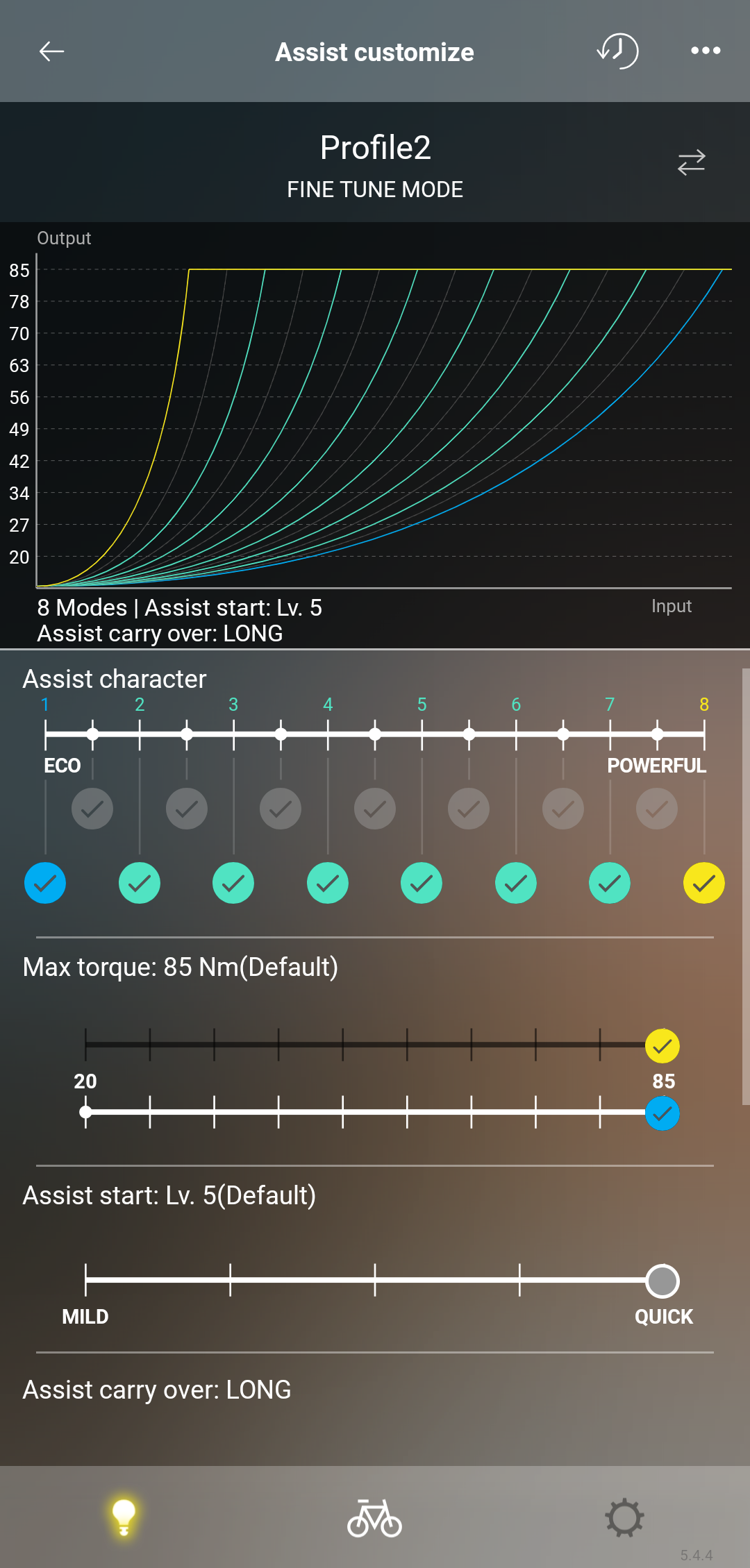

This is actually the only ebike I've ever ridden, unless you count those awful city-bike things which I tired once and hated.
I did sit on a Levo 4 and Levo SL in my LBS when I was still trying to decide on which bike I wanted, but the small battery in the SL put me off that, and the sheer tank like weight of the Levo 4 put me off that one. I still wanted an ebike that felt a little bit like a non powered bike and the Rise seemed like the best of the bunch, especially at the price I got it for.
As for the motor, I've only put 20 miles on in it with the default settings (albeit in RS Plus mode) but it felt really good. Boost felt like an actual boost and was super helpful for getting up wet, rooty climbs that I had no business being on, and Trail felt very natural, like riding with a nice tailwind. As you say, responsive without being jerky. I did find Eco to be a bit lacking though. I know it's mean to be for maximising range or saving battery but it felt like riding with the motor off. I've since set up a new profile with the Fine Tune settings but have yet to try it out due to the biblical rain.
Not sure if you can "see" this attachment, or the data within...
I'll see how I get on with that and can always tweak things further when I eventually do get a break in the weather.

@MeatBike - your Fine Tune settings look sensible by the way. Can't see the attachment numbers clearly from my end (the image embed doesn't parse for me), but the principle is sound: bumping up Eco to make it actually useful while keeping Trail natural and Boost for when you need proper shove. Let us know how it rides once the Scottish weather remembers it's supposed to occasionally stop raining. February's always grim up your way.
The EP8 RS really does shine when you dial in custom profiles - the default Eco being basically "off with extra steps" is a common complaint. Most folk end up running something like 50-60% assist on their "Eco" just to make it worthwhile.
