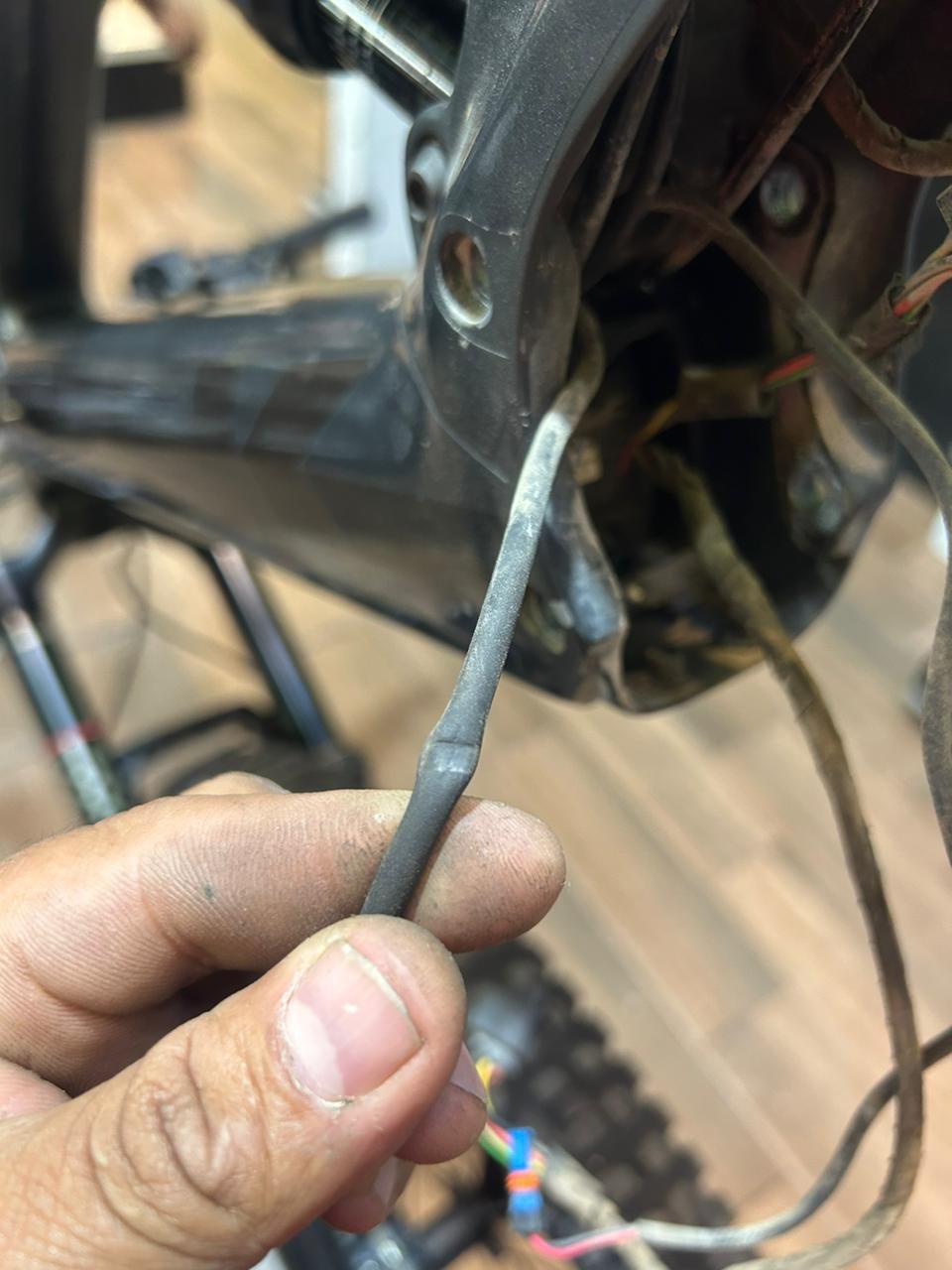

Reporting back!
After trying 3 different Kiosk displays and the bike having the same issue regardless.
The shop finally decided to actually troubleshoot the issue instead of just relaying on the Bosch diagnostics info, as the only error code it showed was display issue.
Once the took the motor off the found that the cable that goes form the motor to the sensor was pressed between the motor and the frame causing a short which caused the motor to cut off.
They replaced the cable and everything worked.

Reporting back!
I took the bike yesterday for a 40Km ride no issues.

Reporting back!
Ooh, that's not pretty!
