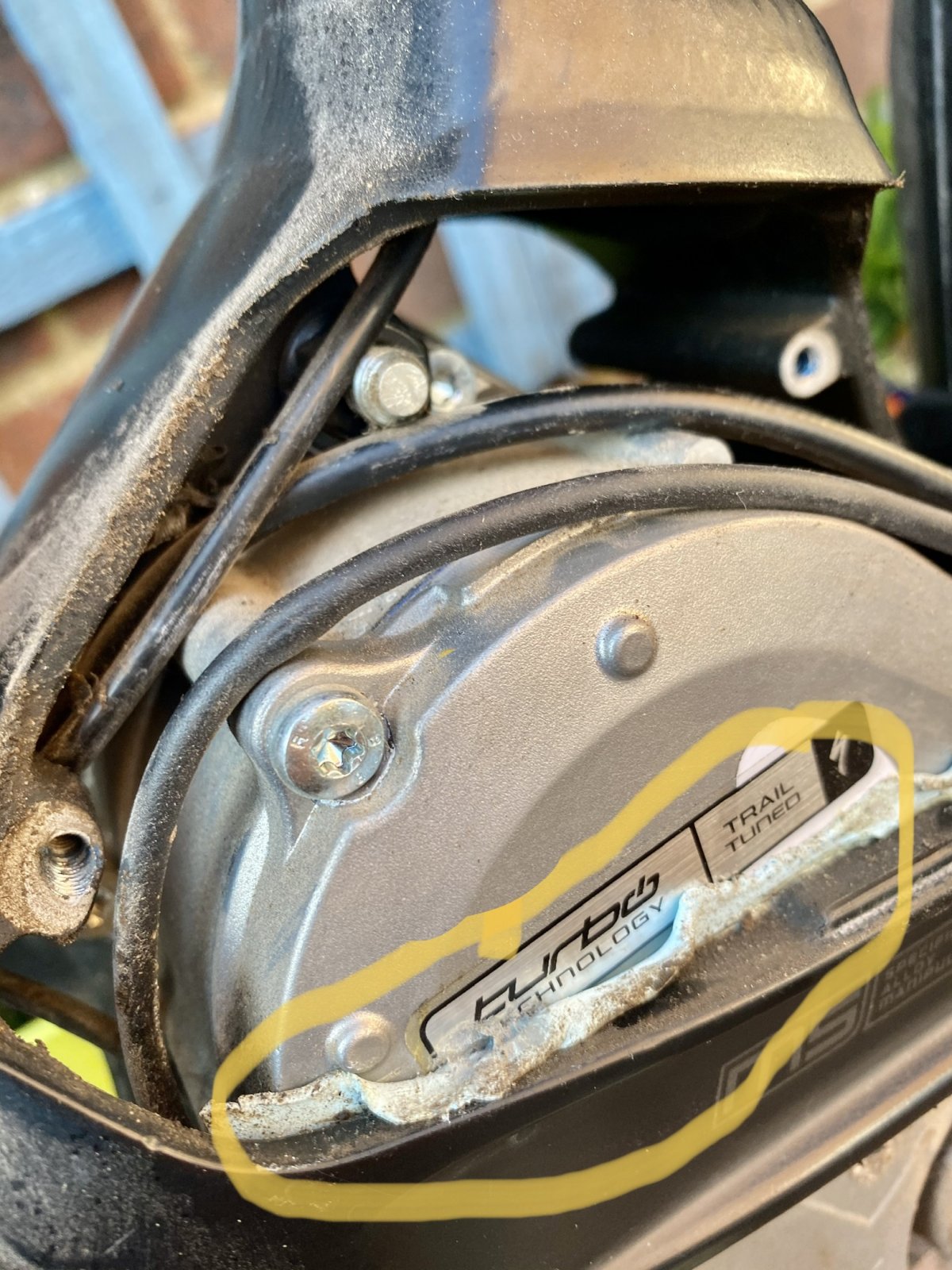

After 3 years of fun & excitement without missing a beat my Spesh turbo levo FSR 2018 motor bit the dust the other day I think the belt has gone I’ve dropped the motor out & boxed it up & on Saturday it’s off on an adventure to E-motors repairs in Cumbria for a little TLC...the reason for the post is to try & find out what the blue stuff is in my attached picture (inside the orange circle) it’s like ‘blue tack’ but softer & it seems like it’s acting as a buffer between the Levo frame & motor any ideas would be appreciated. Cyclejunkie61 thanks in advance
lt's likely exactly what you said, you could replace it with black silicone sealant when you refit the motor, which would probably form a better seal.
l stand corrected
Maybe the people who are repairing your motor could supply you with some to replace it with.
It's heat transfer paste. It helps cool the motor by transferring heat to the frame.
Absolutely DO NOT !!! replace it with silicone sealant.

You'll almost certainly find heat transfer compound on any component that's fitted with a heat sink
Seems like pretty decent design to me. You've got a large surface area of frame, can't really use airflow to move heat away from the motor, so use the frame as a heatsink. Think that's possibly a pad, rather than paste? similar in operation, just a bit less messy!
