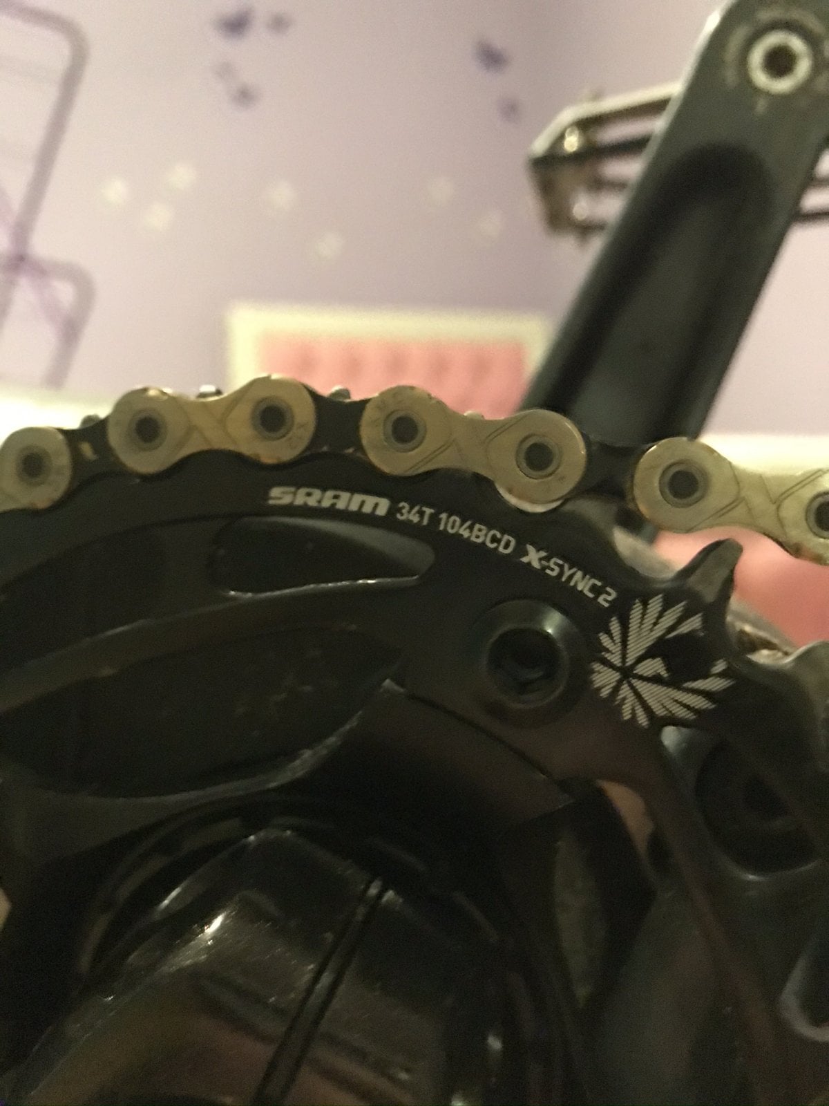

Is the below chain ring compatible with a 10 speed chain?

FFS MATE. You owe me a night out not just a beer.
Yes both are compatible

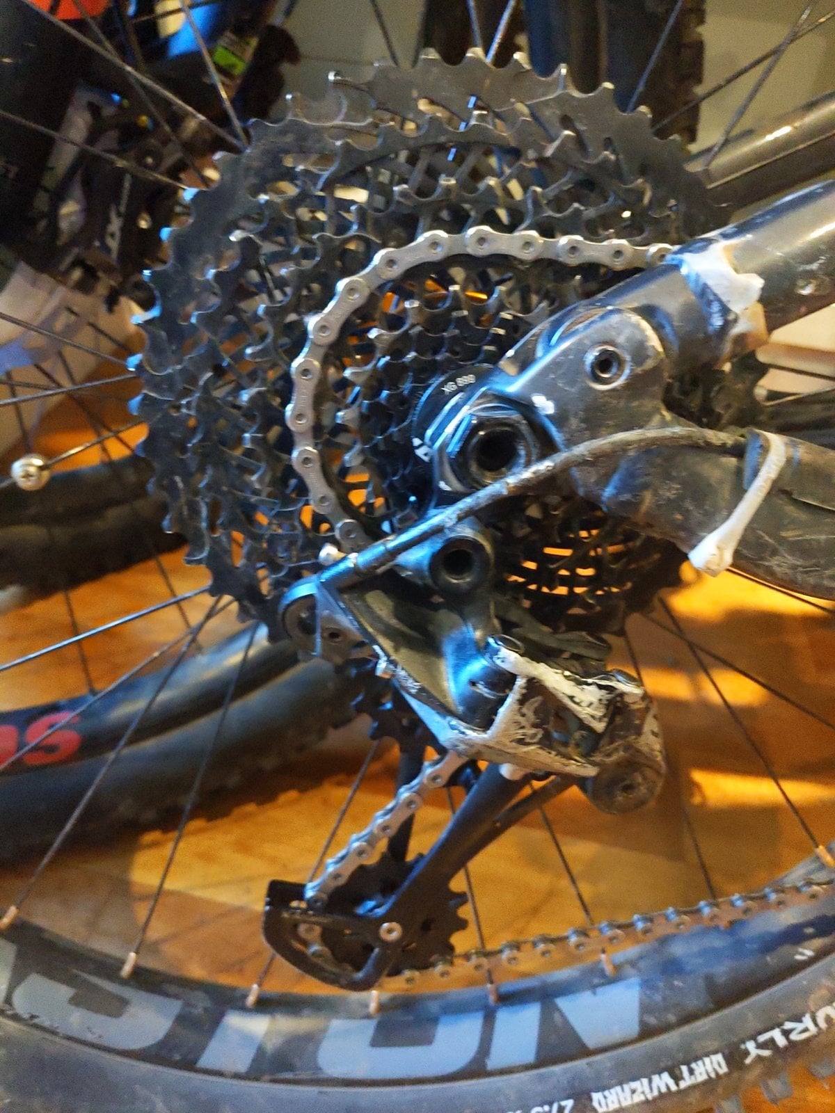

So this is probably going to be the last hurrah for my ex1 drivetrain that came with thisn2018 commencal. 2608 miles on the odometer. Second $310 ex1 cassette began skipping on the small cogs. Chain measures at 75%. New three small cogs, new ex1 made in Portugal chain,new sram jockey wheels for ex1 new race face front chain ring..if I can get another 1000 or more miles then maybe I would spring for yet a third crazy prices cassette..maybe.
1300 miles per drivetrain so far. I reexamined the original cassette and one tooth ripped off the smallest cognon the five cog cluster. The ex1 ramps are kinda interesting to examine. Very unique design. No idea how long they would work in european mud seeing most of the northern latitude precipitation seems to skip western USA and instead drop in say Gary's hood. So 1300 miles here could actually be 400 miles there. I might next grab a 10 speed steel cassette as described above and a 10nspeed shifter and see if the ex1 derailleur is compatible. My shop ( they didn't do any of the pictures repairs or sell me the parts btw , I ordered them from bikeinn) , thinks ex1 is standalone and non interchangable.
