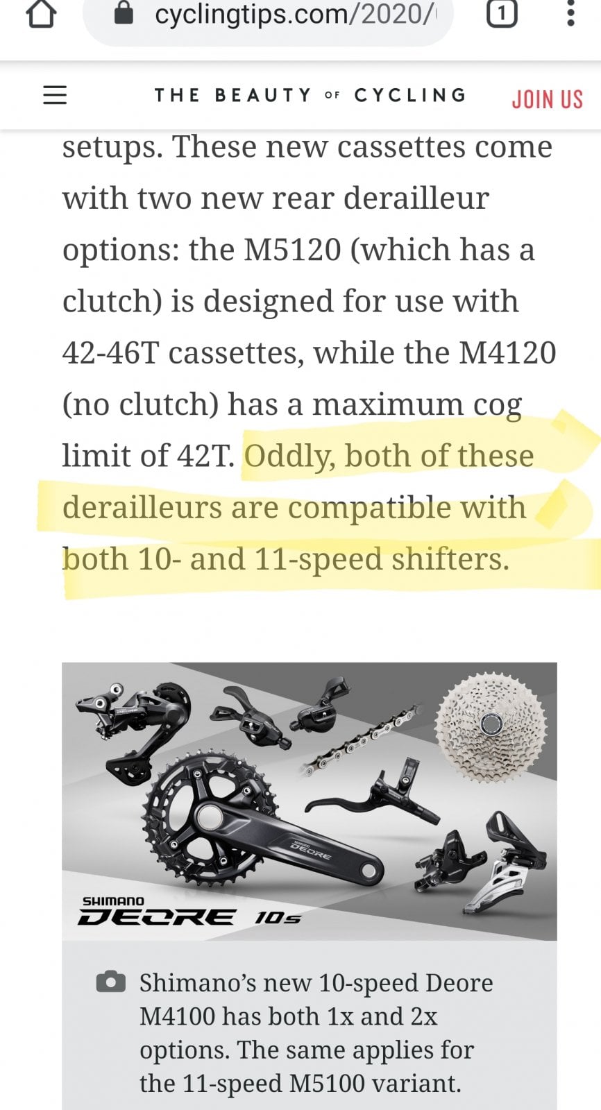

Once it is lunderstood that shimano MTB 10 through 12 speed derailleurs, work with shimano MTB 10 speed shifters, 10 speeds becomes fairly simple.
They don't!
10 speed shimano mechs and shifters have a diffferent cable pull ratio to shimano 11 and 12 speed

I've heard you say this before, but to be honest, one of the best setups I use is an 11 speed derailleur (xt medium cage) with 10 speed (xt) shifter and cassette. Go figure.
