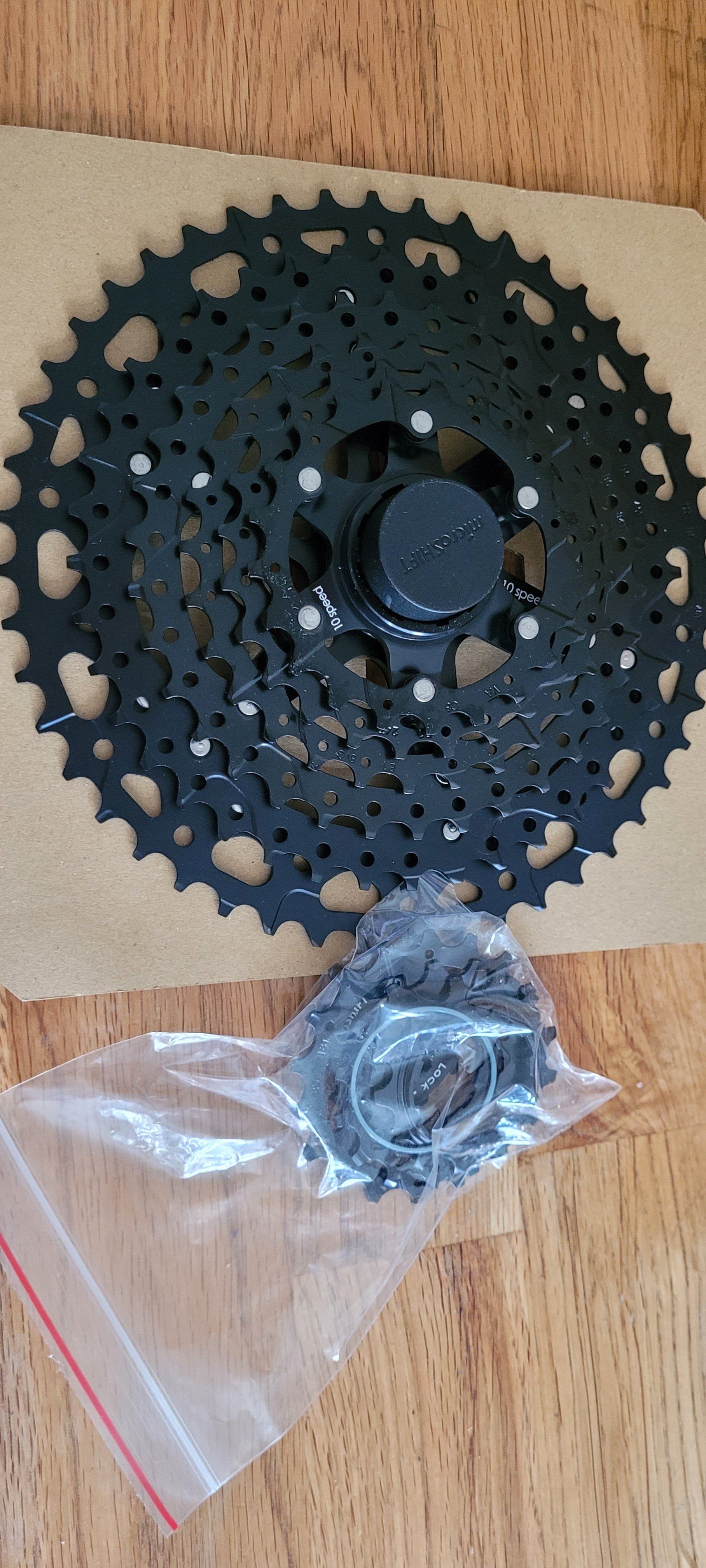

Yes. Obviously it's off now but the area where there's no rivet if I go around with my finger behind the 18t that was the issue there's two or three teeth where there's just the tiniest bit of movement.
The bike is a ex-demo that came with 20km on and ive had it just over a week. It was bought from a guy who sells ex demo Konas (he checks out as being pretty high up) and I'm down as original owner. Hence any warranty will likely be me direct with manufacturer, though I have contacted him for advice.

Hindsight now I'm not sure the 'damage' to the cog is actually that significant. Probably just caused by it slipping due to the flex with the missing rivet - whether its been weak or missing in the first place- who knows!
That's not bad going at all. I've just had to change a Sram SX cassette (to a GX) on a 12 speed MTB at 1200 miles (on its 2nd chain). I could have kept on running it I suppose as it wasn't slipping, but I went to change the chain and the new chain skipped as I'd left the old one a bit too long. It had two years of abuse so I wasn't fussed.
Apart from some slight burring, all those teeth look fine to me. That cassette is not badly worn, so it must be something else!
There's a rivet missing as you suggested. Theres only two which you can see in the photo and there should he a third. When I put my finger behind the 2nd smallest cog in the photo (which would be the 4th when built up) there's a small amount of movement, which must have caused the the slip and hence the little bit of damage. There's a new cassette on it now and it's fine.
Warranty claim then. Ignore the fact that you have filed off some burrs, it is irrelevant to your claim, the rivet was missing before and is still missing.

Our cassettes only come with 2 rivets. They are there to hold the larger cluster together in the packaging and make installation easier. They are not structural. Once the lock ring is torqued to 40Nm everything should be good to go.
If that's the case then I'm not exactly sure what has caused the issue but the missing rivet seemed to explain it (and the damage and hence the slip are mainly on the area around the missing rivet)- torque of 40nm is mentioned a couple of times, but it was one of the first things checked.
Microshift have approved and are sending me a new cassette out. I've been dealing with their warranty manager in the UK and he sent this though:
Great to hear that Microshift tech support is sending you a replacement cassette. I did take a look at my Microshift cassettes the 11-38T has 2 rivets and 11-42T had 3 rivets. So I am guessing that the 11-42T and 11-46T have 3 rivets, where the 11-38T has only 2 rivets.
As the warranty manager suggested it's unlikely rivet related. Some complete cassettes are an assembly of loose cogs and spacers with the free hub splines aligning the all the cogs, just like the three smallest on the Microshift. It would be great if Microshift sold all the individual cogs separately.

Mines a 11 48t though and apparently only has two?

Replacement cassette has arrived and it's completely different. Not sure whether to keep as spare now I have the Deore or sell.

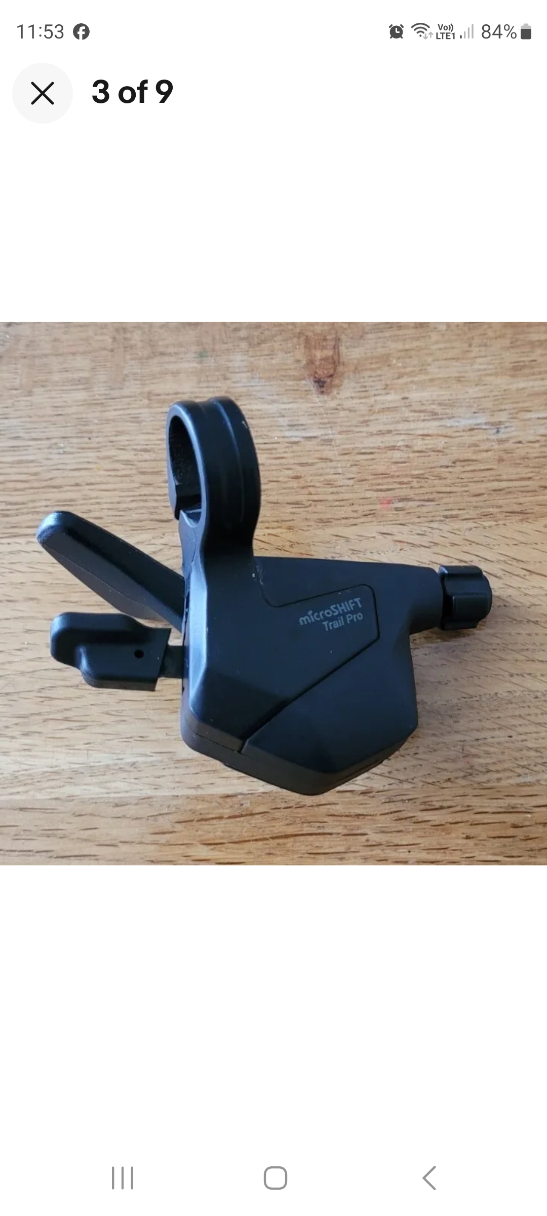

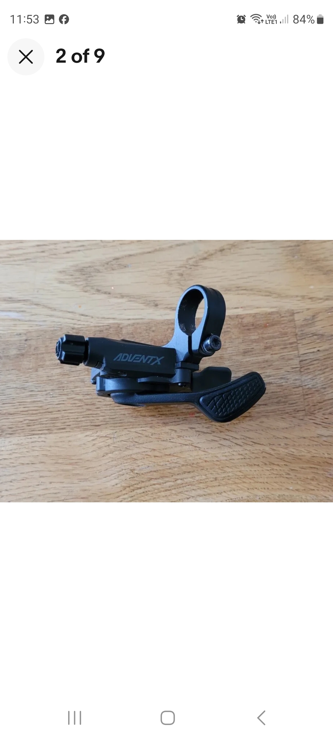

Yes, that's the correct shifter. It's even the "Posh" version with the silicone tabs on the shifter buttons.
If you press the down shift how many clicks are there. On the base version, there's three clicks as you press through the range of motion. So you can change 1,2 or three gears with a single press. I did read in one place that the pro version let you shift 4 - but I wasn't sure if that was a typo or not.
