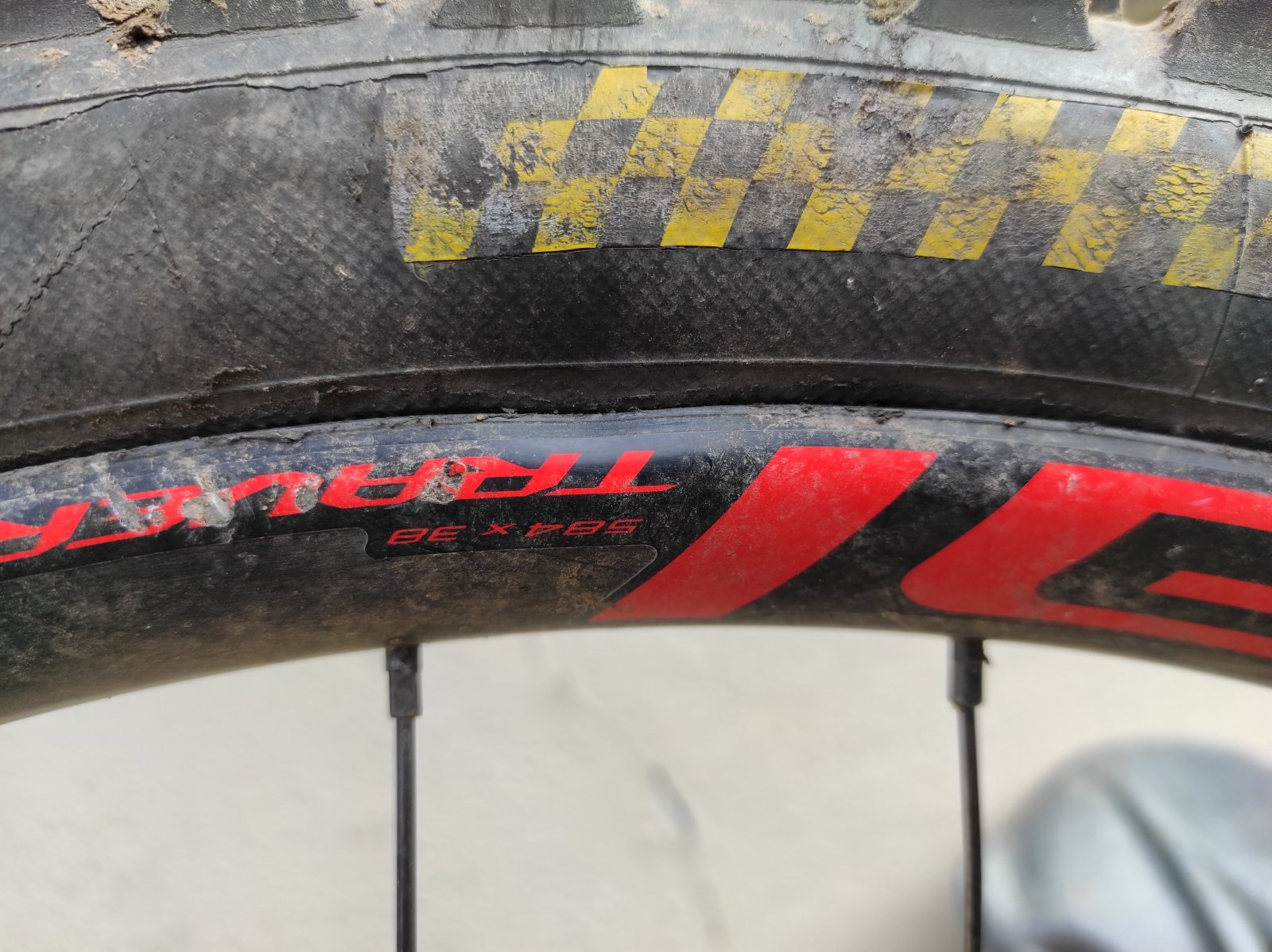

Has anyone else had better luck with these tires? I’ve been running the 27.5x2.6 on the rear and I’ve had two of them fail after only a few rides. The first I got a warranty replacement, and the second tore today on the third ride, just like the first. I have a new 2.8 on the shelf too, and they are making 29” now too so I was going to buy the front but am now hesitant.

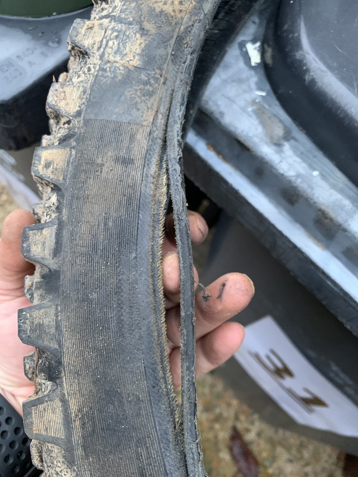

running e wild 27.5 2.8 on front and rear. had been fantastic. Yesterday felt wheel wobble from rear. bead is separating from tyre as described by others. I'm 59 and don't jump, running low 20's pressure.
Only done 100 miles.
very disappointed. no stock anywhere to get a replacement.
There is a definite trend for this happening. has anyone attempted ny kind of warranty claim?

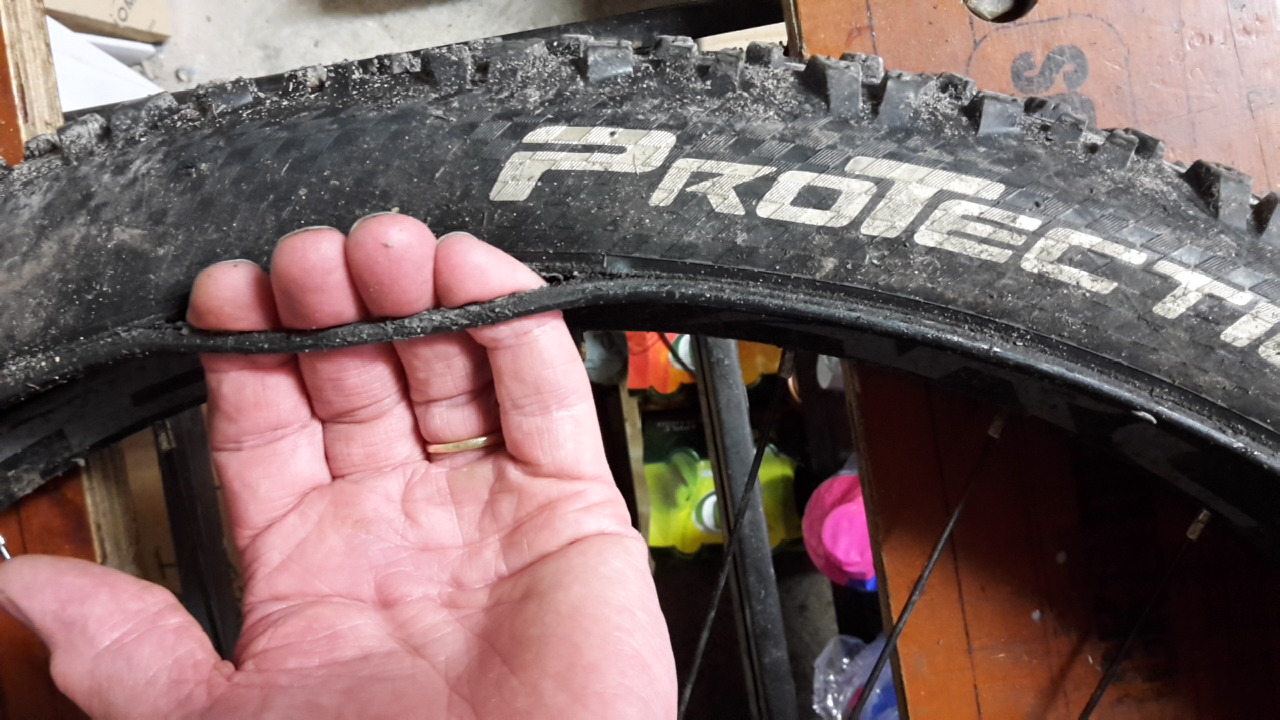

I suspect a batch issue. I had a similar problem with some Continental Trail Kings. They both failed at the bead, on the same side of the tyre and at the same rotational placing with respect to the "Protection" logo, and at 700miles +/10mile. Both accepted as a warranty claim without a problem.
