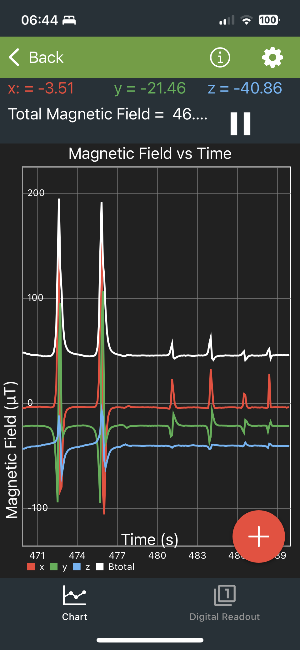

@Koekie posted in another thread a while ago a link to a Bosch patent that's pretty interesting. Based on this I started working a while ago on introducing a H-bridge to the MegaBobra cricuit to simulate the behavior of the electromag passing by the sensor (polarity reversing at the middle of the impulse). We can also see that this is indeed what's happening with the original rim magnet (Thanks @Mervious for doing that test/posting the results) :

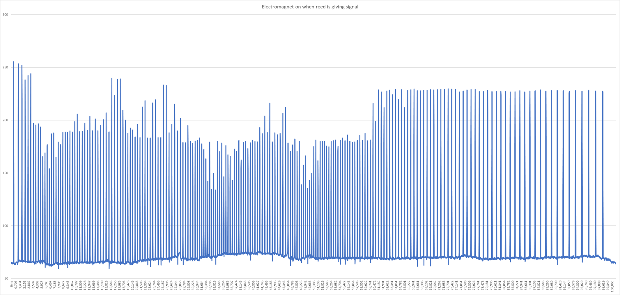

Whereas the MegaBobra as it is would get this :
Took me a while as I had some issues with the code for that but finally got something that seems to work as I want it to and now waitiing for some parts to build a live test device, but this is what would now get output to the magnet instead of a square pulse :
Will post diagrams and code update as soon as I have it tested in the field ;)
Also spent some time porting it to ESP32 so I can also play with RemoteXY and get some infos as well as configure the multi on the go ;)

Ideally we'd want a precise measurement of what is seen by the hall sensor at various speed or figure out a formula to output such a pulse and according variations in a truthful manner. Right now I'm using the detected pulse time to try and replicate that (or slow it according to the selected reduction factor), which was a pain to code for Arduino tbh due to most of the function that work really well being blocking ones (delay, while loops ...) and therefore getting the rest of the code to freak out eventually due to not being able to run at the right time to catch a reed sensor input or do other useful stuff 😅
Still not 100% happy with what I got tbh since there's a ~150ms delay where current falls down before being reversed and I'm yet to check if that's the H-bridge I'm using transient response time being that high or my code not being optimized enough ...
Another thing I've been thinking while looking at those graphes again is that it seems like the magnetic field is somehow always higher with the rim magnet then with the bobra, negative levels falling at similar levels to what we see when no current is applied by the bobra device to the magnet. Maybe we could get away with just using pwm there and keeping a small current sent at all times to simulate that field being always present and just somehow "nullified" (or maybe just slightly inverted, wich we could also do with pwm). This would also require some sharper measurements tho which I don't have the hardware for ...
Open to ideas and help there (especially if there's a decent dev around to show me my code mistakes as I'm sure there's a lot lmao)

This is the signature that I measured with my phone. (If I remember wel it is the one from the electromagnet, n’y the rim magnet...?)
I suppose Bosh is only taking the overall (sum of xyz). I c’ant imagine they capture and analyze each individual magnetic field?….
