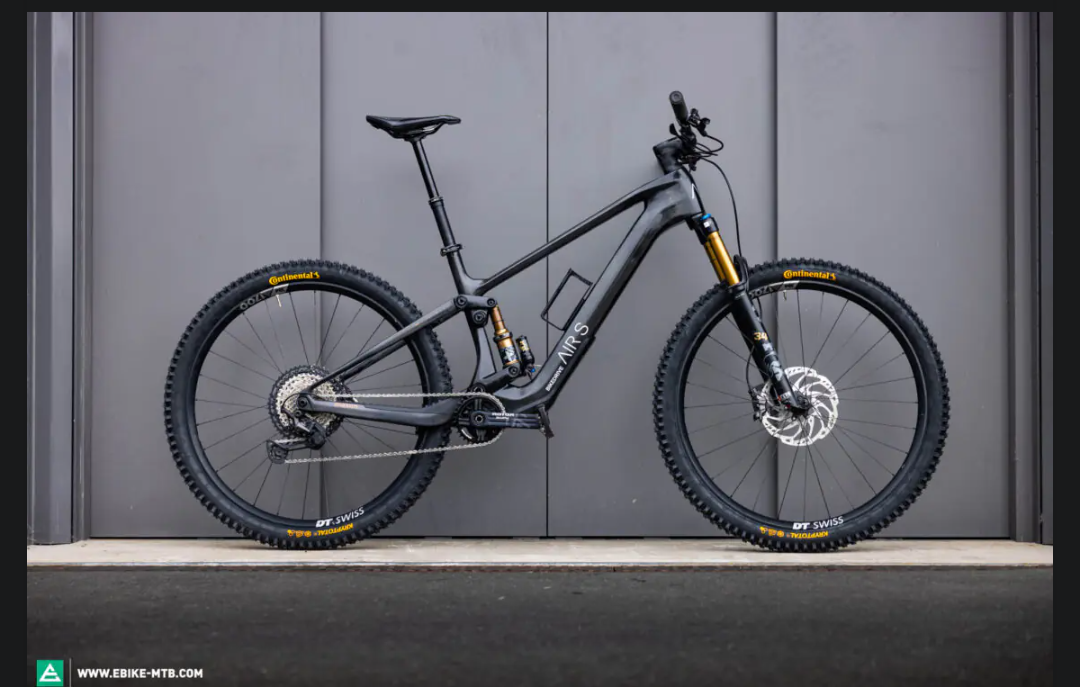

Maxon Air S 90Nm 620 W, 600/400. + 250Wh extender

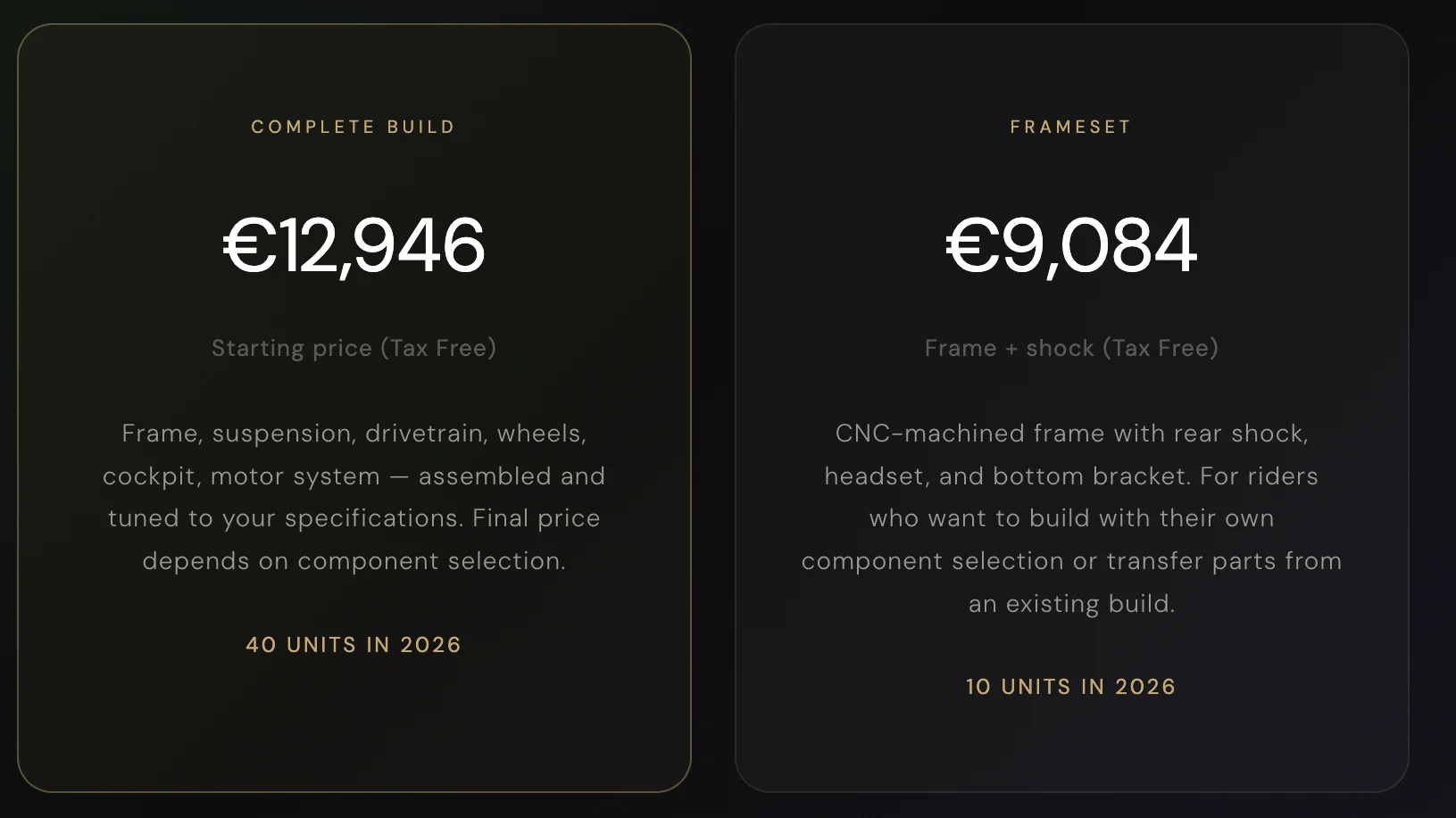

Frame-only is actually our default — it’s how we prefer to sell. We’re a smaller operation and we’re not going to pretend we can nail everyone’s spec wishes with a complete build. We don’t want to put together a kit someone pulls apart the day it arrives. We like custom builds ourselves, and our kits are set up for exactly that. Suspension-wise you can run DVO or Öhlins now, RockShox coil coming later.

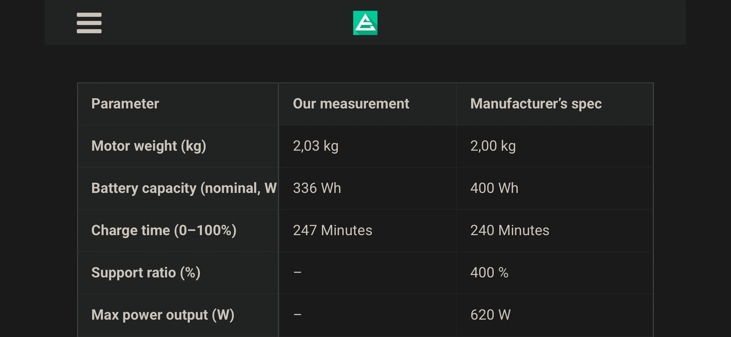

real 400Wh, or only 336Wh nominal as ebike-mtb.com tested it? how much can you really use of this "400Wh"?
I imagine it will be a 10s2p structure; if they use 5.5 Ah cells they would have approximately 400 Wh, if they were 5 Ah cells, approximately 370 Wh.
Unless they're still using 18650...
