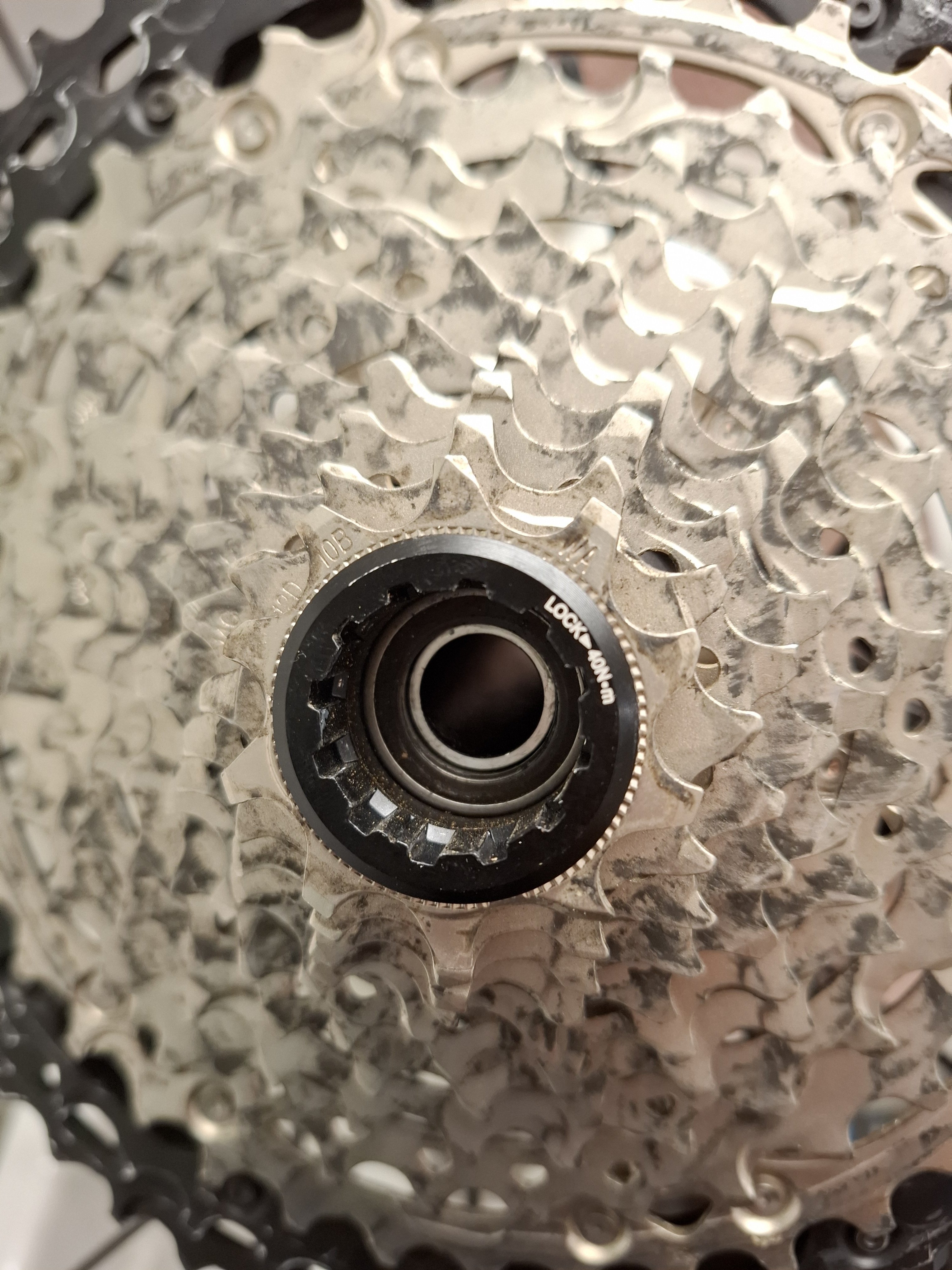

Hello, sorry for using this old thread, I'm in a similar situation, I cannot open to service the freewheel body of my E-deemax 2024, I managed to remove the end cap just pulling the freehub, but I cannot extract the freehub itself, it moves just about 10mm from it's position but after it seems locked.
I assume you have removed the cassette complete with freehub and end cap...then removed the end cap?
Yes as above, the 40nm end cap holds the freehub body to the cassette
I pulled with cassette installed as I'm used with Dtswiss hub on my second wheelset, freehub came out for about 10mm so that end cap came out but cannot extract freehub at all, it seems locked.
Maybe I only have to apply more force...
If the freehub is the hg splined type one common problem is those splines getting somewhat chewed by the cassette. That may be why the freehub is stuck in the cassette. Suggest you put the end cap back on and try tapping that with a rubber mallet or hammer with a piece of wood if you do not have one.
Maybe there is a misunderstanding, I cannot pull off the freehub (microspline) from the hub body, not the cassette from the freehub.
it get stuck halfway.
Yes I am confused! Your photo was the cassette. So to clear things up start from the beginning! First step is to remove the cassette nut using a shimano lock nut tool and chain whip. The cassette should the be able o be removed from the bike....leaving the freehub still on the axle held in place by the end cap. If you then remove the end cap the microspline freehub should slide off the axle. So what is stuck to what???

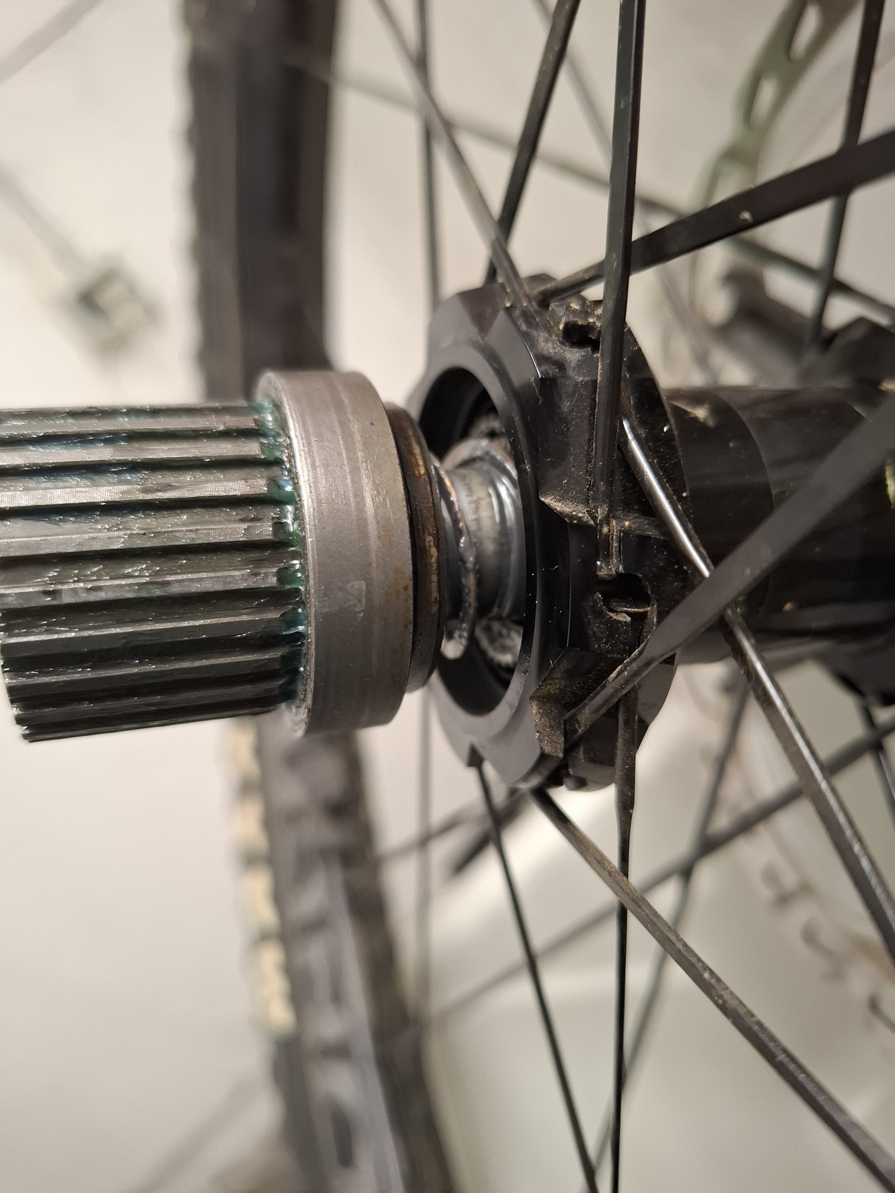

The microspline freehub on the hub axle, It slides halfway until it get stuck as in attached picture.
I tried after removing cassette as well but none.
Maybe I only have to pull firmer, I'm used with Dtswiss hubs where freehub pops out easily.

Hello, update my issue with my freehub, I tried to pull in any ways but it won't come out more than this.
Next step is trying to hit the inner axle with a hammer and a piece of wood, holding the freehub with the cassette installed. 😓
