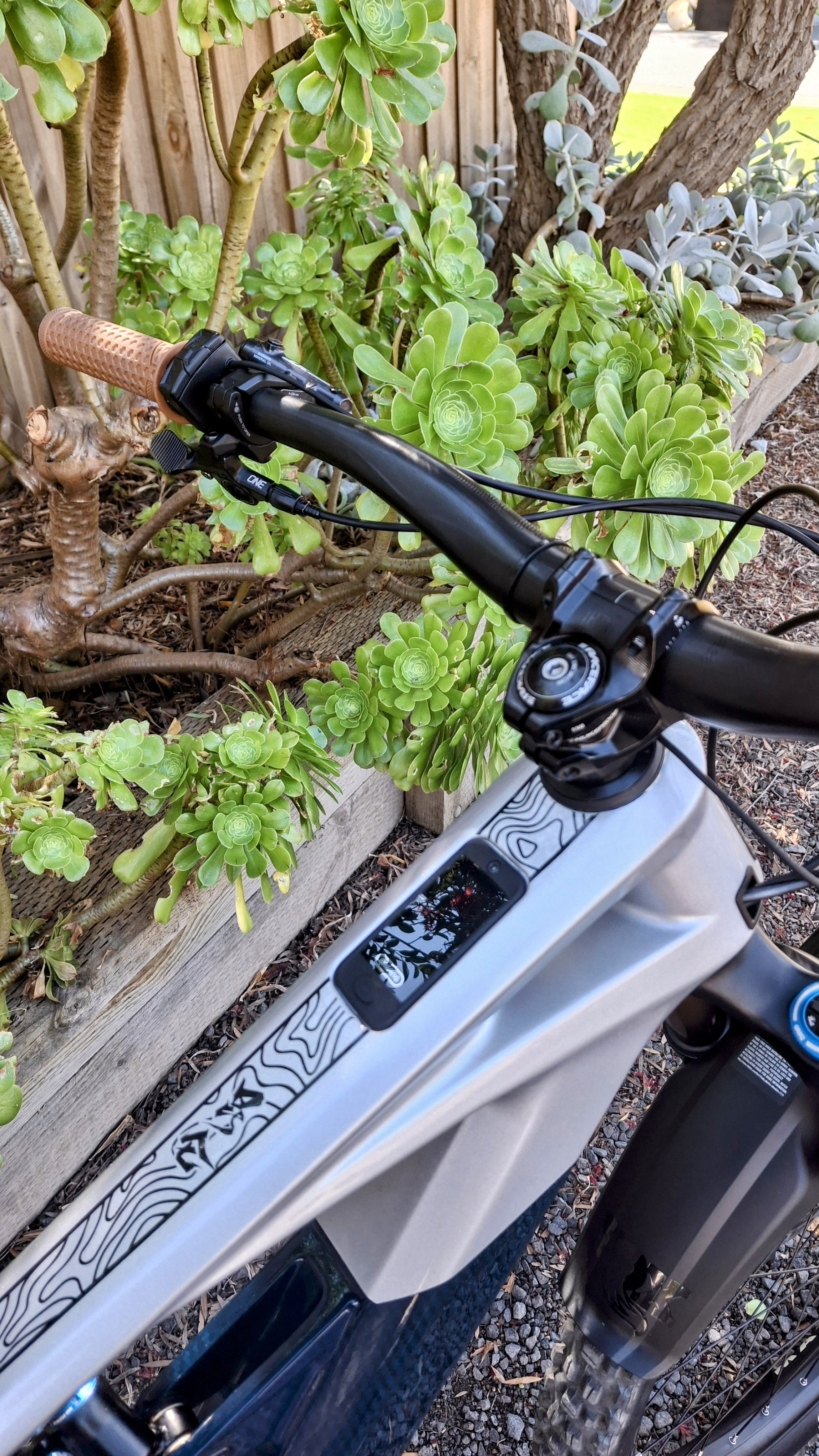

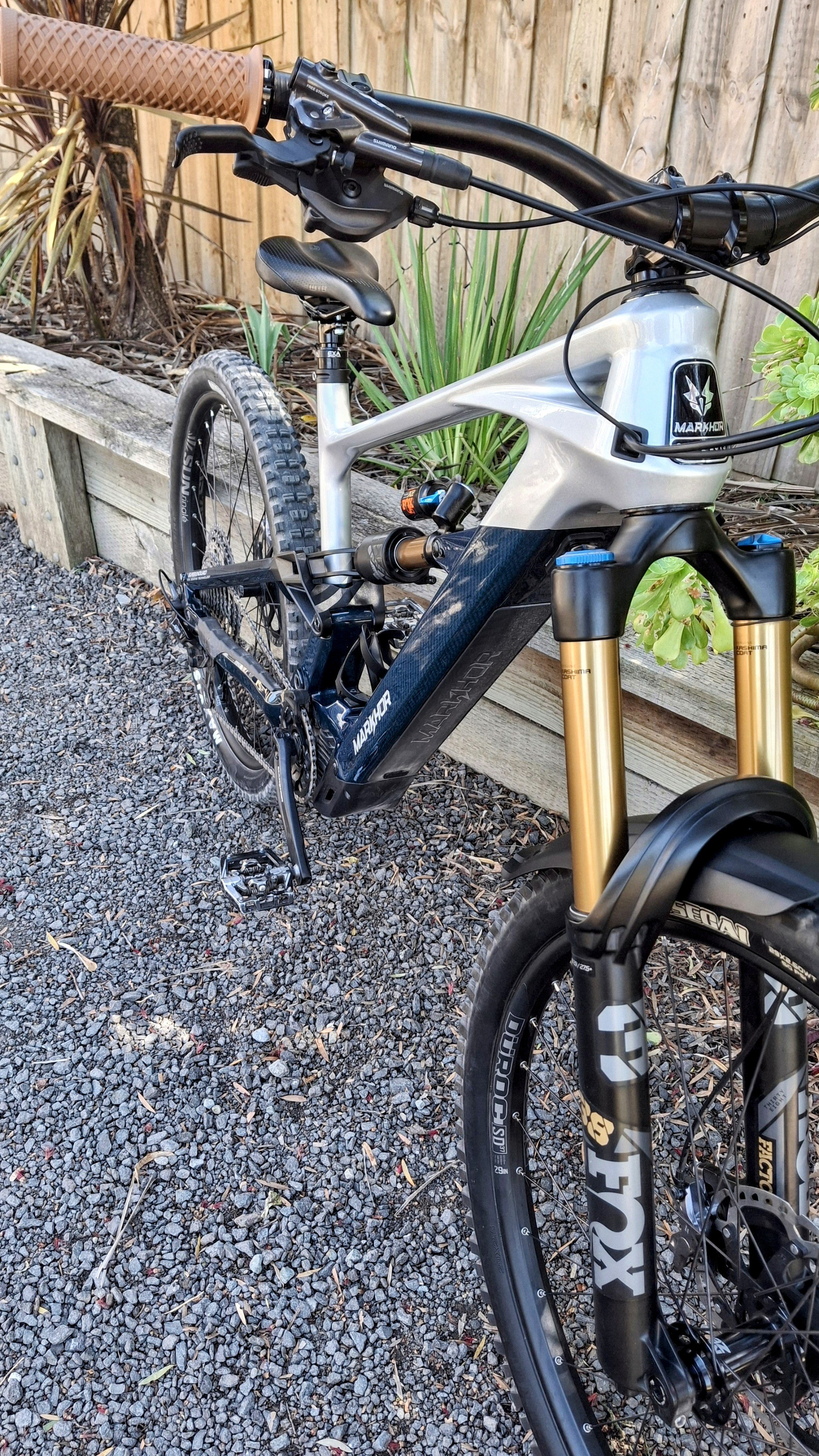

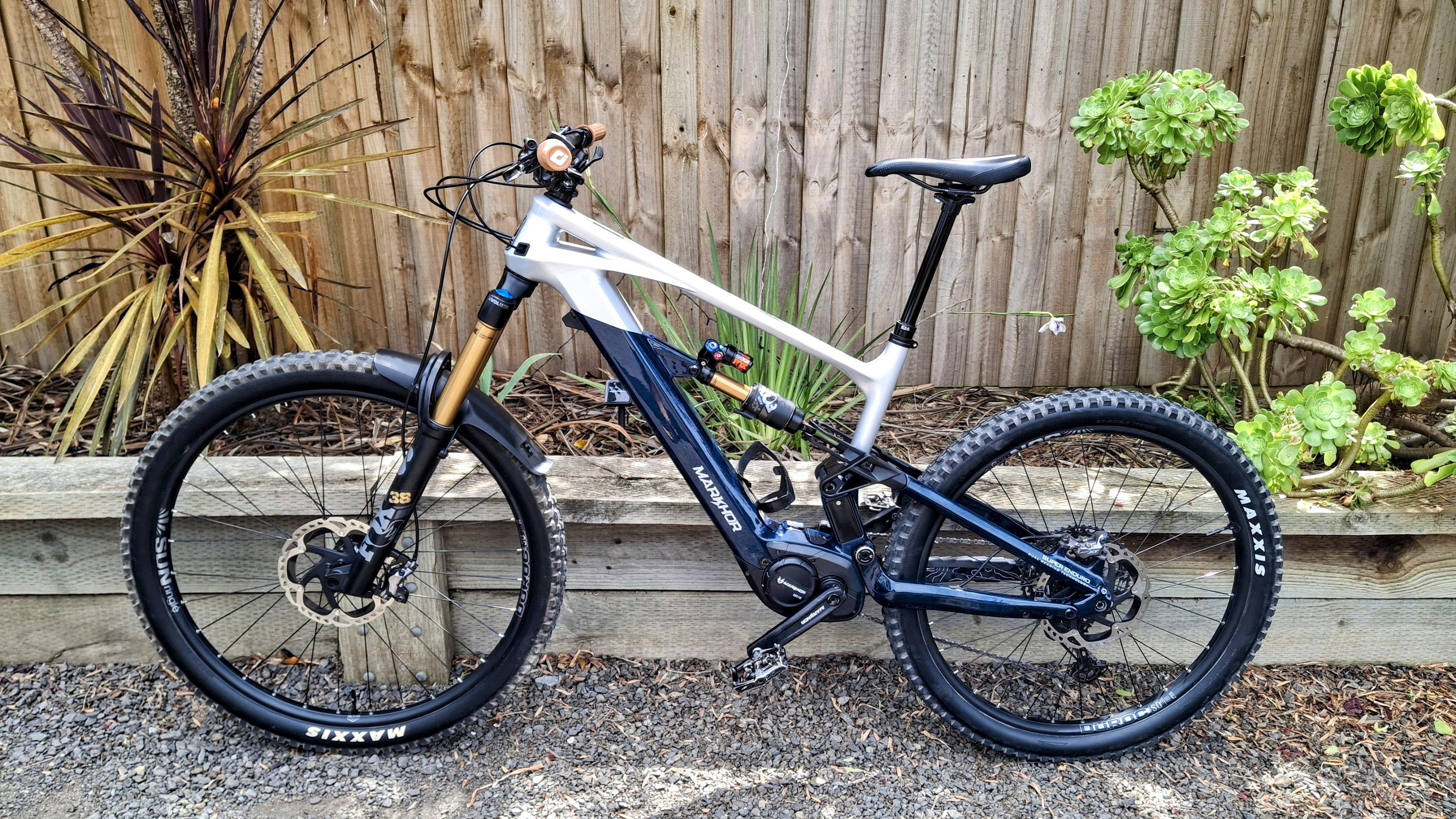

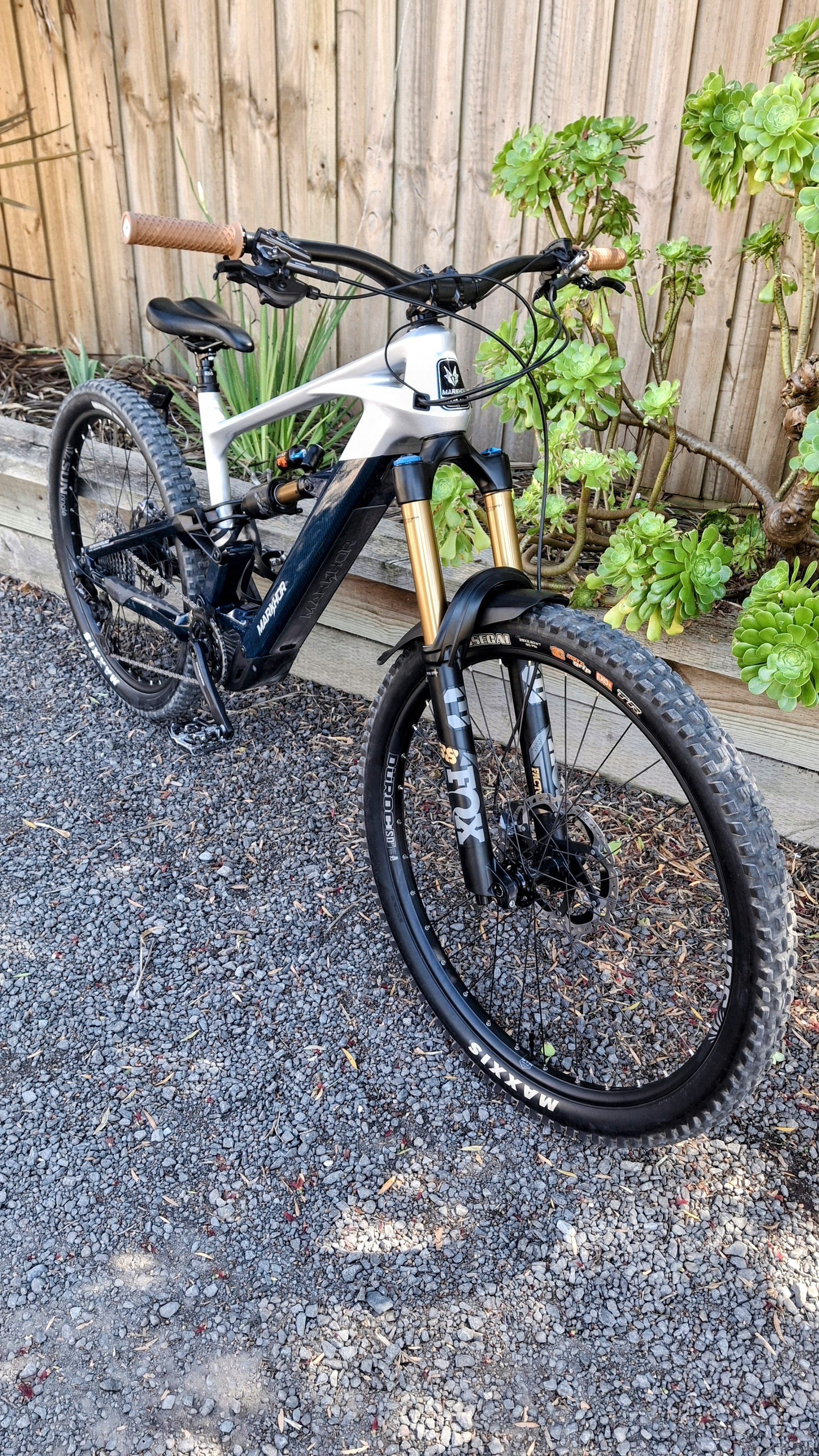

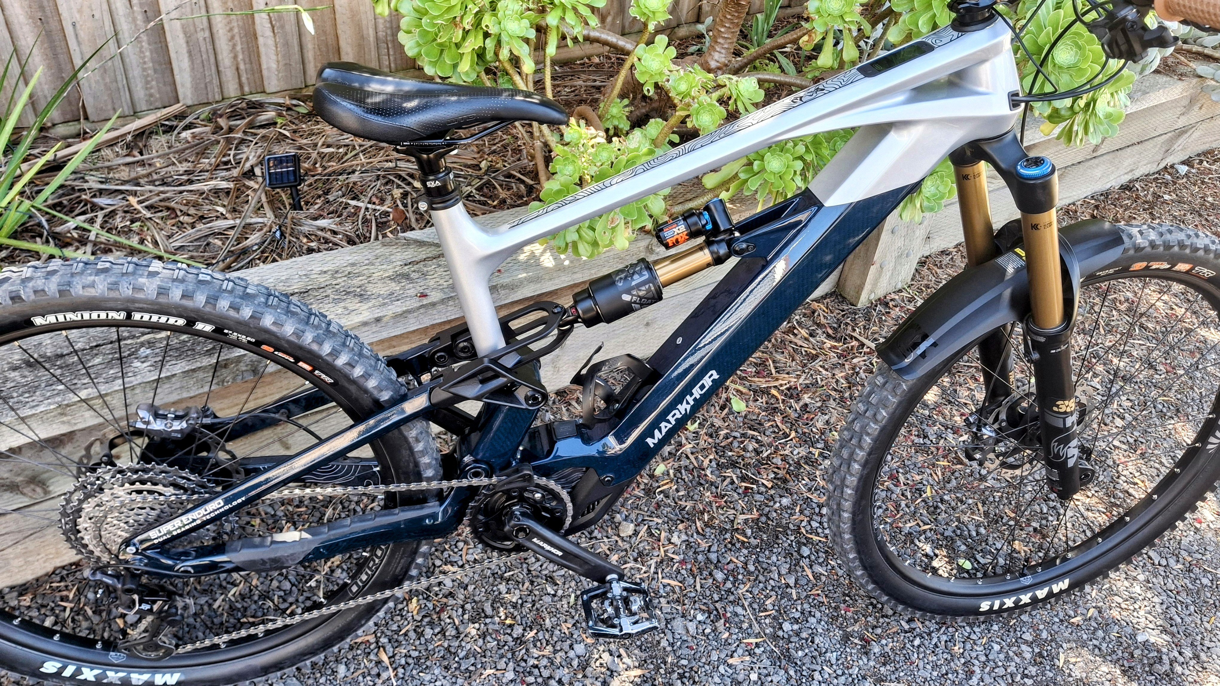

Hi guys,
wanted to share my new bike which i build from frameset.
I made a thread over on the DIY section
Enjoy the pics!
Specs:
Large Carbon frameset
Bafang M510 motor and 720wh battery
190 front Zeb Ultimate 3.1 & 196 rear Deluxe Ultimate DH Coil with steel shaft
Hunt proven carbon wheelset 36 spokes running Eddy currents and Cushcore
TRP DH brakes and 220 rotors
Oneup v2 240 dropper with ergon seat
Linkglide 10S ebike drivetrain with KMC E10 chain
Ergon grips, pnw alu bars, title stem and dmr v11 pedals
74* seat angle
63* Head tube angle
Here's my markhor Kun lun finished build...
Size S3 bafang m510
180mm Fox 38
230x65 Fox X2
Oneup carbon bars 35
Sd37 sunringle mullet wheelset
Shimano xt brakes
Exa 190mm dropper
Xt 12speed gearset
Weight 23.9kg with peddles and an tyre insert in the rear and exo+ tyres...
Still fine tuning the suspension and motor settings but dam what a bike rides great going to do a full YouTube review very soon.

Hi guys,
Enjoy the pics!
Specs:
74* seat angle
63* Head tube angle
What did it cost?
Size S3 bafang m510
180mm Fox 38
230x65 Fox X2
Shimano xt brakes
Exa 190mm dropper
Xt 12speed gearset
View attachment 150337 View attachment 150338 View attachment 150339 View attachment 150340 View attachment 150341
What did it cost?
once you put the rest of the bike together... I'm pretty sure that's the rear wheel speed sensor cable (y)
this frameset uses slightly different connectors compared to stock bafang kits.
this plug is part of the speed sensor. it comes in 2 pieces.
my wiring also has the range extender plug that is not out yet, so i blanked and taped that plug so water cannot enter
Non è necessario collegare il cavo, verrà utilizzato con l'extender, la seconda batteria...
