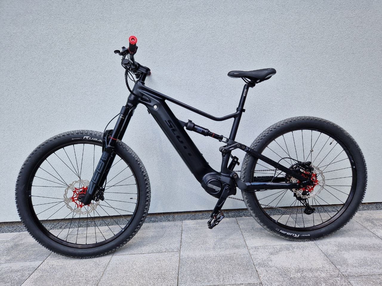

One year ago I've built bike using Markhor Rocket L - size frame. I still have this bike using it frequently. It has about 1kkm milleage.
It is really brilliant frame. One time I had to tighten the rear triangle main bolt, nothing else .
This year I decided to build new bike. Looking for another frame (only alu) I realized that there is no other better option than Rocket. So I have ordered M size frame- (my second order from Fieldebikes and Tars&Chili). This time painting went faster and package is in shipment. I will update this thread when the parts will arrive to me.
My first bike spec (from the beginning it was going to be budget project)
1. Front fork: Rock Shox Zeb 180mm travel
2. Rear damper: Rock Shox Deluxe Select R DebonAir 230x65mm, I'm going to change it for Float x2
3. wheels BlackJack 2x 29" with Continental Ruban 29x2,6
4. Motor: M510
5. Brakes: Magura MT5 with snails 203 brake discs
In the end the cost was much less than a new bike with a lower specification but with recognisable logo on the frame.
With this specification (wheels, suspension) when the bike is standing on plain surface effective seat angle is 78 degrees, seat pipe angle 71 degrees.
I compared this frame to Markhor Kun Lun and the geometry both of this frames are similiar! More details soon.

Well, another great deal from Changzhou Fieldebikes (Tars Wong and Chili Shen). It tooks under 3 weeks for shipment to Europe.
As a result, all the parts have arrived. I am starting the process of building my wife's new bike.
The frame painting is flawless. I noticed maybe 2 small dots, but in hidden places. This time I've decided for blach glossy, earlier I ordered black matt.
Spy photos soon.
The new bike is ready and running great :)
This M size frame with mullet wheel configuration is great for technical cornering on tricky singletrack sections.
Effective seat tube angle with mullet config and RockShox Domain 170mm is 74degrees (frame size M).
