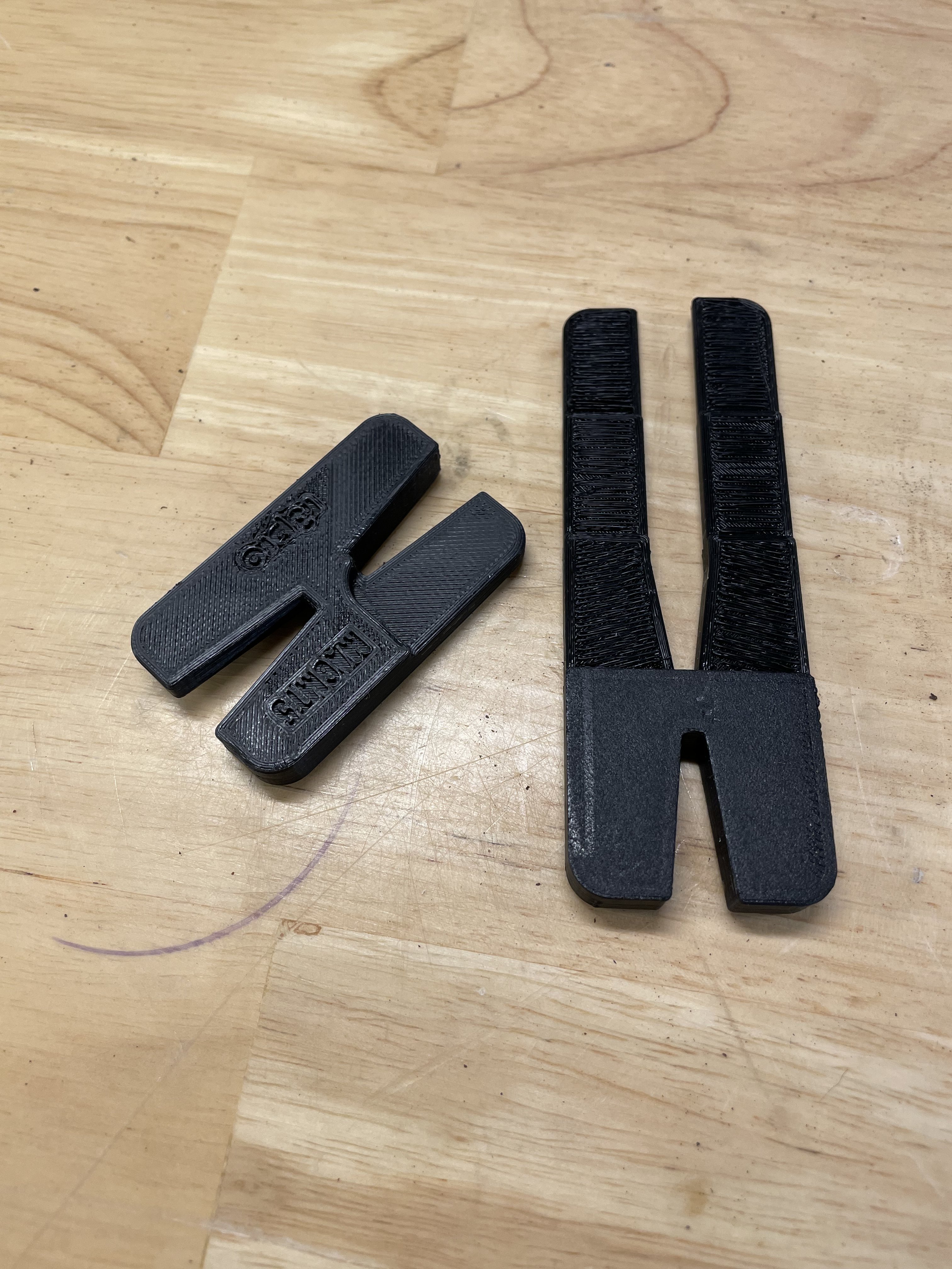

Do you have a link to downlaod the stl?
If you mean the small plastic tools …R3Pro EB2E354F-067A-4ECC-8C7F-A673B09B65D2.jpeg
Search google. I think he’s based in the UK. Seems to be expanding his 3D Printing solutions. Especially for brakes.
I’ve ordered a few items from him and they were delivered, no problem, to BC

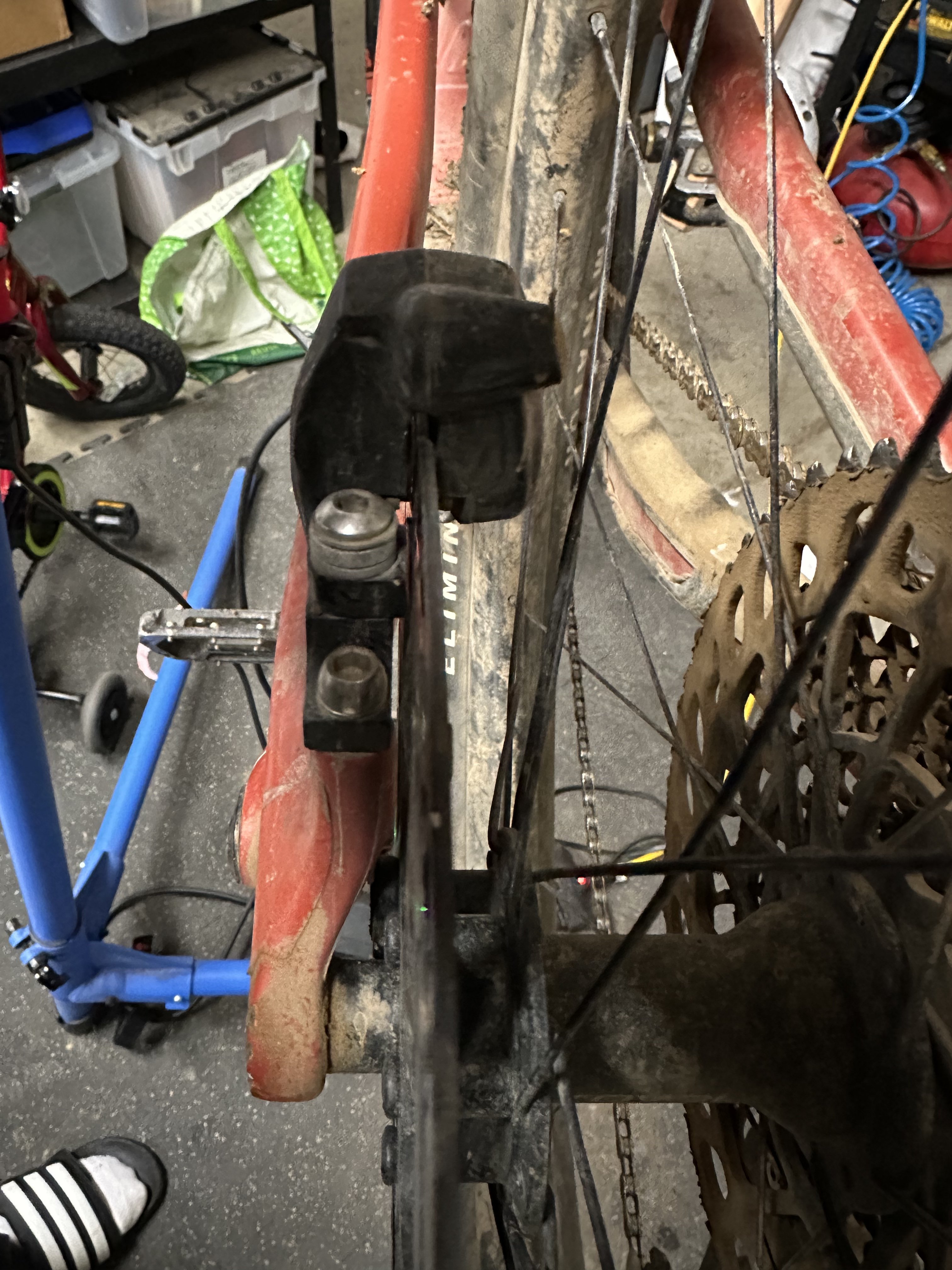

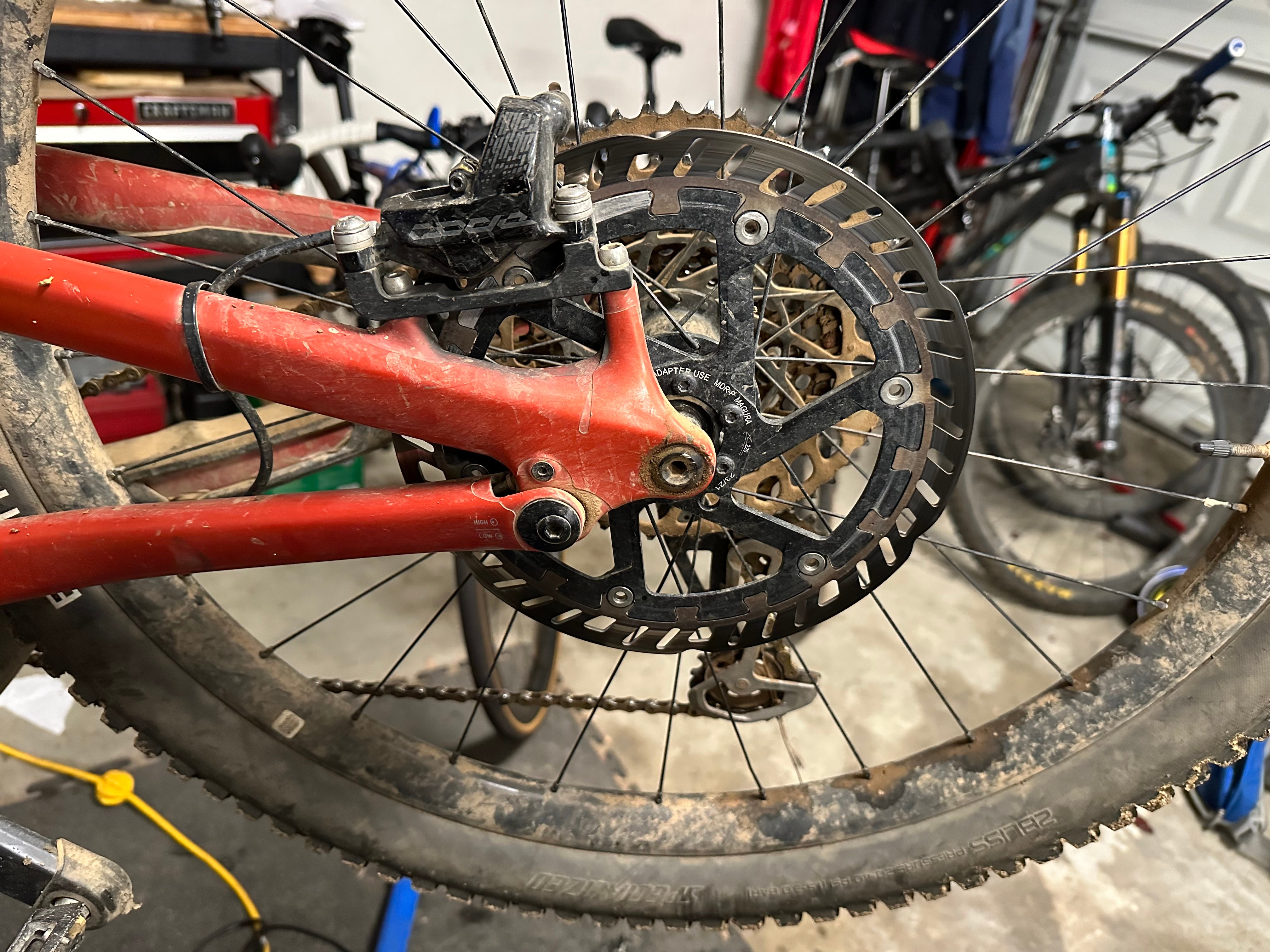

Clearance just makes it. No issues with the river, but if the rotor gets tweaked good the lower piece will run against the mount until it’s bent back.
View attachment 102502 View attachment 102503
It looks in the picture like the inner face of the caliper mounting lug is more inboard than the left inner face of the disc pathway in the caliper, which is very silly if that's the case.
Yes, but that’s where it needs to be for everything to line up. It does limit the adjustment on the caliper as the pads wear. That’s where the clearance just makes it. On the old setup I didn’t care much if I had a lazy piston, but in this one I have make sure they are all working the same.
