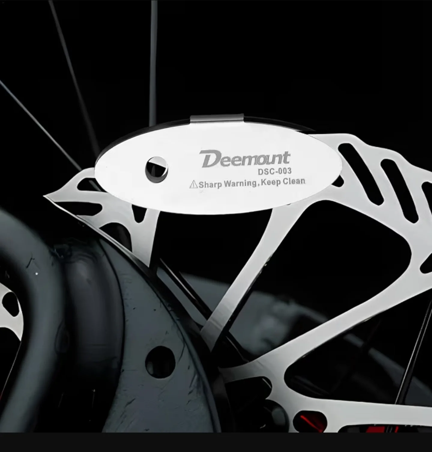

Then I bought these brake alligment plates and finnaly got them silent but the weird issue I'm having is sometimes they start squeaking like a pig when I turn or when I'm climbing and few brakepulls and they are silent again. And random they start squeaking.

Ive use these alligment tools and they certer it great, but when I brake I have to pump the brakes twice and they come closer to the disc and then the squealing sometimes apear
