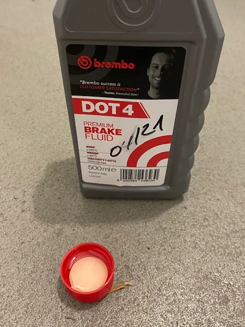

No coffee! 😂 I took the pics for recording after I took out the bleeding screw and saw the oil like colour, as I remembered this topic and statement, that Magura fluid was not blue.
Could be aged or been over heated, from what I learned. Maybe others had seen this as well when bleeding their brakes.

Yikes. I hope the goons at the shop didn't use DOT brake fluid...
Coffee!? Even the new SRAM mineral oil by Epic bleed is green I think! Never seen oil that colour from Magura caliper internals. Shimano caliper sometimes black from seals or grey from shaving material from banjo thread (fluted banjo screws)

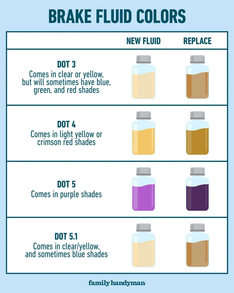

It really does look like DOT fluid though, doesn't it? That's straw yellow.
Gentlemen, if that is your straws yellow you should consult your doctor! 😉 The DOT I know from automotive is more a clear stuff.
