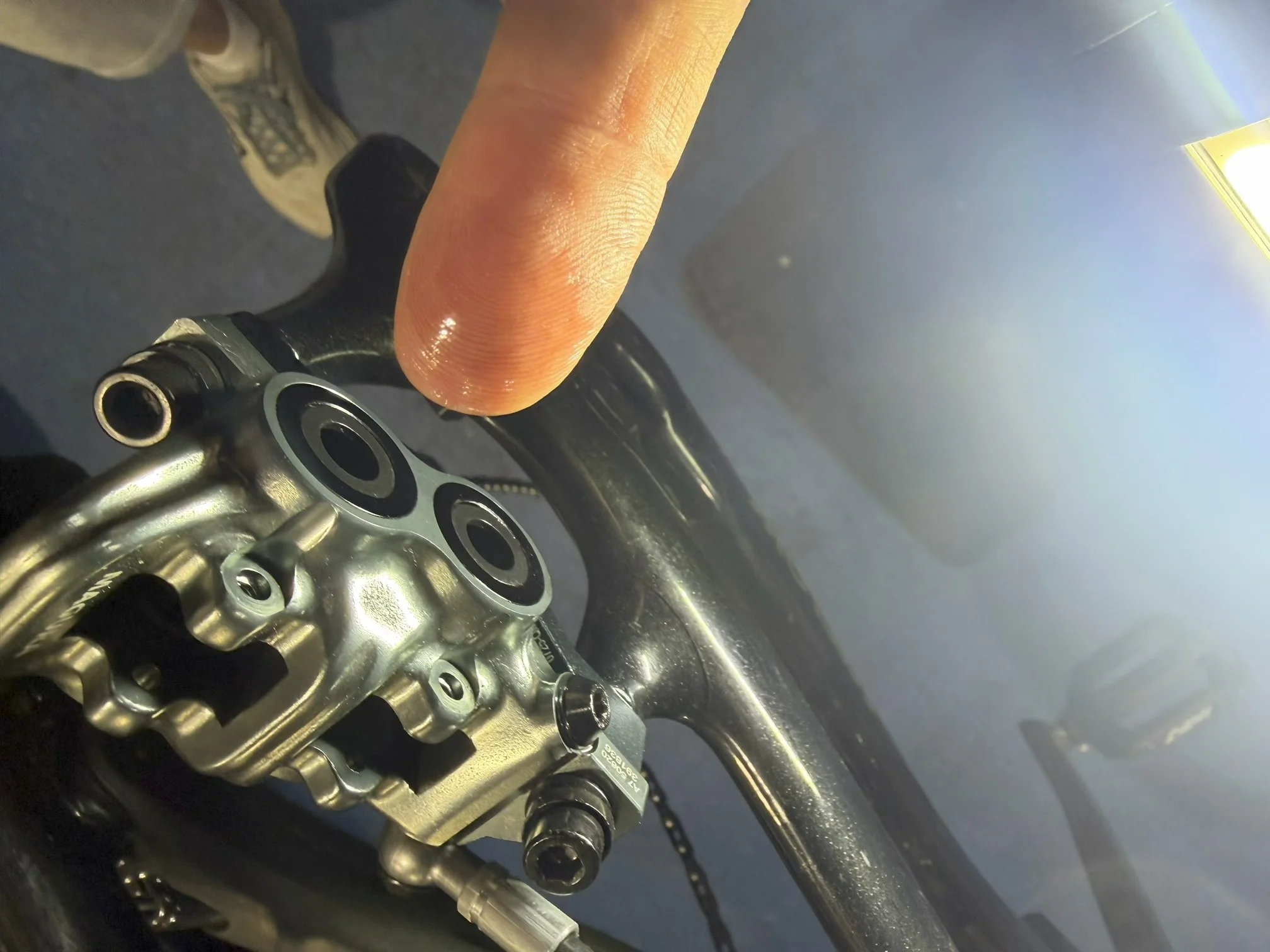

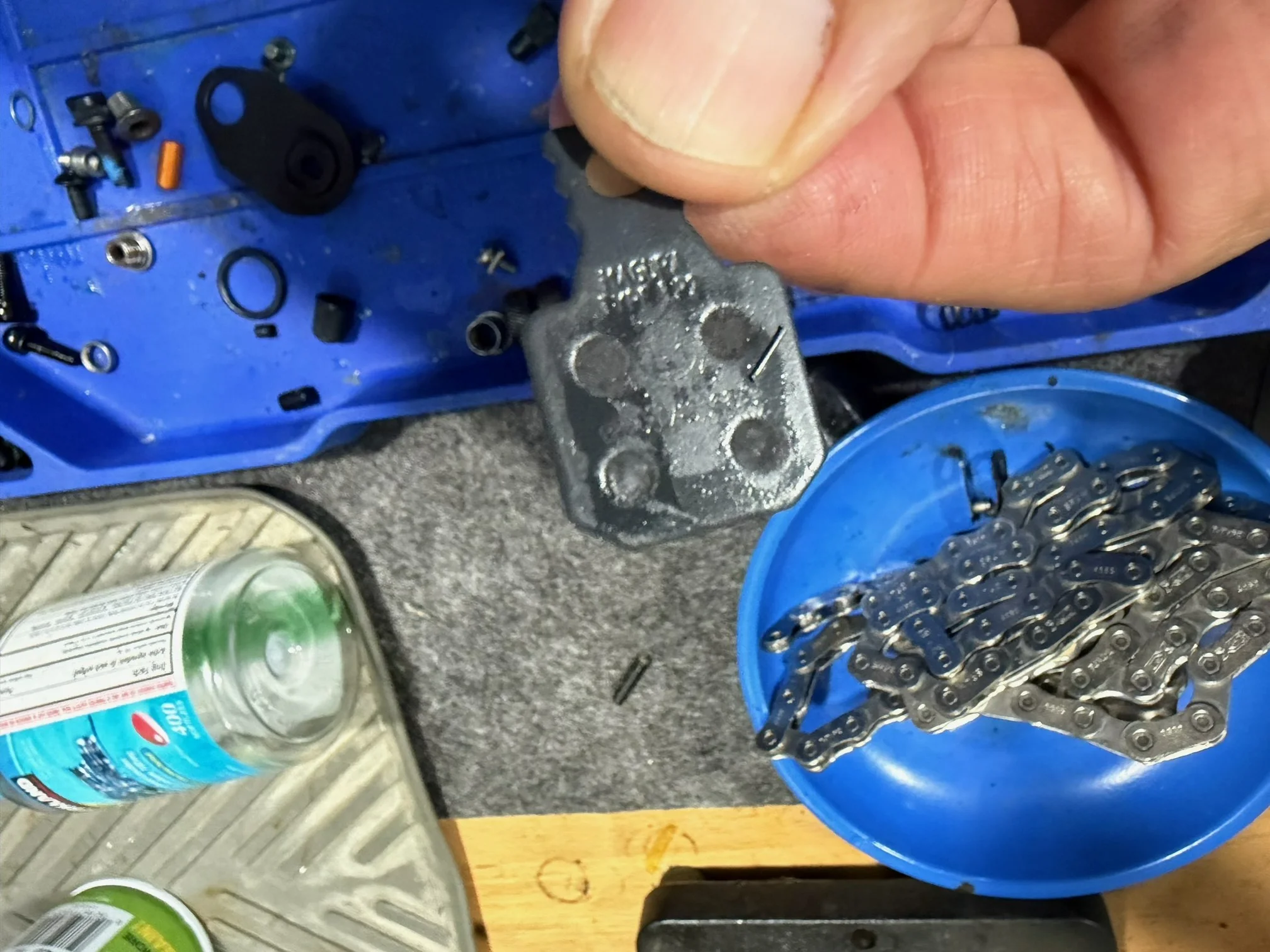

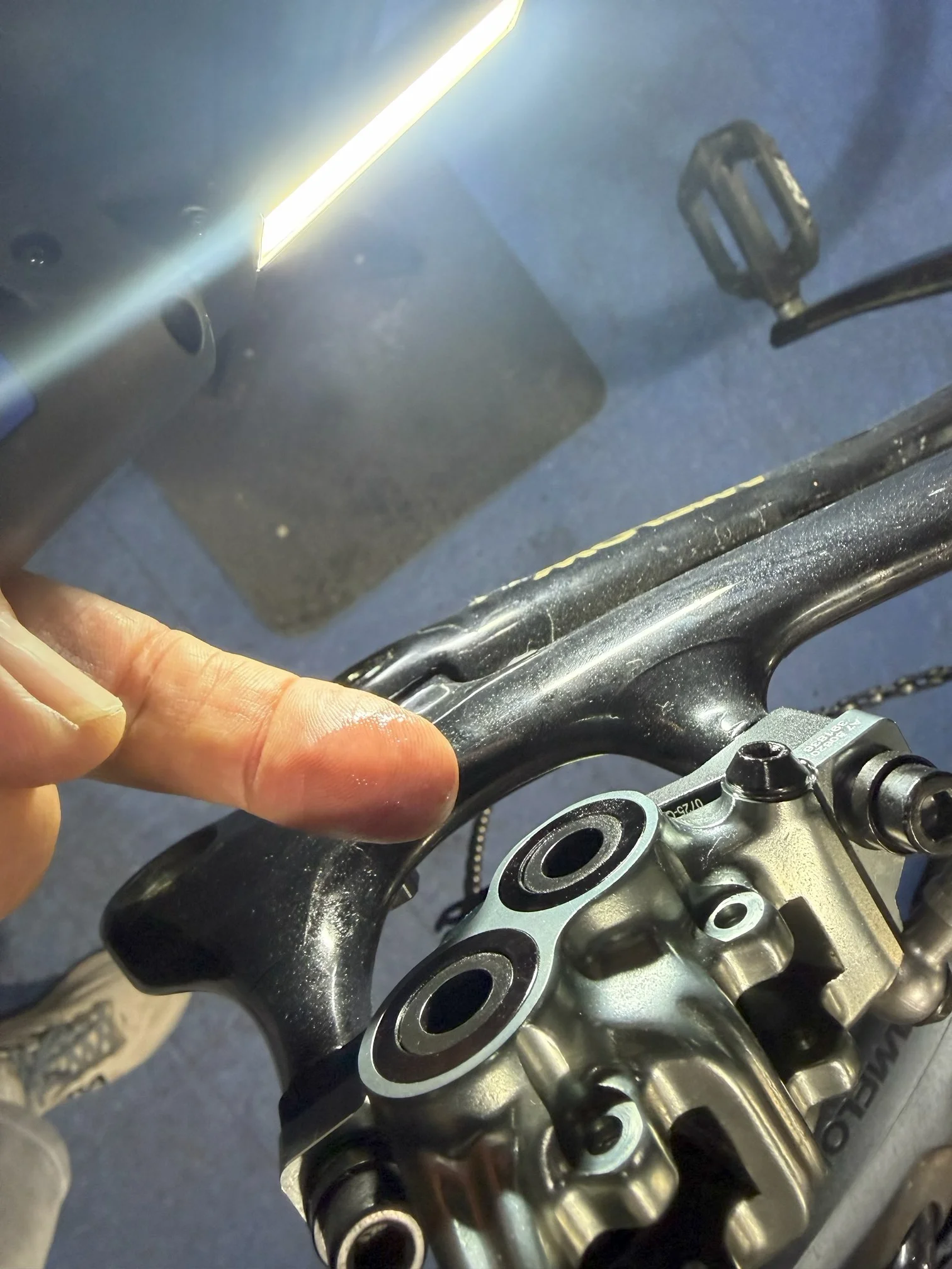

Hi Community, What I feared would happen with a Chinese brand that does not have any real NA support, has happened...My Magura 7S failed (both front and back) after only 5 months and Amflow is not willing to cover anything. Per there fine print they are saying all 3rd party components are not their responsibility. I have requested escalation to a supervisor at Amflow NA. I guess they are based out of Racine WI? (Call center for NA maybe?)
I recently lost performance on both front and back brakes. The brake caliper pistons (seals) failed and started leaking oil (both the front and back!). I took it to 2 different shops to no avail. The latest person to work on it and provide the correct diagnostics is one of the most reputable / well bike guys in West TX and local mechanic (ex-firefighter) by the name of Eric E (shout out to his small garage bike shop / operation). He figured out what had happened and I am posting both his pictures and video explanation. I do not know if this is a just bad luck or a set of Magura "lemons" brakes.

Was this bike sitting unridden for a couple months by any chance? Or were the bikes recently bled?
I've seen well intended people attempt to bleed Maguras but by using a syringe incorrectly they overpressurized the system.
I've also seen MT7's that will get sticky pistons after sitting for a couple months.

I rode the bike pretty steady for the last 6 months (since i bought it). Now the first dealer / bike shop did do a blead after I had problems with the rear brake...they could have aggravated the issue...who knows...but like i mentioned before the brakes where already leaking oil.

I'm wondering if it sat somewhere for months before you got it. MT's can get sticky pistons from sitting for extended periods. Anyway, I'm sure Magura will take good care of you. I'm certain of it.
