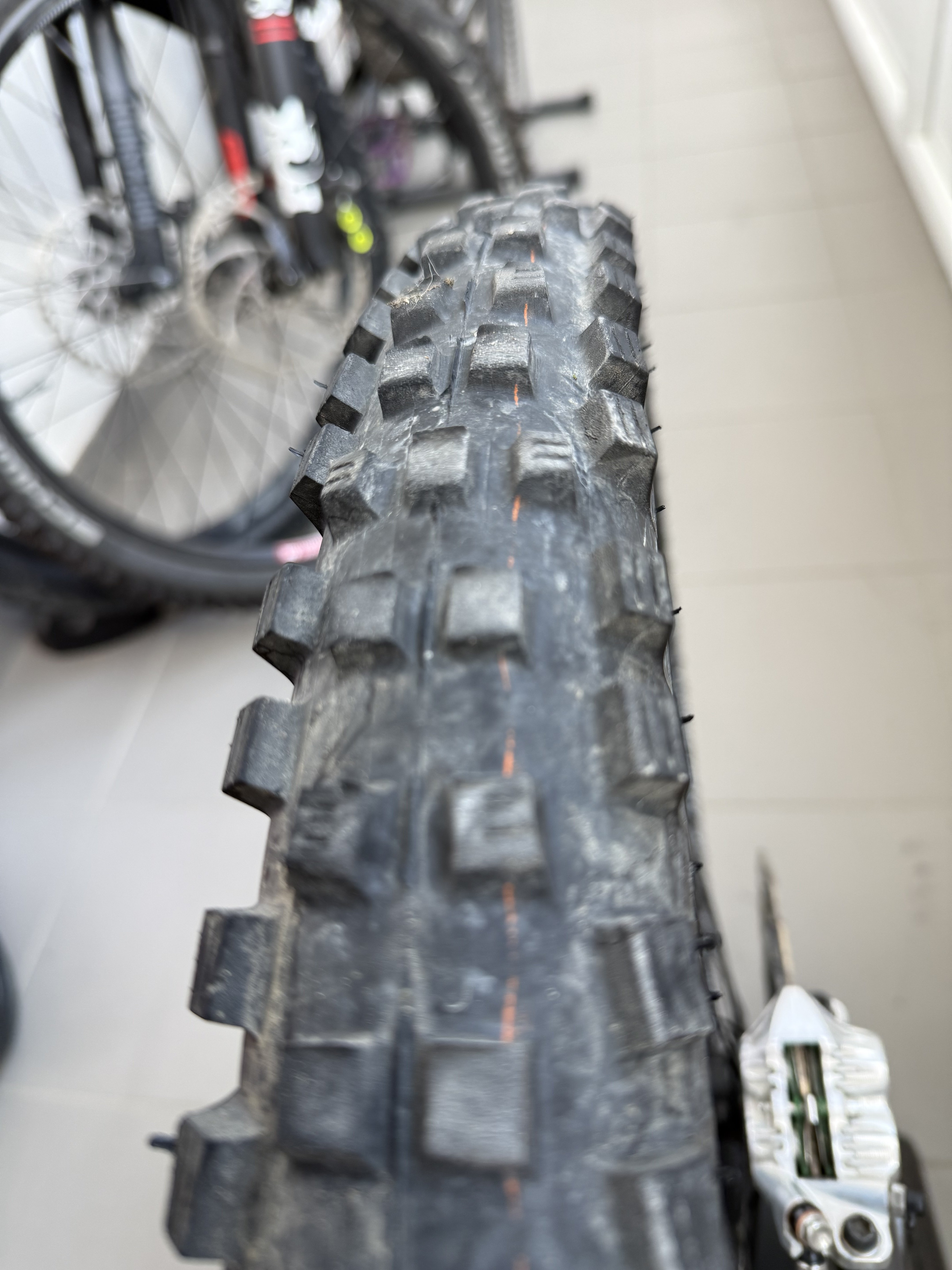

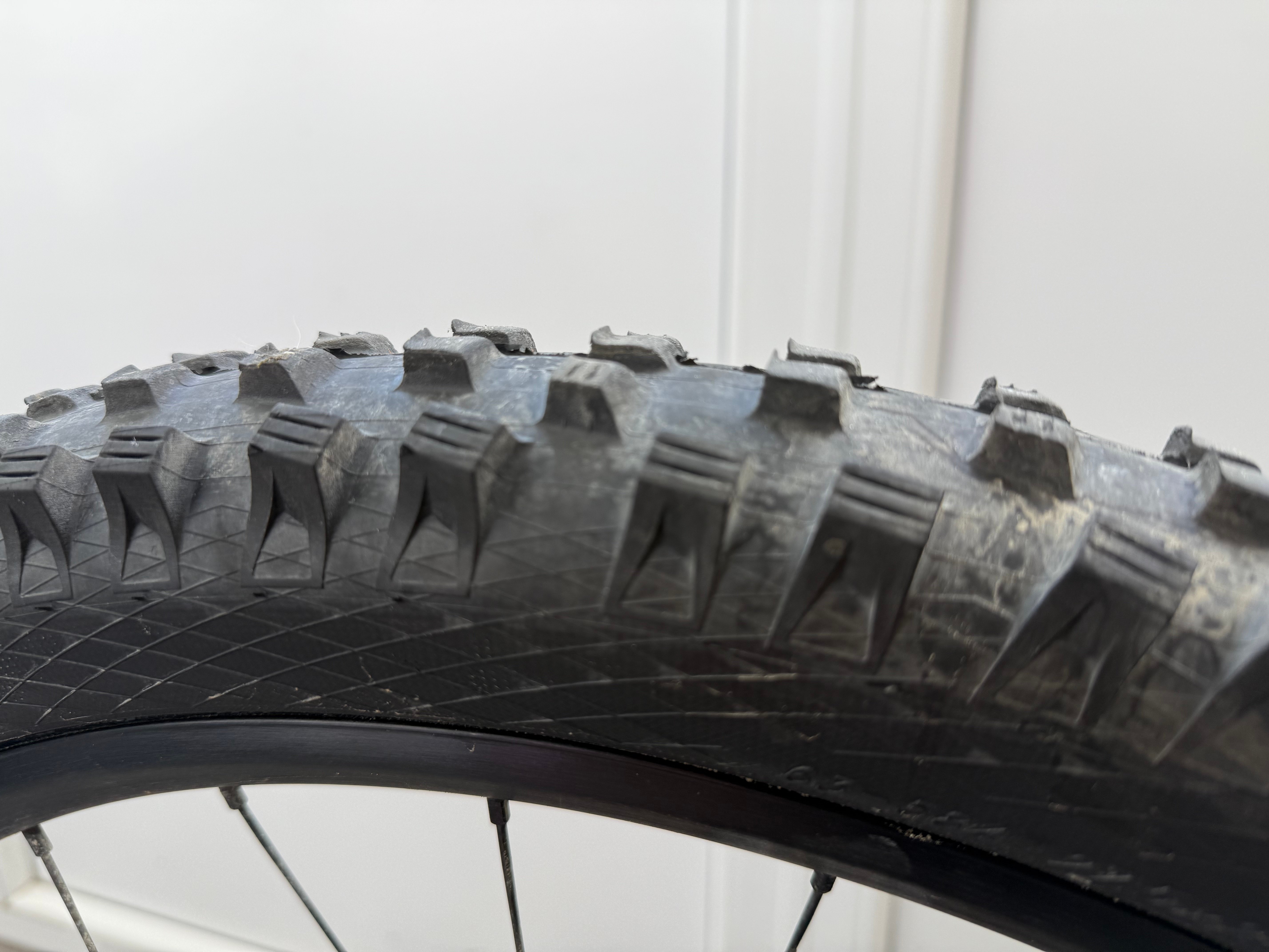

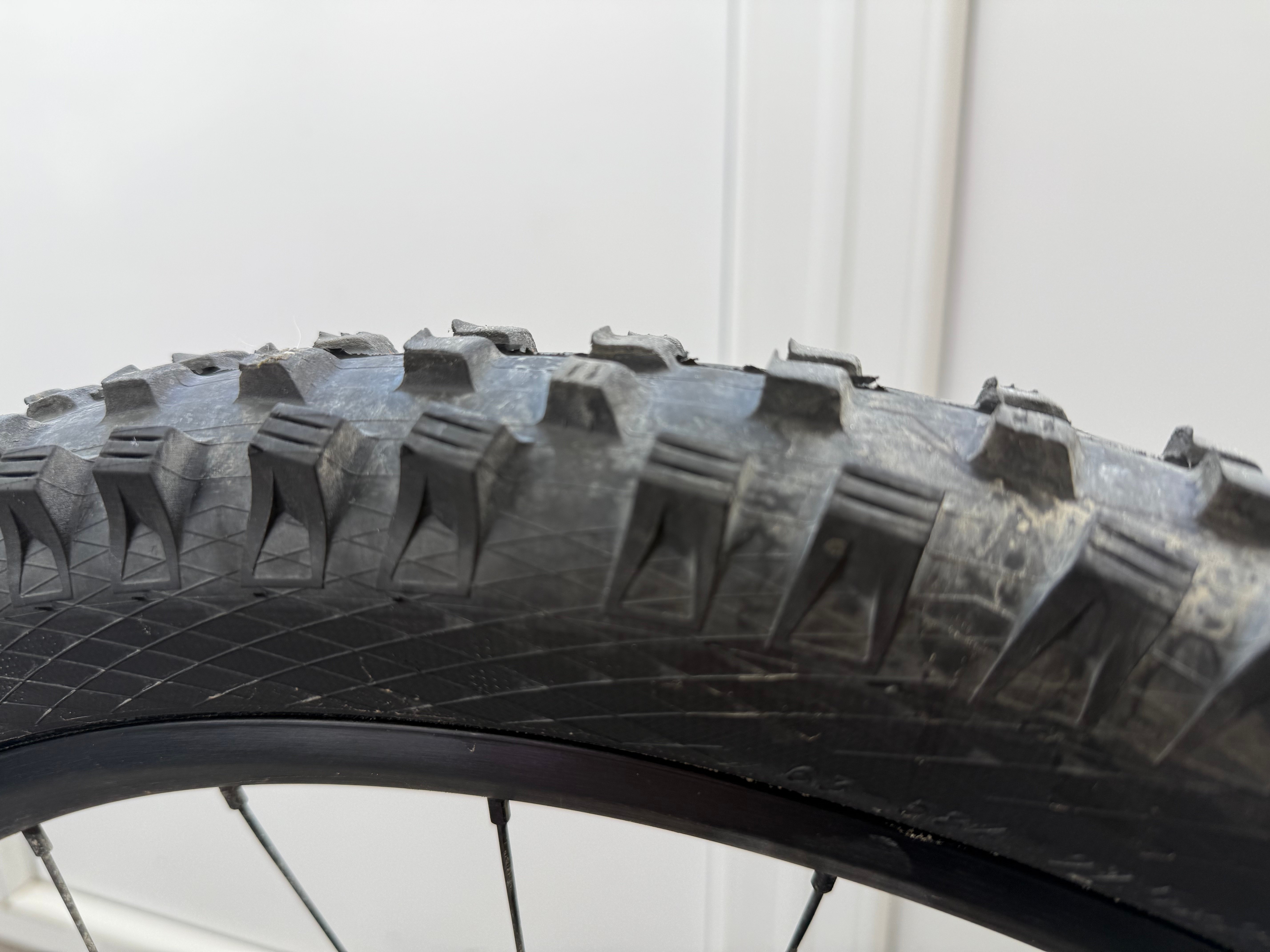

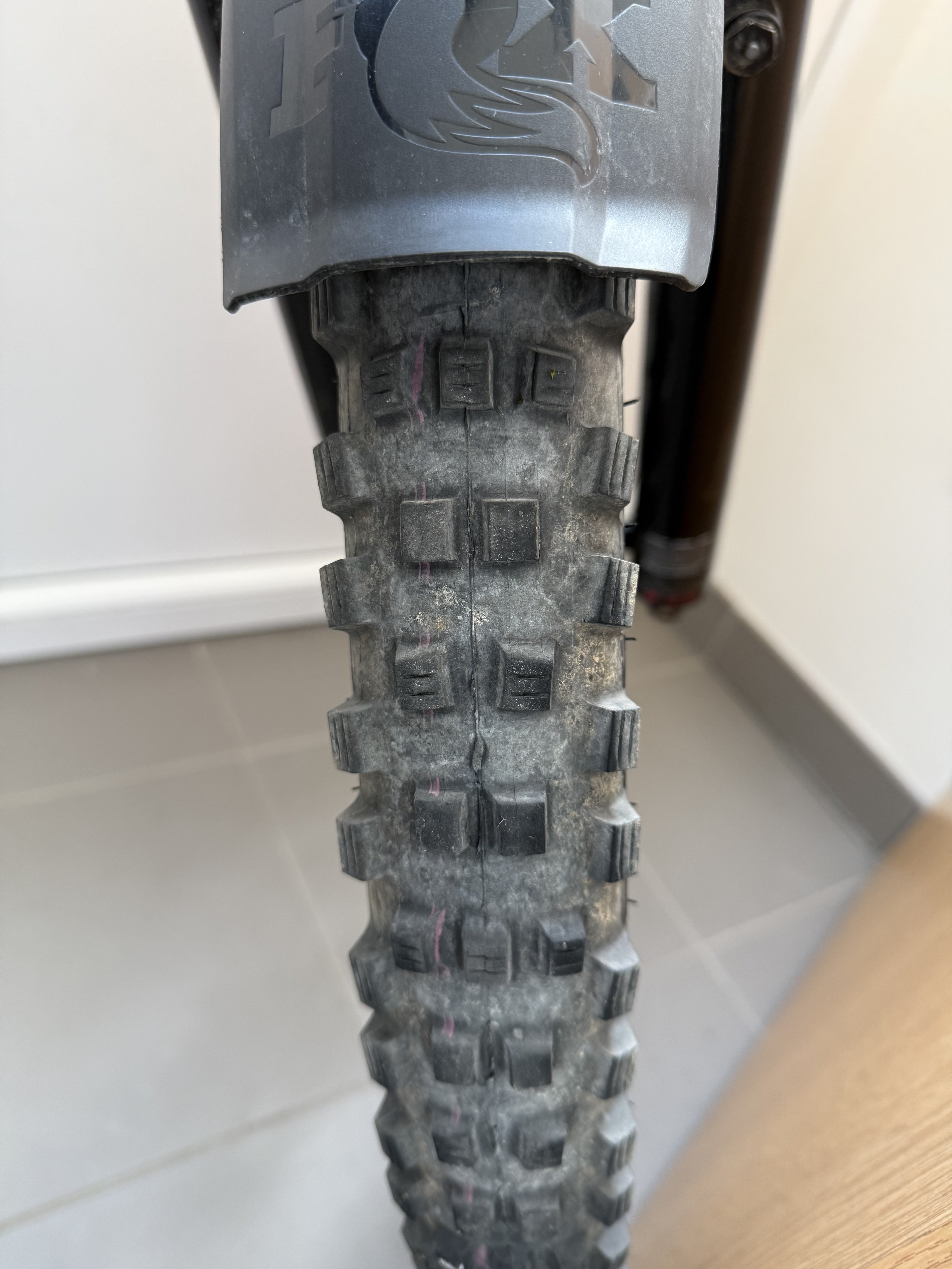

Small update after ~400km riding the MM Radial combo front and rear.
Where: 70% natural trails and bike parks, 30% gravel roads.
Conditions: wet, dry, mud, loose over hard packed trails, hard packed trails.
My riding: I am an intermediate rider,no crazy stuff but I love technical descent.
Let's talk about feelings now...
The first few kms it seems that everything is off. Tyres are sensibly softer on the shoulders and you can really feel it. I normally ride 25-26 psi front/27-28 psi rear. I increased by 5 psi both front and rear as per recommendation from Schwalbe and still seemed to be way softer than the previously installed Specialized Butcher/eliminator combo.
However this feeling goes away as soon as you get a few kms...
How do they ride once you ger familiar. Well.. Let's startwith the front in ultra soft compound: it is an absolute blast! Very confidence insipiring, super smooth in transitioning into turning, incredibly grippy. I just love it! No matter wjat type of terrain I rode, the front was an excellent experience. I think this will be my tyre from now on.
The rear: the feelings are really the same as the front with a huge "but"... On rear I am using the soft compound, not the ultra soft.
And here is the "but": I think this is not a good tyre for ebikes and/or heavy bikes or riders. It is just too soft. The central pins are very grippy especially whenyou climb and they were excellent on roots and stones. But they are soft like butter. After only 400km they are already waaaay too consumed. I normally ride with 20 to 60% assistance, with the latter power % only in extreme scenarios... But still the pins are incredibly consumed.
To mention also the rolling resistance: quite high 🙂
Let me share a couple of pics of the consumption... First two are rear and the third is front. You can notice the rear pin have that "wave" 😁

My experience as well with the same setup. MM radial rear doesn’t hold up to e-punishment. And this is the soft compound, not ultrasoft. I replaced the rear with Albert soft and it‘s holding up better. I think MM doesn’t have the knob surface area needed to handle the power. Same with slowing down the heavy beast.

The soft comes in gravity. The ultra soft is trail but on the front I found it good enough 🙂
