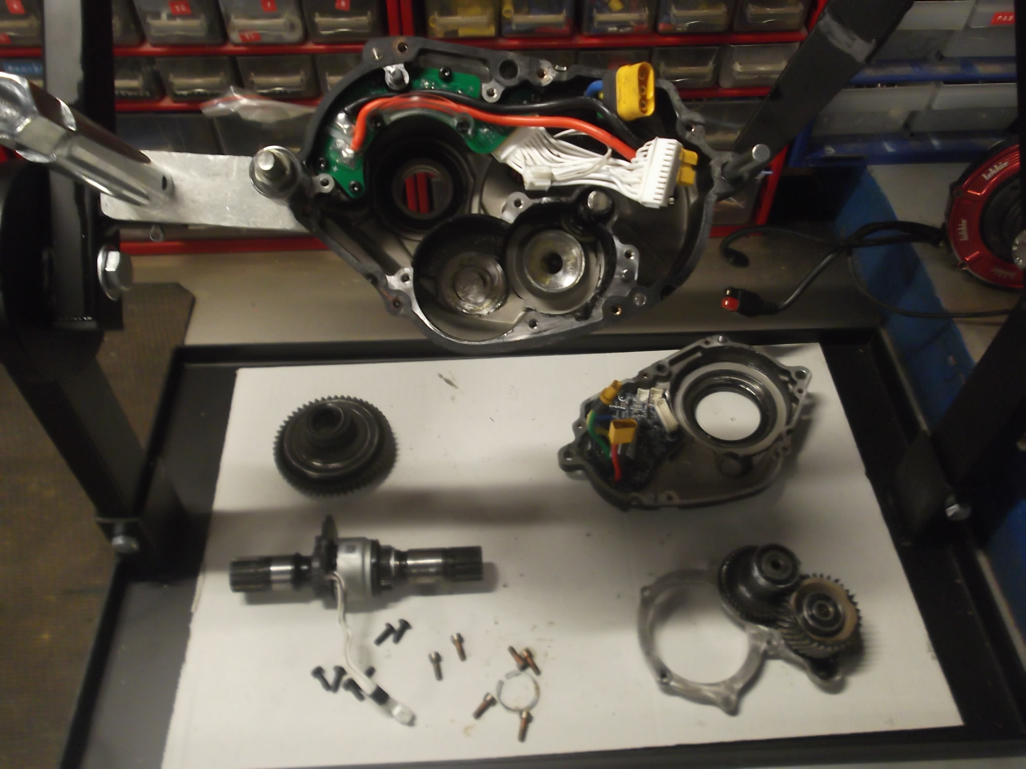

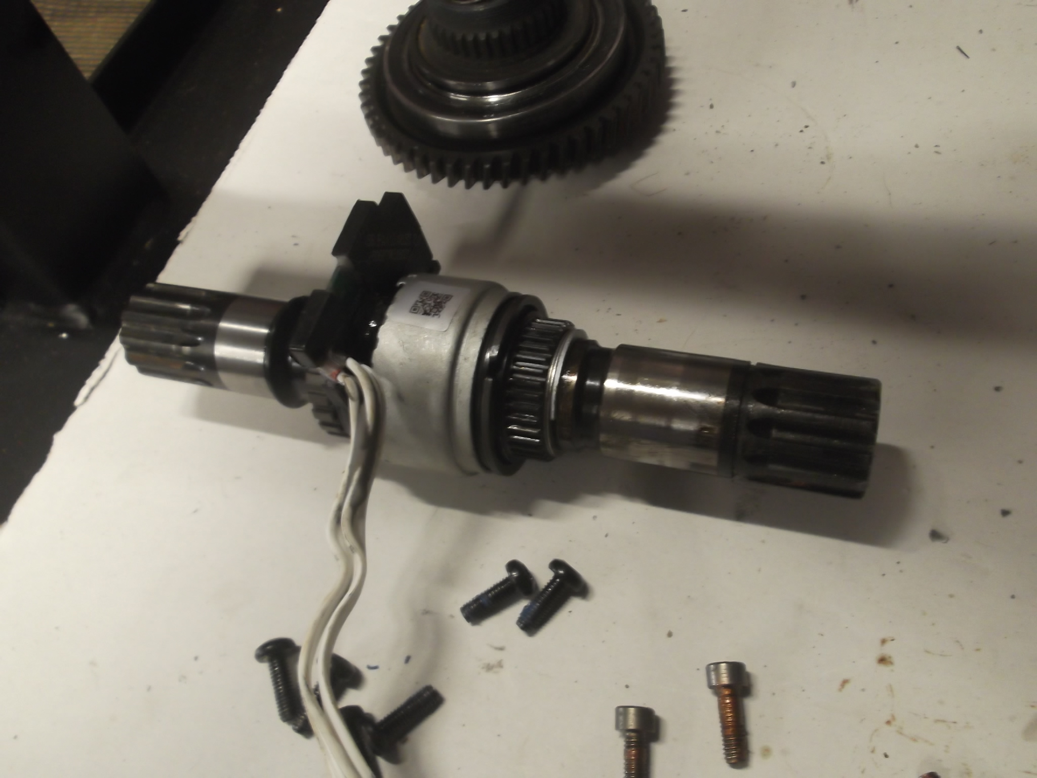

HI. not difficult. for your problem take care before that is not an wiring problem (bad contact). For my case with 3.2 and 3.6 controller software rev it remained only power variations, mostly perceptible at lower crank RPM and/or lower arms torque, mostly when the motor is hot. At dismanteling i have constated that the printed circuit on the torque sensor had a crak (not broken), i think that the prob come from here. in any case solved after torque sensor replacement.
Remove case from controler side (chain ring side) with take care that crank arms axle (the torque sensor) keep in the other crankcase side (leave left crank arm in place). Dismantle the pignons assembly and after you can extract easly the torque sensor, Take care at assembly , it have an protudring printed circuit and it have precise location.

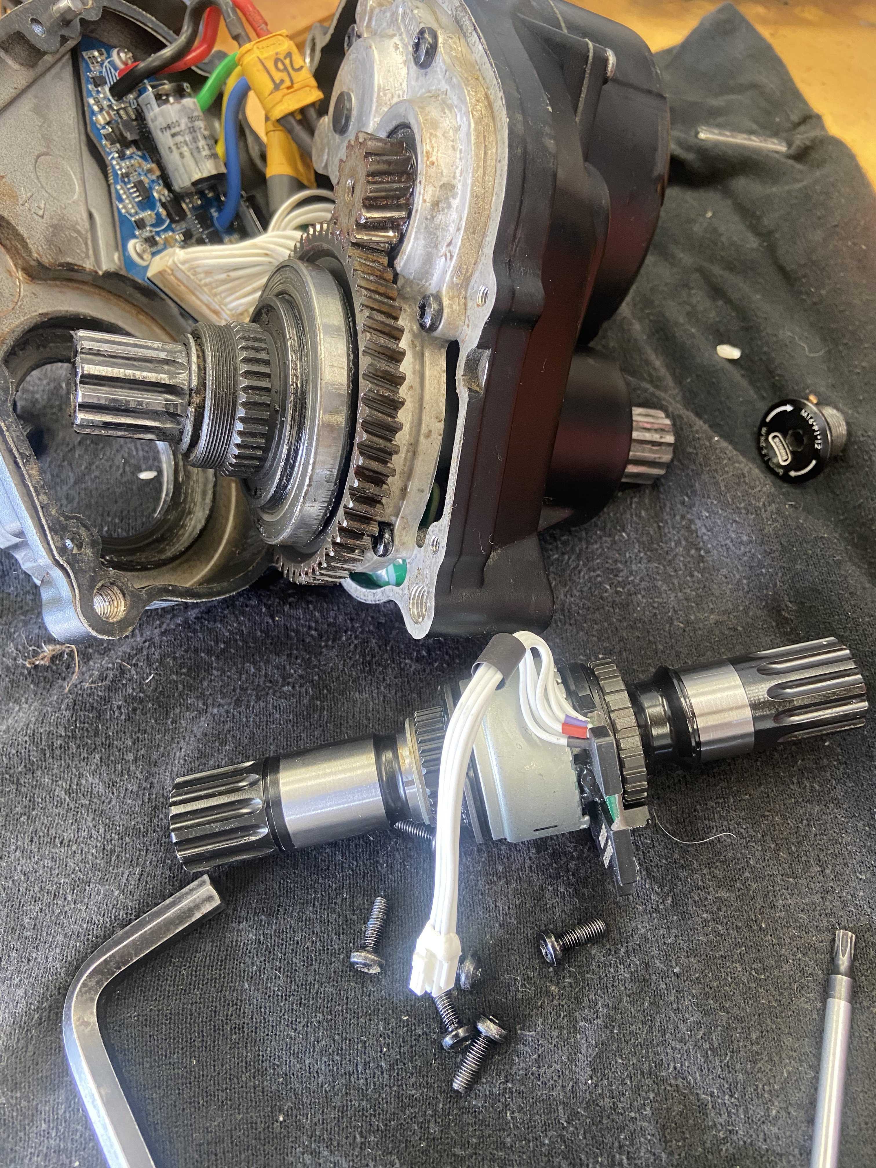

I have replaced the torque sensor and the problem has gone away.
It was a relatively easy job to replace the torque sensor, the M510 motor is much the same as the M600 to strip down, there are plenty of youtube videos on how to do it, the only difference is that the M510 has all the bolts on one side and doesn’t have the separate controler cover.

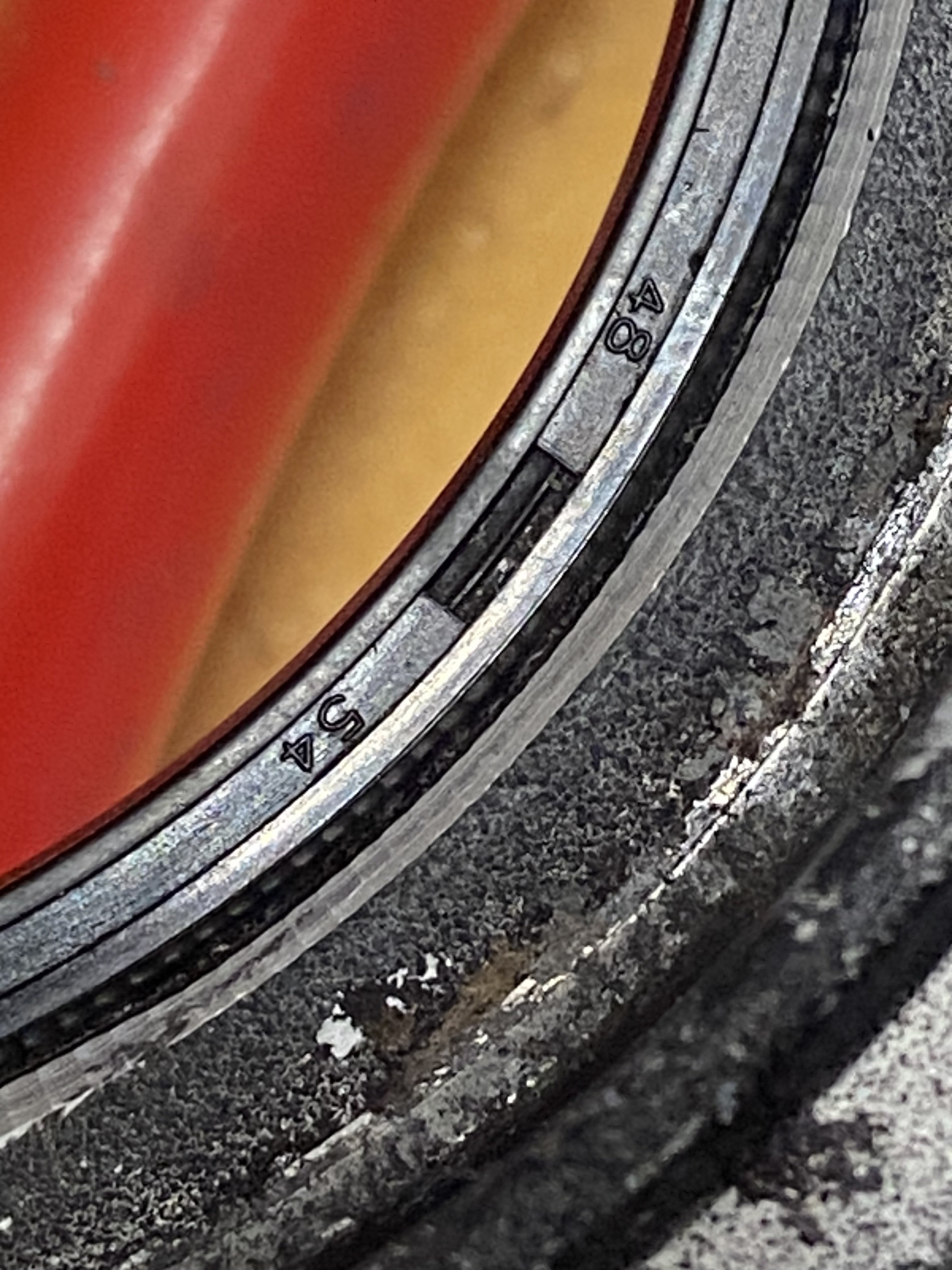

I just received some drive side new oil seals
On inspection the old seals are quite worn on both my M510 and M500, I recommend replacing these seals if opening up your motor as a precaution .
I got mine from here from YIEN EBIKE Store on AliExpress
the seal size is 54 x 40 x 3

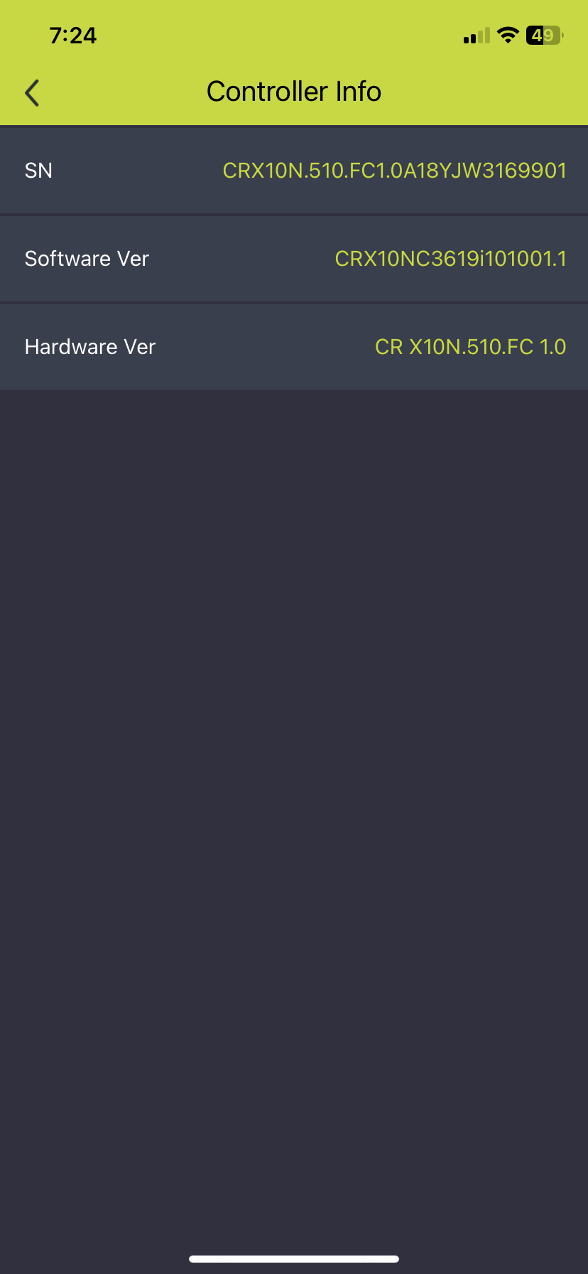

I see u have FC1.0 and fw v1.1, there was 3 revisions of FC1.0. It is hard to tell which FC1.0 u have.
Goff, maybe would be best for you also to swap controller for FC2.0
