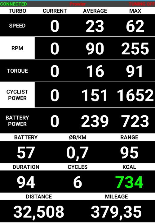

Torque is turning force, not power. It's quite miss leading to advertise these motors with only the torque number.I'm not surprised you are confused. Ep8 85nm and bosch 85nm doesn't feel the same, because torque is not power.
Check my attached image from a gen4 bosch motor. The peak power almost hits 750 watt limit with the advertised 85nm.
IF you are climbing a steep hill under the assistance speed limit in turbo mode, your gen4 bosch motor will draw nearly 750 watt constantly.
