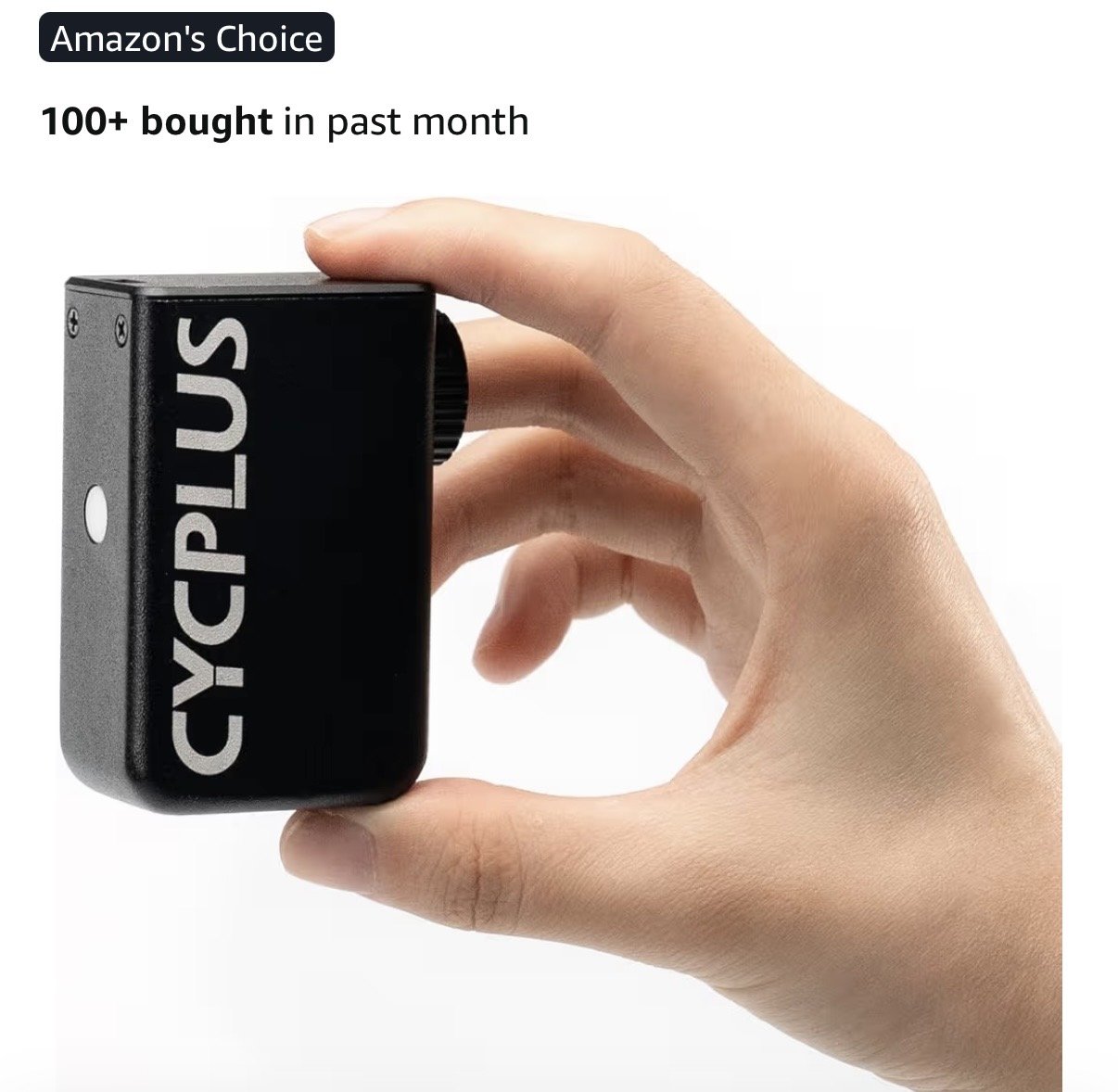

Thanks. Maybe I miss worded what I was looking for. I have a Trek one shot pump for setting beads. I just don’t want to have to manually pump up my tires or hook up my portable compressor I keep in my cars trunk. I just want to find a small battery operated low volume compressor to top off my tires when I have not ridden my rides for a couple of weeks. One Trek has tubes which only lose 5 lbs or so but the other Trek has tubeless and they drop like 12 lbs over a two week layover.
I’ll check some of the Amazon reviews for various battery operated compressors because so much of what they sell is Chinese junk.
I also recently had the Trek store install new tuneless tires and they still seep air over a two week period.
I use Rigid brand cordless tools from Home Depot so I picked up the one they make as I already had the batteries and chargers. If you already have cordless tools, whatever brand will make one. The batteries are the expensive part, so why buy something you already have?

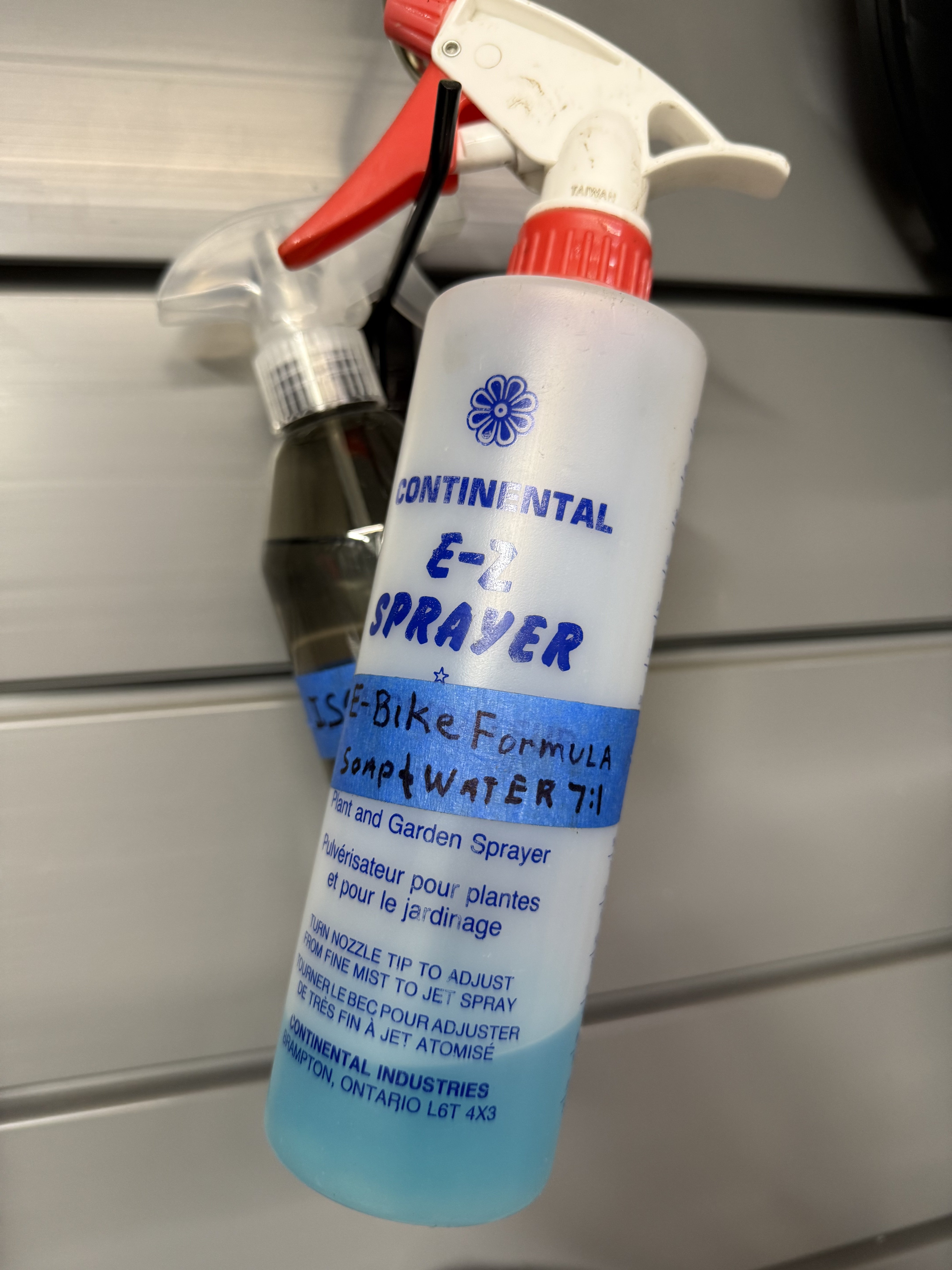

A very slow leak over 2 months is ok. But 2 weeks …not ok. The rim tape could be installed incorrectly. The valve may be loose. The valve core could be loose or failing. Trek sometimes uses a plastic rim insert instead of rim tape and that can fail. Air will escape through the vent holes in the rim.
Spray soap and water on any suspect areas and carefully watch for small bubbles, or a slow large bubble.

I bought the Cycplus AS2 Pro. Works very well, small and light enough to carry with you if needed. Lots of YouTube reviews. Other brands now available too, but the Cycplus seems reliable and well made.

I’ve had this on my wish list for a while…..or the same with a gauge is a bit more expensive.
I also use a Cyclus Pro for the exact same reason as you are asking about

I thoroughly check for psi leaks after a new tire, valve, or sealant with soap and water spray. Whatever happens on the trail is out of my control or operator abuse. 😉
