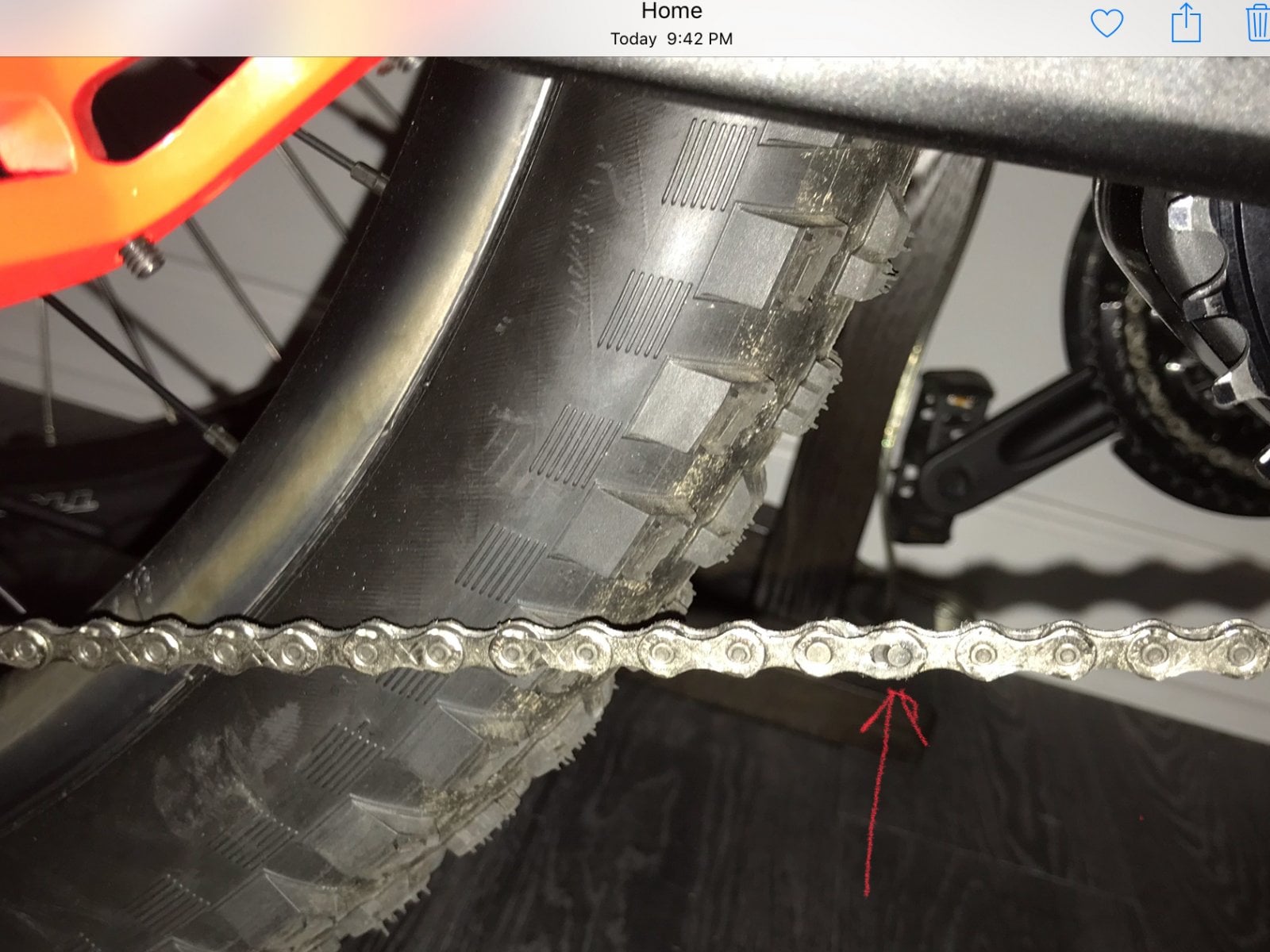

Urge!!! Don’t know if this happened at lbs when they changed the chainring or in my first test ride tonight. I noticed rough down shifts even when I stop pedaling and shift.
Also deristricted it ( BLEvo ???) and went up to 28 mph and yummmy! ?. 15 mins ride on paved relatively flat trail just to see how it feels. I am using 20psi in the tires and lbs also set up tubeless and bike eats up the surface imperfections like a champ. You simply feel small taping telegraphed to your arms but suspension eats everything up so your body doesn’t feel it at all. Intentionally went over raised manholes covers and rutted pitted potholed sections and a road repair area where the pavement been ripped up. It’s smooth as butter except for the crap shifting. Am not all that experienced rider but I think I could feel something like grating in the chain so I inspected it afterwards and see this stretched link (see arrow). Am not sure what I should do as I had a planned group ride in the morning before stores open. But illl go by bike store later see what they suggest. I have a feeling it’s related to going to the 36T anyway. The 36T is a welcome improvement in my pedaling. It’s still no road bike, but it’s a lot better than before. Off-road it won’t matter I go slow anyway, it’s these road sections that I wanted to get a bit more speed on.
Anyone with suggestions / advice please welcome to reply, love the Levo!

That's your chain masterlink - it looks fine to me. You will need to adjust your B tension screw; your LBS would have likely used the same stock chain when they did the 36T change - which is fine - but you need to remove the [slighly] increased chain tension with the mech B tension screw to get back to crisp shifting.
Tori, couldn’t thank you enough. You are really helping us clueless noobs a lot. Now if I may ask why the master link looks like that? And by the way I had to google and then watch video of what you said and will do it in the morning before the ride. Infact thanks for easing my anxiety and saving me a trip to the LBS. it’s a 30 min drive for me and I was already contemplating if or not I should go to any other bike store even though they don’t deal with ebike they’d be able to take care of it.

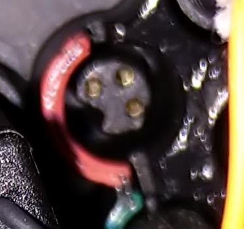

So, I thought I'd come up with a solution for a rear light for the Levo.
Bought the Light & Motion Tuck, which should work in the 6 - 18 V range AND has an integrated switch to turn it on/off.
Acquired a Brose connection cable for rear light from Supernova.
Took off the crank arm, unscrewed the bolts for the motor cover, pulled the blind plug for the rear light connector... and discovered that it needs 3 sprongs on the plug of the connection cable.
The cable I bought only has 2, and a different layout on connector head.
First attached photo, the connector on the motor.
Second photo: the connector on the connection cable.
Also, there are small nubs on the outside of the connector on the cable, that needs to mount into the grooves on the motor connector, seen at 11:00 and 5:00 on the top photo.
Has anyone fitted a rear light to the 2019 and know where I can get the correct connection cable ?

Asked Supernova and this is their reply:
"Unfortunately Brose changed its light ports for 2019.
The cables we sell are compatible for all Brose engines up to model year 2018.
We don´t have any cables yet for the latest version of Broses engines."
