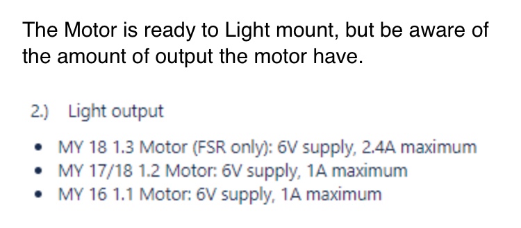

I got answer from Specialized:
So, i have Levo HT. It has 1.2(?) motor, so the current is only 1A at light output. Fsr has 1.3 motor and 2.4A. So there’s no point to me install Lupine?
Exposures can stay for awhile, until i have FSR.
Even at 2.4A it's very limited.

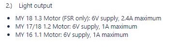

Information for people who have 1.2 motor:
I asked from Lupine does SL work with 1A current:
So, i stick my old Exposure Sixpack then, i have 2018 Levo HT, it has 1.2 motor. :rolleyes:
