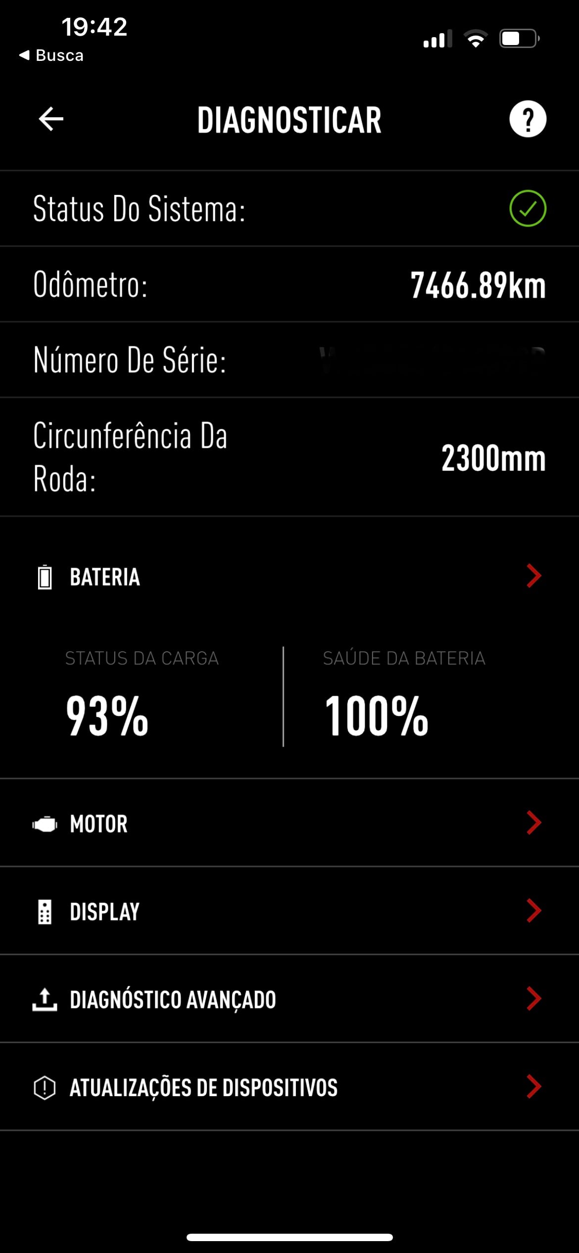

2021 SL Carbon
Ride all year long, 3 to 4 times a week, typical ride 25/30km, 1000m elevation using mostly trail mode, hard trails with a lot of rocks and dust, in the wet season small river crossing, this bike likes water.
Almost 7500km
Engine and battery 100%
Rear suspension rebuild 2x
Front suspension rebuild 1x
Dropper gone, did not find the fusion cartridge replacement, changed for a similar model
TCU changed once and its battery changed recently
Power control just changed
