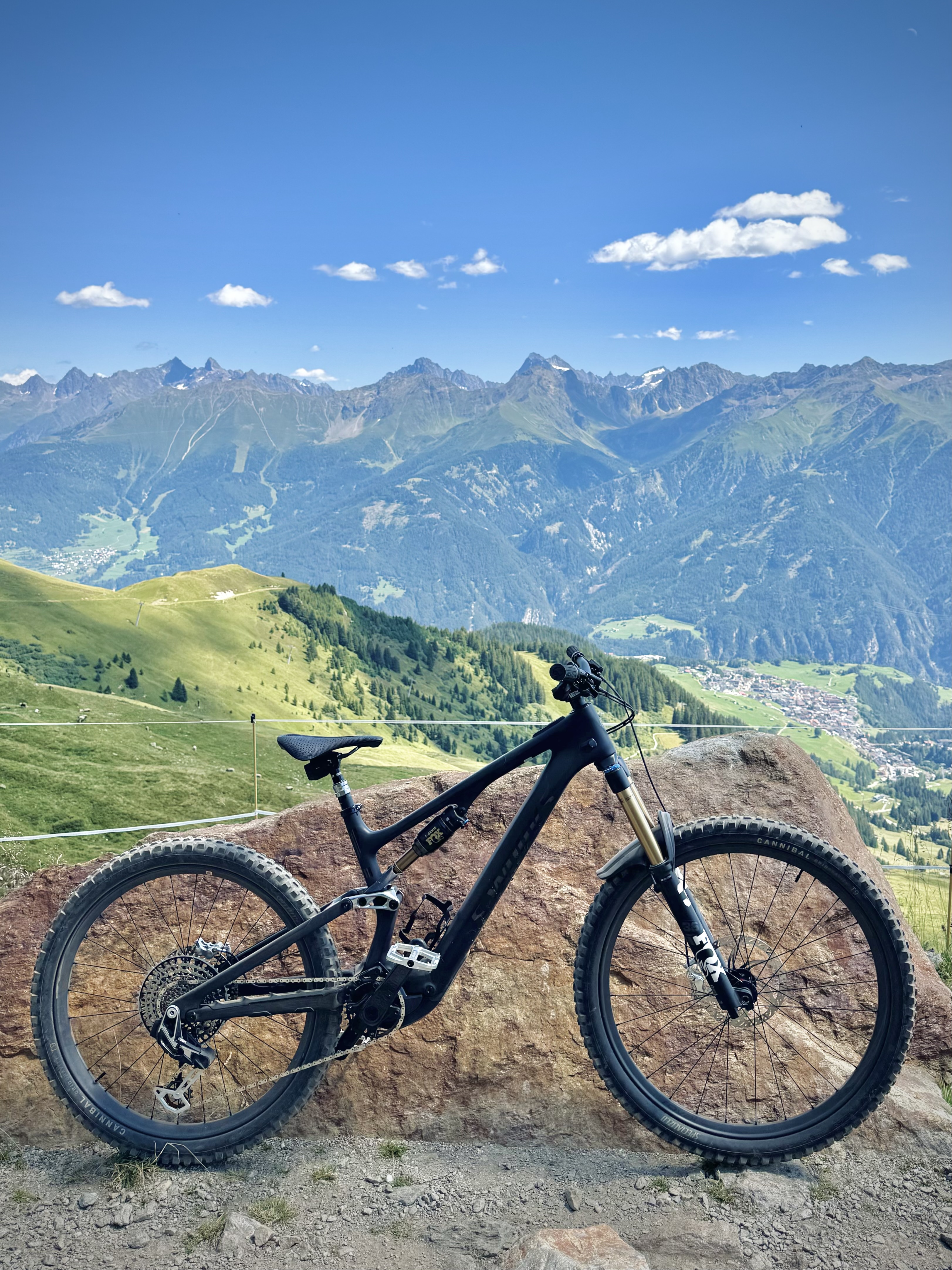

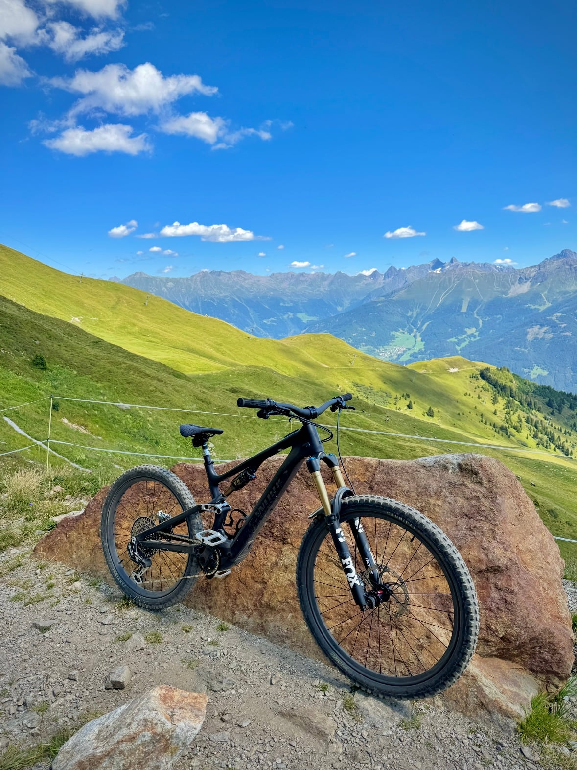

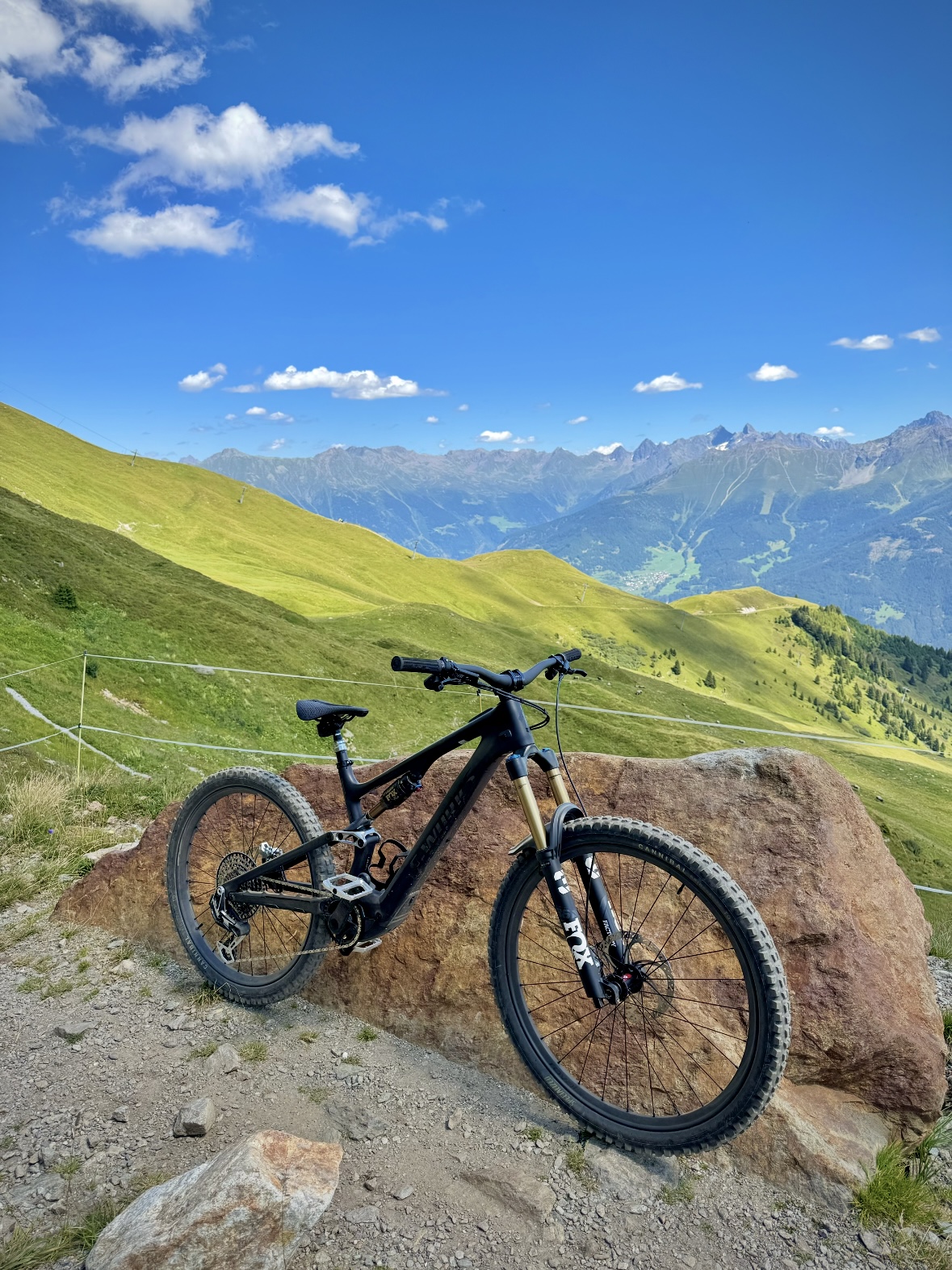

I have both the Cascade link and the Cane Creek Tigon coil over shock - each changed the way the rear end feels and behaves. I had the cascade link months before the shock and it gives you a bit more travel (160mm) and an increase in progression which you can notice. The shock takes it to the next level! I just recently put on the new Fox 38 fork with 170mm and now this thing rocks downhill sections like a champ! I'm running as a full 29er with and have made a few changes to stock. The Maven brakes are also IMO an excellent upgrade.
(I also have Cascade's link on my Stumpjumper EVO)
do you have the fork in the steepest setting?

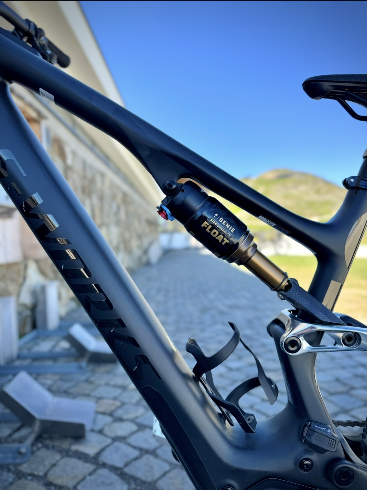

Hi, does anyone know how many volume reducers come pre-installed with the Levo SL? I just got one and want to shockwiz tune it without opening the shock and fork. Thanks!
My Fox 34 Rhythm on my 2021 Levo SL (XL frame size) came stock without any volume spacers installed.
  • Like
Reactions: ah1
My 2022/23 gen 1 SL came with the light blue volume spacer in the rear shock.
And 2 volume spacers in the Fox 36 fork.

OK reporting back: on the s-works, the shock comes with a 0.2 volume reducer already installed.
