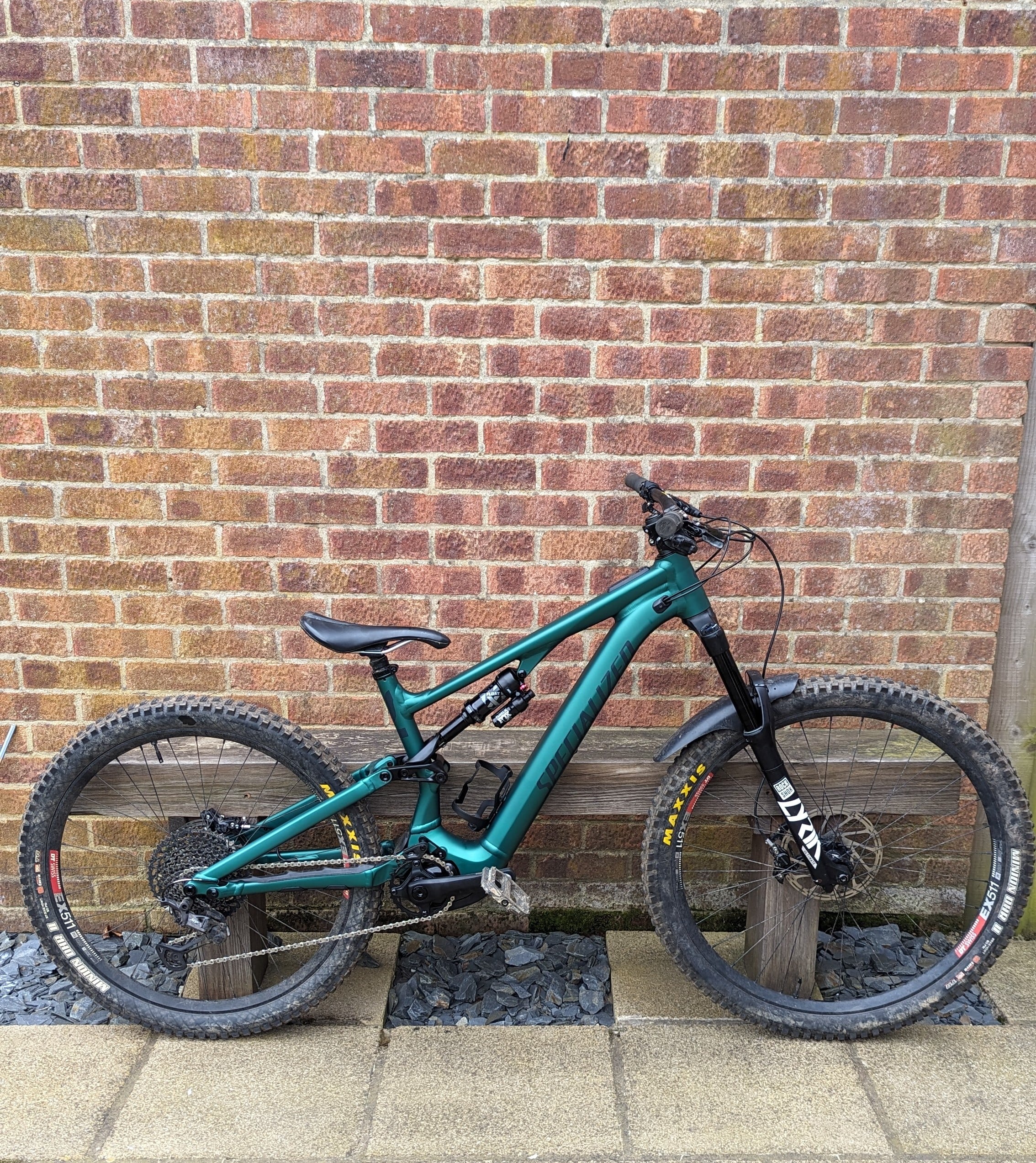

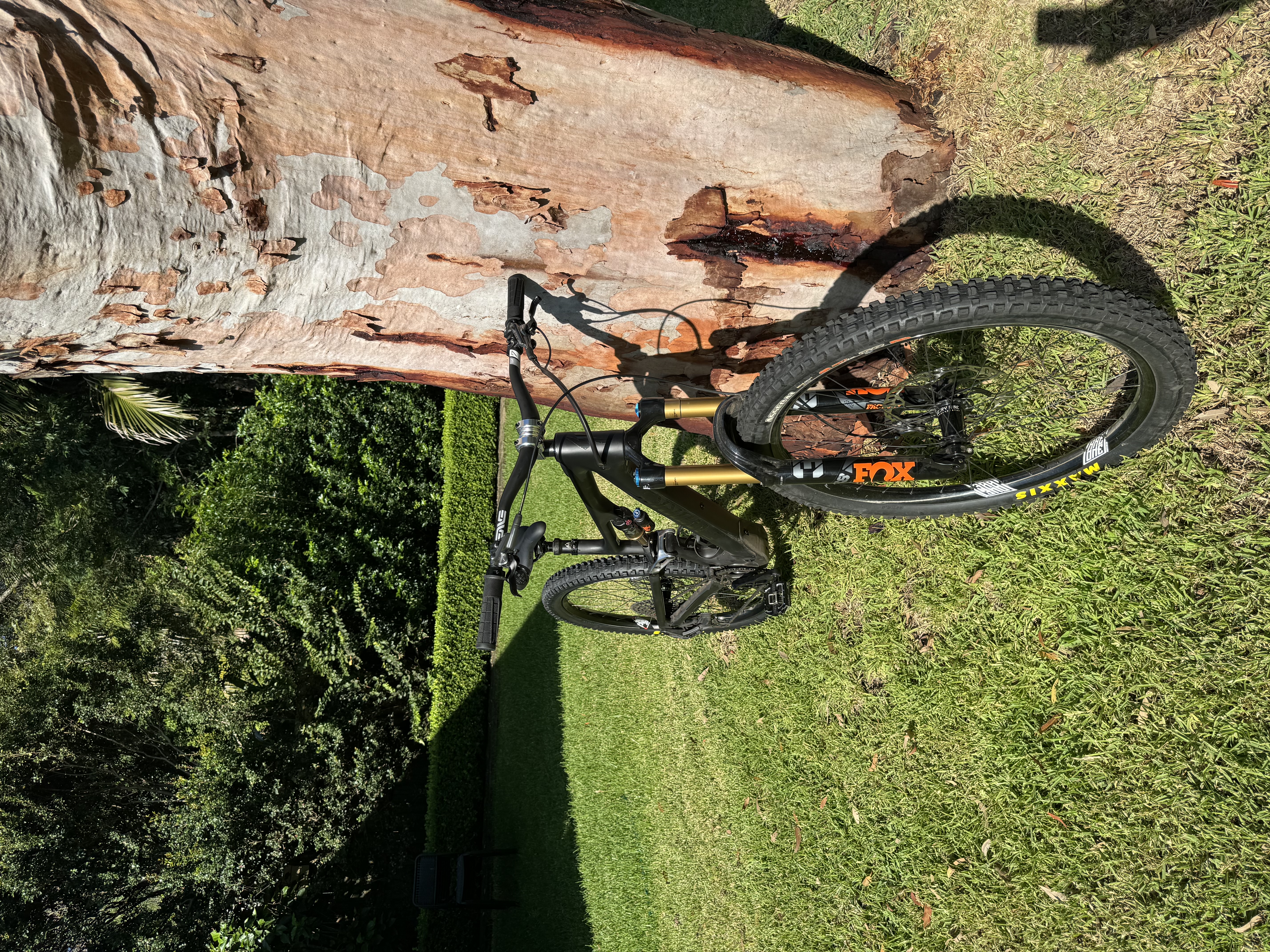

My Levo SL gen 2 in S5
- S-Works frameset build
- We Are One Convergence 29” rims on I9 Hydra hubs
- 5Dev 160mm cranks
- Enve M7 carbon bars
- XTR brakes, 223/203mm Galfer rotors
- PNW 200mm Loam seatpost, WTB Volt saddle
- Assegai DD 2.6” front, DHR Exo+ 2.4” rear
- Fox Factory 38 @ 170mm
- Crankbrothers Mallet DH pedals
- Stock shock
- XO Transmission drivetrain
This comes in at 19.47kg. This is as light as I am prepared to go without sacrificing capability - not going to be chasing weight down.
Slightly heavier than expected, but I’m extremely happy with it. Only 2.5kg more than my analogue enduro bike.
So good!
View attachment 136609 View attachment 136610
Strange to see DD up front and Exo+ on back. I normally run heavier casing on rear on my eeb. Lovely looking bike!

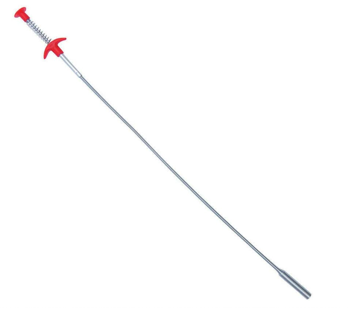

Swapping dropperpost today and I accidently pulled my dropper housing too much and now I can't push it back up the seat tube. Do I really have to drop the motor to fish it back up the seat tube?
Try this long armed grabber pickup tool. Has saved my ass many times. You can probably find it in most hardware stores.
Thanks for the idea. I ended up just pulling the dropper cable housing as much as I could down the downtube. With the bash guard removed I could kind of see the inside of the seat tube. So I carefully shoved the housing back up towards the seat tube and it went inside. Got lucky I guess.

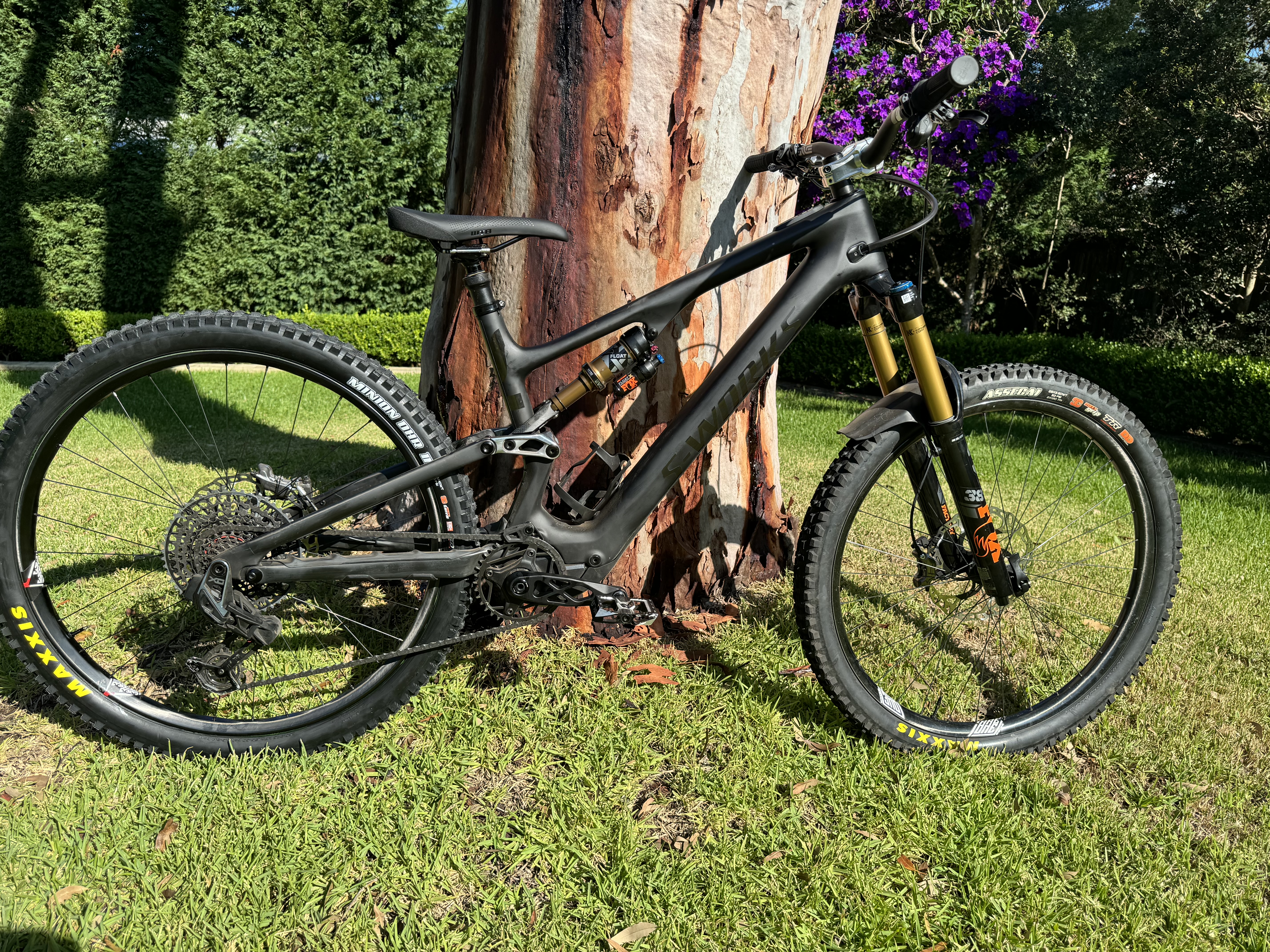

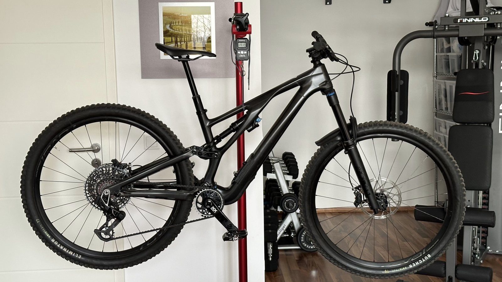

Took delivery of a levo SL alloy today S4, stripped down to the frame and rebuilt with parts I already had. Knocked 1kg off the standard build weight.
I'm booked for a weekend of uplifts, dirt farm and bike park Wales. I was going to take the non e, but I'm considering taking this instead now!
