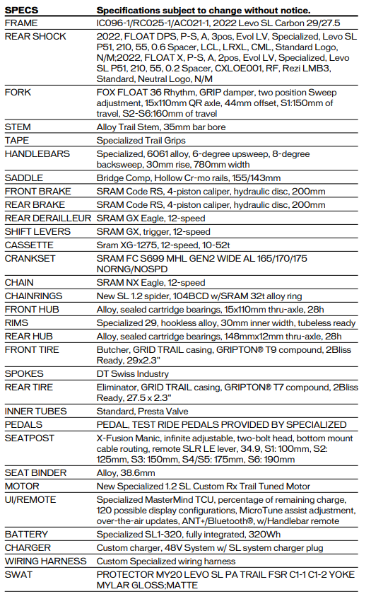

Must be ok to share this as it's still visible on the net for all to see :
Forks are 44mm offset.
Suspension for anyone getting ready to swap it out straight away :
S-Works LTD : FORK All New Lyrik Ultimate Flight Attendant, 29", 160mm of travel, wirelessly controlled damping. REAR SHOCK Rockshox Flight Attendant SuperDeluxe Ultimate, 210x55
S-Works : FORK Fox 36 Factory, 29", 44mm offset, Grip 2 damper, Kashima, 160mm (Think the S1 is 150mm). REAR SHOCK S2-S6: Fox Float X Factory series, Kashima, 21x55mm, S1: Fox Float DPS Factory, Kashima, 210x50mm
Pro : (Not sure this is 100%)FORK Fox 36 Factory, 29", 44mm offset, Grip 2 damper, Kashima, S1: 150mm. REAR SHOCK S2-S6: Fox Float X Factory series, Kashima, 21x55mm, S1: Fox Float DPS Factory, Kashima, 210x50mm - has the carbon shock extension.
Comp Carbon : FORK Fox 36 Rhythm, 29", 44mm offset, Grip damper, S1: 150mm, S2-S6: 160mm travel . REAR SHOCK S2-S6: Fox Float X Performance series, 21x55mm
Hard Tail - has no rear shock :-) Frameset - no forks or shock .......
Expert and Alloy models to follow.

Thought I noticed when I could still see the specs on my phone for like 2 hours that the dropper is now a 30.9mm. Surely for clearance.
** Corrected. The Levo SL does in fact use a 34.9mm inner seat tube diameter.

It's relevant as Spesh had been pushing for 34.9s on everything. It also means none of the 3 high end droppers I have would work on a new Levo SL frame.
according to the leaked spec sheet (and leaked specialized website), a 34.9mm dropper will still be used. i thought it would’ve been weird to backtrack. see below:

All the Levo SL’s frames so far have had a 34.9 opening… just the S-Works builds have a 30.9 AXS dropper with a shim.
I suspect this will be the same, and it’s a weight saving exercise. The 30.9 AXS dropper is fractionally lighter than the equivalent 34.9 one.

More than a fraction I suspect. First thing I did with my SL was replace the 150mm dropper it came with with a Oneup 180mm 31.6mm and a home-made shim. Gained 30mm of drop and saved over 100g. 34.9 inch size seems like an appropriate choice for larger sizes where you might well expect a 200+ lb rider with 220mm of drop, but completely inappropriate on a medium that can only just fit a 180mm.
Just googled this - and found that a 31.6mm 170mm AXS dropper with battery and remote is 768g.
I have a photo of my 34.9 one on the scales when I got it - along with battery and remote - 879g.
111g saving - minus whatever the weight of the shim is.

I have my current SL that came with Fox dropper and shim and I will tell you it's not worth the weight savings. My buddy has a Levo Expert with a shim from the factory as well and they both develop creaking from the shim and require frequent cleaning to keep them silent.
On my SJEvo (also uses a 34.9mm seat tube) I settled on the KSLev Integra 31.9 x 200mm dropper (I'm 5'11") as the right combo of lots of drop, light weight & good functionality. I could actually have fit a 210mm Oneup but I really dislike how those feel, and they are heavier.
As I recall the shim weighed about 38 grams.
That dropper weighs 612 grams (includes the remote and cable, which isn't how anyone else weighs them).
For comparison the same dropper but in a 34.9mm diameter weighs 712 grams.
The biggest issue with the 34.9mm droppers is that they don't insert as far because at the bottom their extra width will contact something whereas the narrower droppers can often go a lot more, like another 20+ mm further in.
I've never experienced any sort of creaking or anything as a result of my 31.9mm + shim.
Another data point is that on my Spur I have a 31.6mm x 175mm KS Lev Ci, and that thing weighs 459 grams for just the post. * KS adds 40 grams to all of their weighs for the remote and cable, no one else does this.
You could literally save 380 grams located up high, hundreds of dollars & have another 5mm drop over the 34.9 AXS dropper. I just don't get that thing.
Done nearly 1000 miles on mine, all quite tough rough terrain and no creaking at all, I'd say it's definitely worth it and probably worth it for you to see if you can get a better shim.
