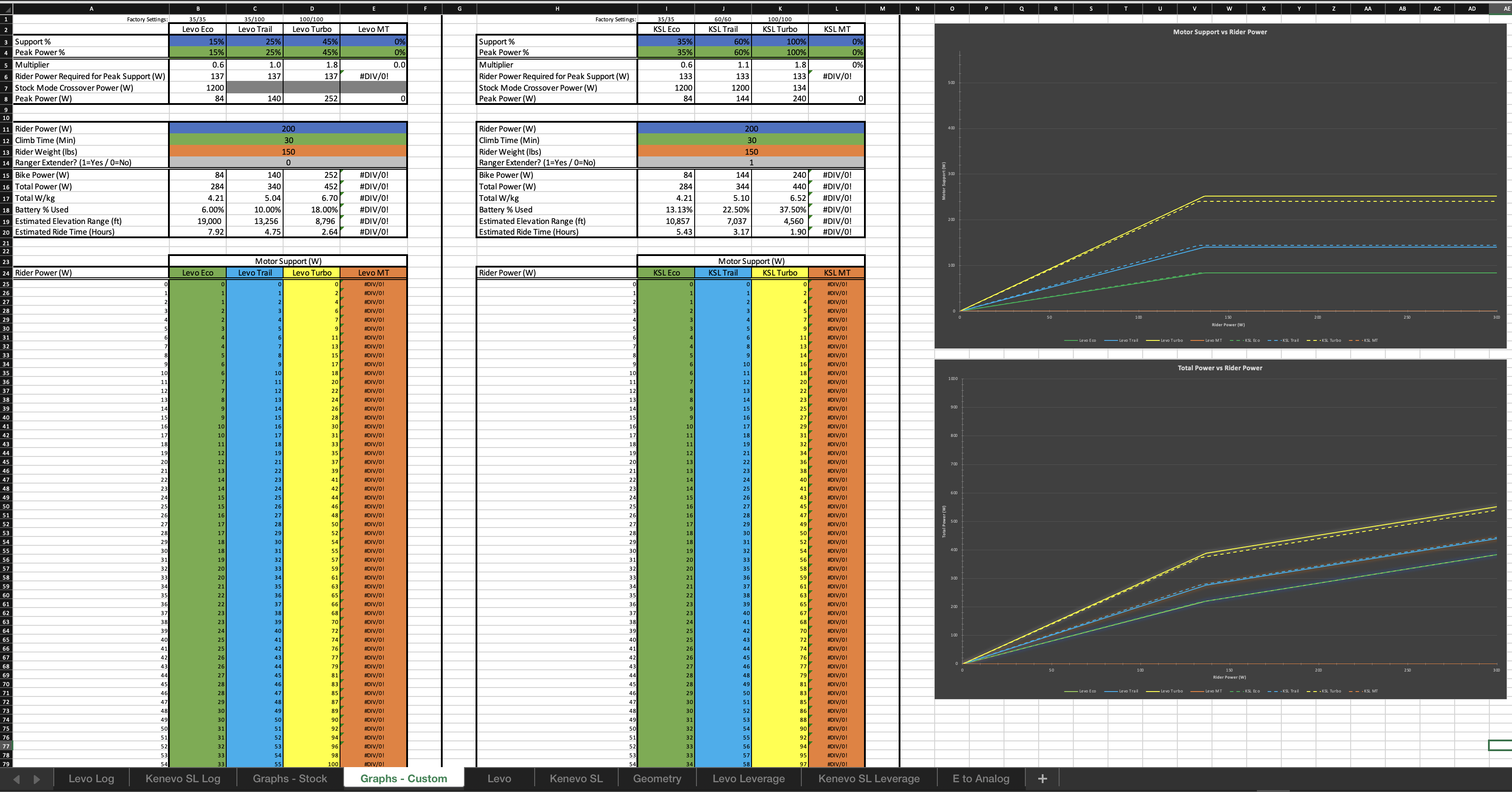

I made a power calculator in Excel to play with different settings, since I have both the Levo and KSL. The closest Levo power settings to match the stock KSL settings (power only, not accounting for weight) would be 15/15, 25/25/, and 45/45:
