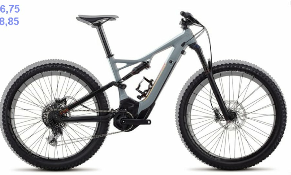

From the data sheet of the 2021 Revelation model the fork length difference axle to crown between the 29" and 27.5" is 19mm.
Radius difference between the 29" and 27.5" wheel is 18mm.
So total 37mm difference.
Yes, the front may be 37mm higher, but keep in mind that the rear is also 18mm higher (radius diff. 29" and 27,5")
And the head angles (OEM ST: 67.4° - FSR: 66.1°) show that the front of the ST is lower
btw, the head angles are from the specialized site (and make sense...)

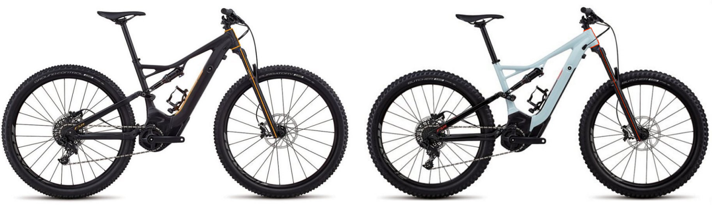

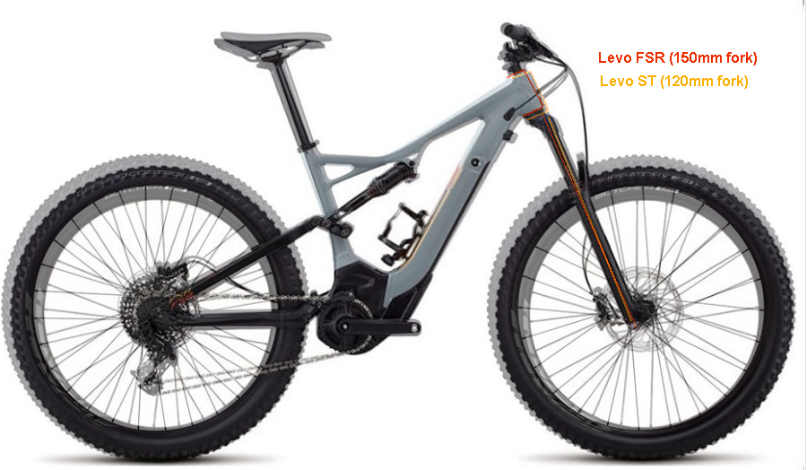

Here you can see that the ST with 120mm fork is lower in the front:
rather complex subject, I know ;-)
and to answer the question of the first post, due to the length of the casting a 160mm fork will cause a flatter head angle, but a 140mm fork will provide almost the same head angle as a "normal" Levo.
I did a lot of research when I bought my Levo ST, believe it or not...
