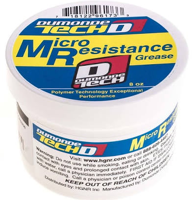

From time to time we get bikes with internal headsets in the shop for creaking. We will often replace the bearings after cleaning all contact points thoroughly. We will also apply a thin layer of Dumond Tech Micro Resistance grease to all contact points
We then reassemble the headset and make sure to use correct torque specifications for the stem with a torque wrench. That takes care of it 99% of the time.
