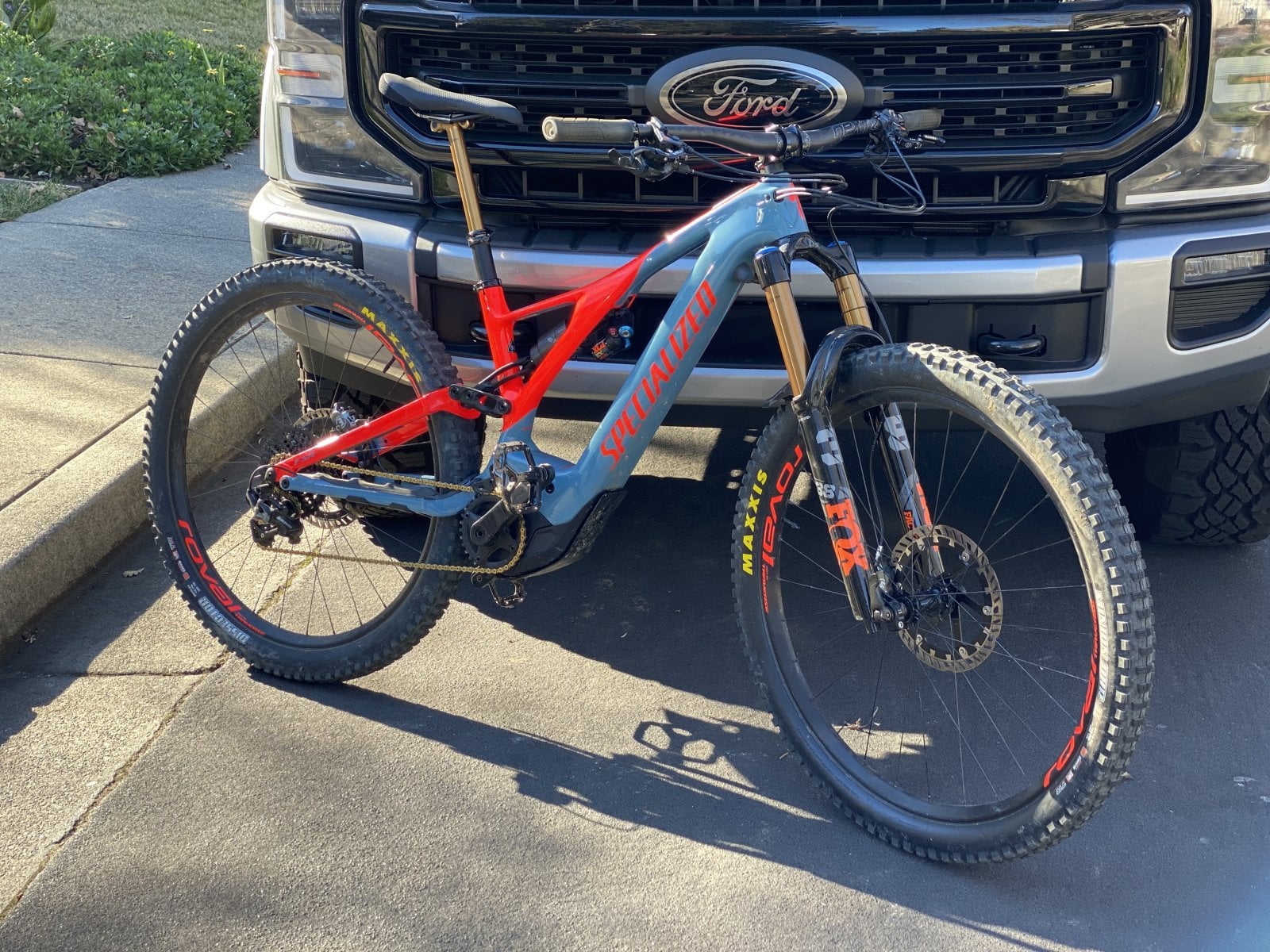

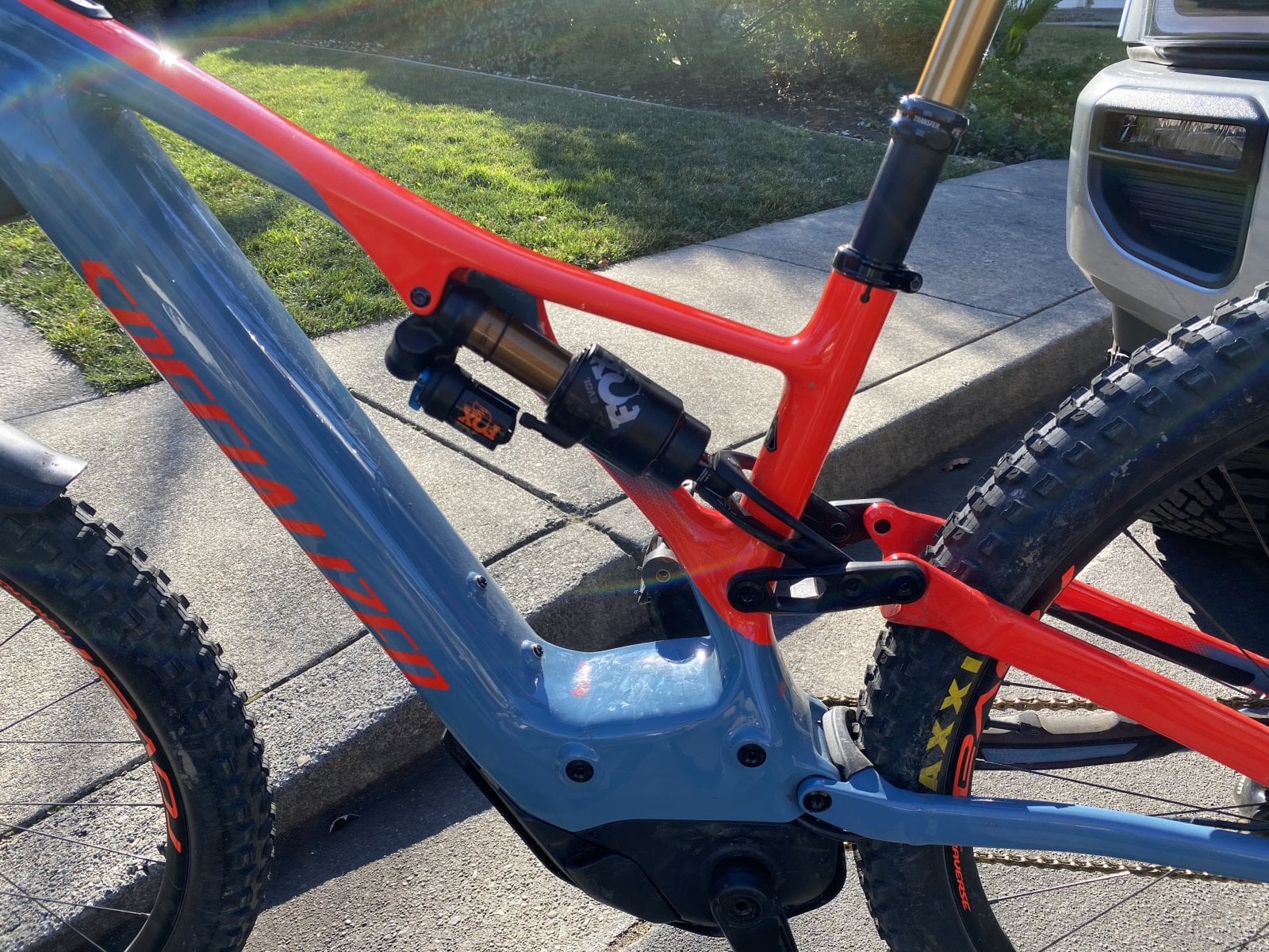

Steering tube will definitely need to be cut down. Did the 38 (51mm), Float X2 and Transfer on my 2019 Expert. Also just swapped out the Code R brakes for Magura MT7 (220mm). Love the full setup

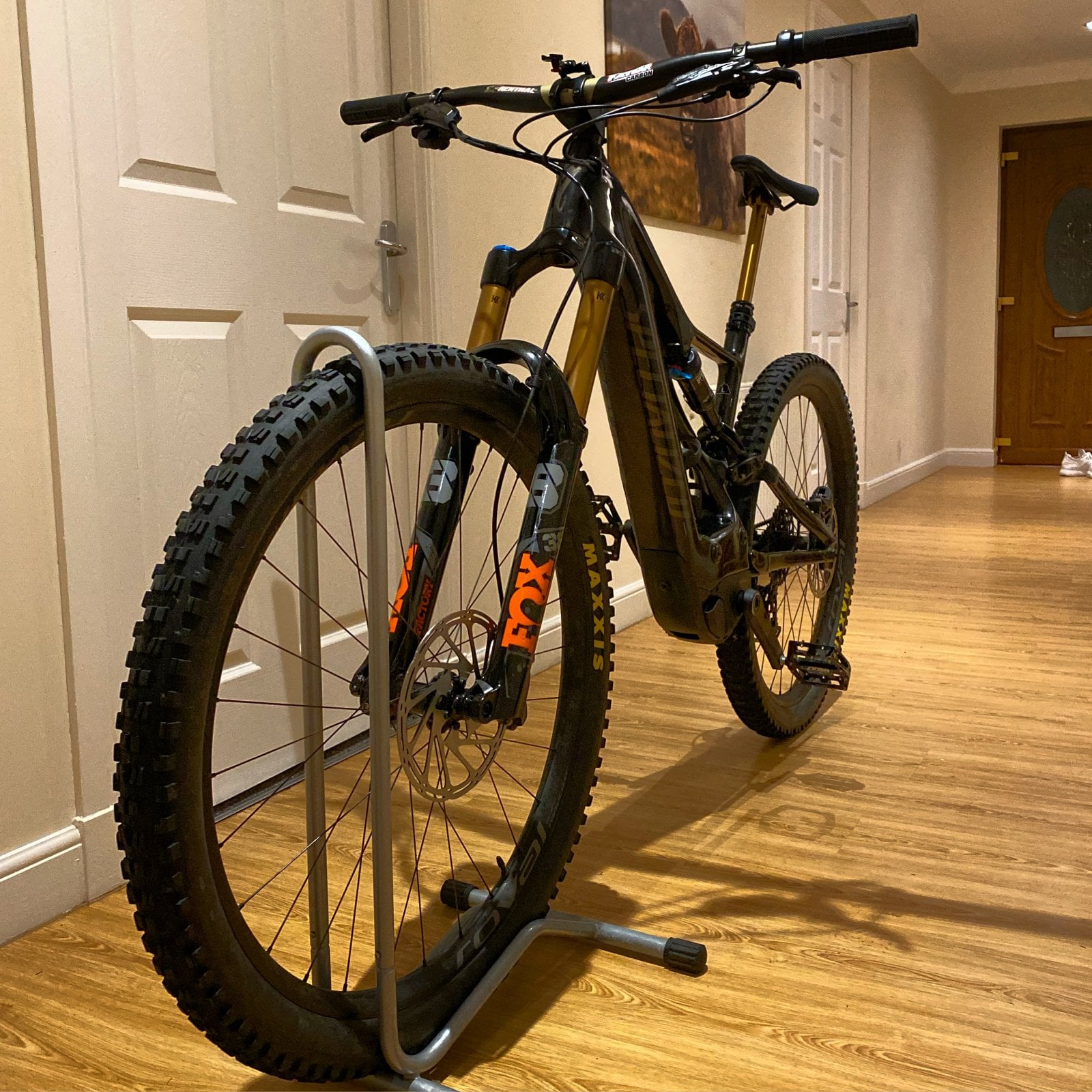

Wanted to stick to with the standard spec. Figure the Specialized engineers know this stuff way better than I do! Will take a couple of pics later today. Have been meaning to add to the 'modified levo' thread
That was my thinking intially, but increasing travel to me puts the front wheel out and i was concered about slower steering so went 44 to bring wheel back a bit. But i went for 170mm travel.
Forks were meant to arrive yesterday but they didnt. so coming monday now :(

Why did you go for 51 offset? I would be intrested to see pics of your bike! exactly the setup im going for!
