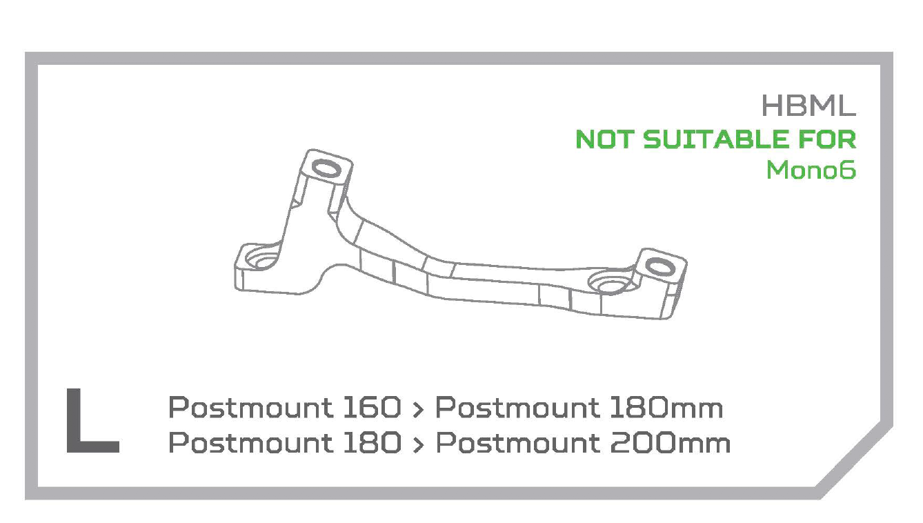

Hope HBML is listed in their documentation as
Postmount 160 > Postmount 180mm
Postmount 180 > Postmount 200mm
Presumably, that should be two completely different parts or is my brain not working correctly?

So, basically, HBML will be the correct size for 200mm rotors on my 180 post mounts front and rear.
...and, finally. will I need these adaptors or will the stock ones already fitted work as they convert from 180 - 200 already, albeit with different calipers?

Yes, stock adapter is PM 20mm, so it converts PM 180 to 200 so I think your current adapter should fit just fine, of course if you stick to 200mm rotors ...
