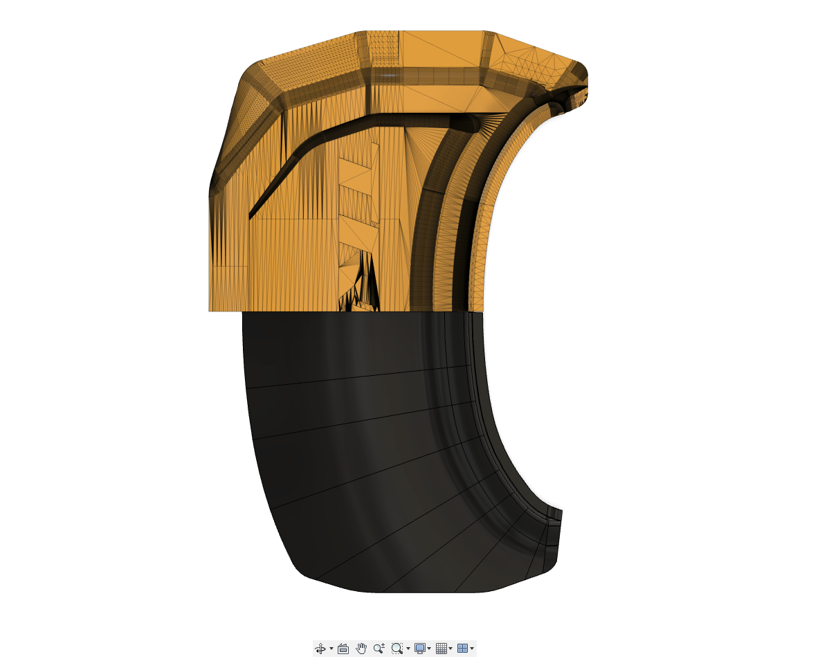

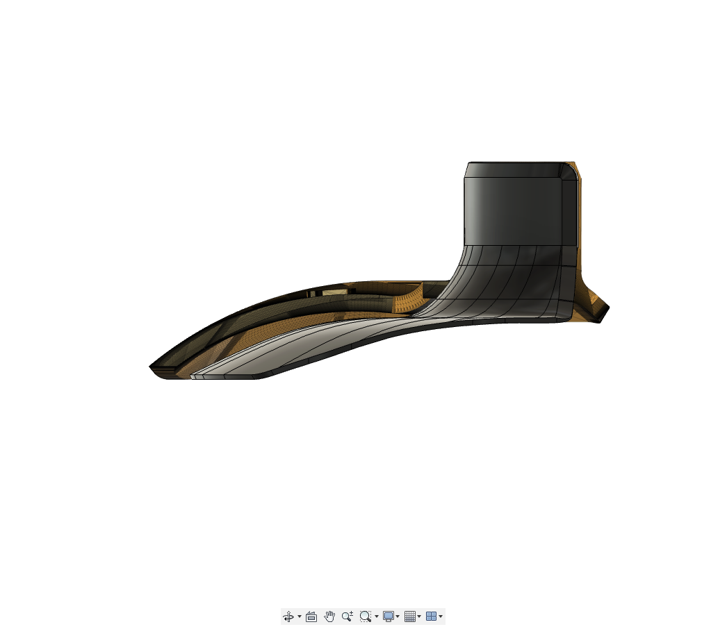

Hi Everyone,
First time poster here, but I've been around for a while. I actually created the mudguard on Shapeways that I've seen a lot of people post up. Since Shapeways recently closed their doors, I'm currently shopping for a new printer, which is why I figured I'd revamp the previous design and try to come out with something a little more organic looking as well as release all of the newer model Rail guards.
The main reason for this post is I wanted to ask you all, what did you like and what did you not like with regards to the previous design? Or if you don't have one, what is something you wished for?
I will be removing the Trek logo on the future design. Wish I could keep it, but I don't want to get into a copyright war with Trek.
Anyways, I'll post up progress and a HUGE THANK YOU to everyone that has supported me. It's been amazing running into these things on the Trails. Unfortunately I gave my last one away so I need a new one asap myself.
-JD

That looks cool as a standalone object, but on the bike, it’s not nearly as discreet as I’d like. Can you make the plastic much thinner, especially where it attaches to the frame. This design looks like it will hold dirt too. Something much closer to guards that manufacturers use would make more sense to me.

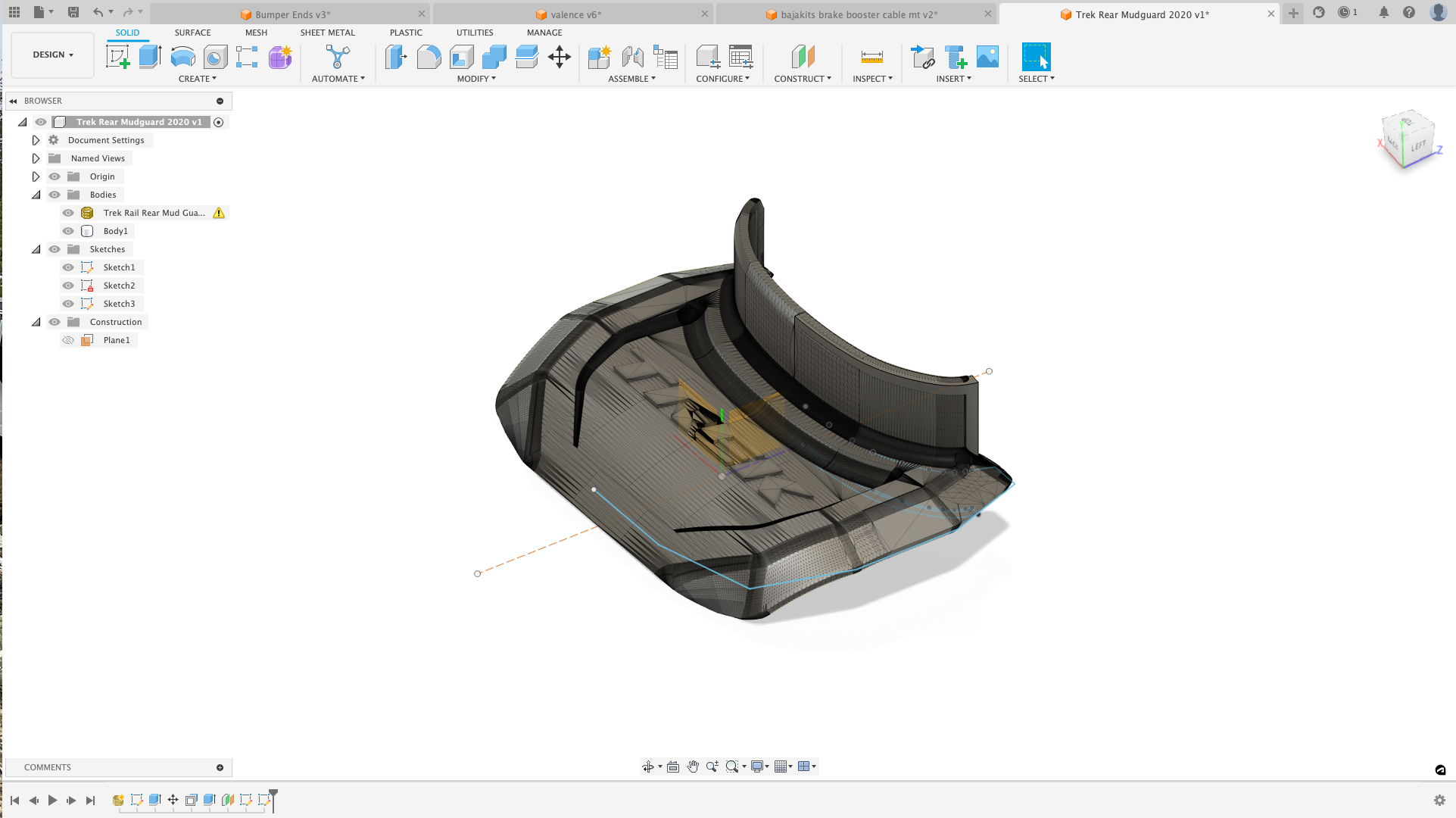

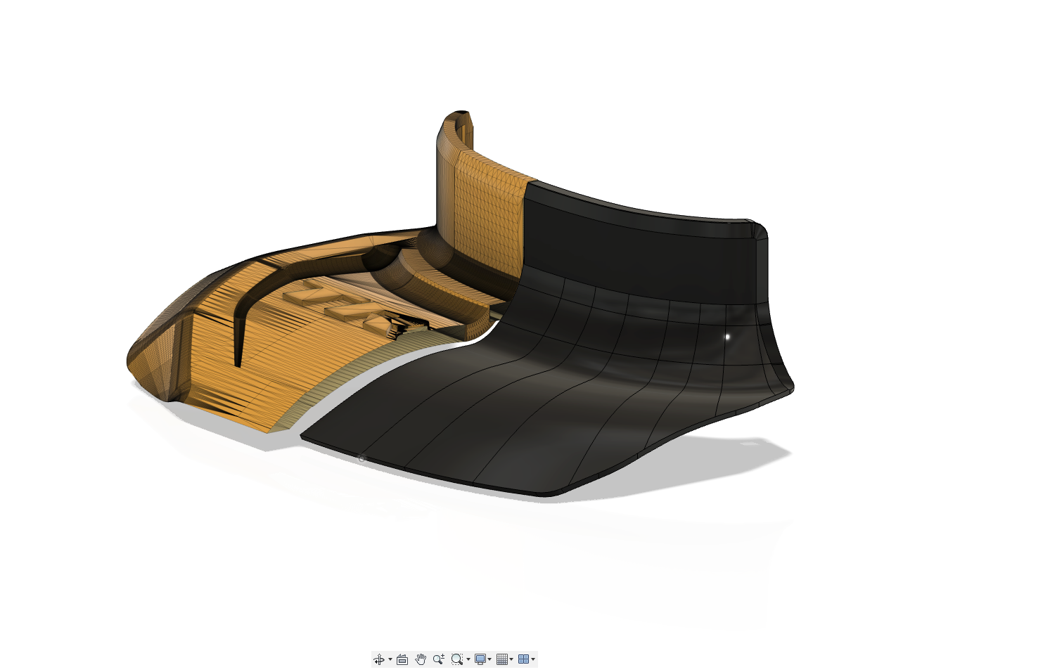

Thanks! yea that's what I was hoping for with the next iteration. Something a little more organic shaped that flows with the shape of the frame. Unfortunately the way the frame is designed it kind of creates a shelf.

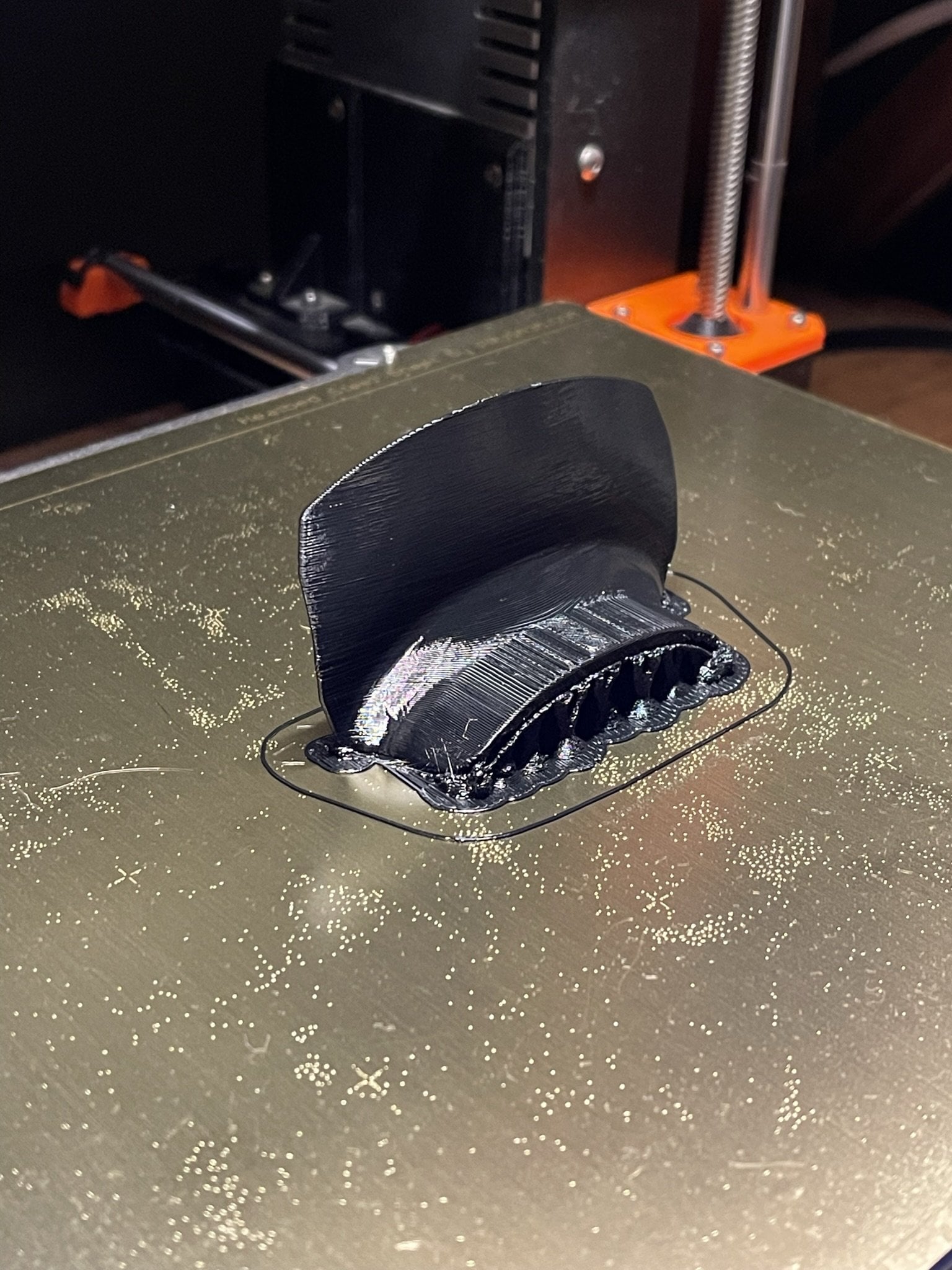

Screenshot 2024-08-31 at 12.38.53 PM.png Screenshot 2024-08-31 at 12.39.23 PM.png Screenshot 2024-08-31 at 12.39.37 PM.png

ah I get it. However, I'm not designing a rear tire mudguard to protect the rider from overspray. My design is mainly to avoid damaging the rear triangle pivot point. It's worked great for 4 years now.

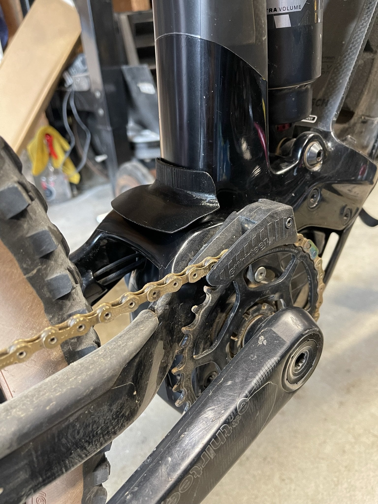

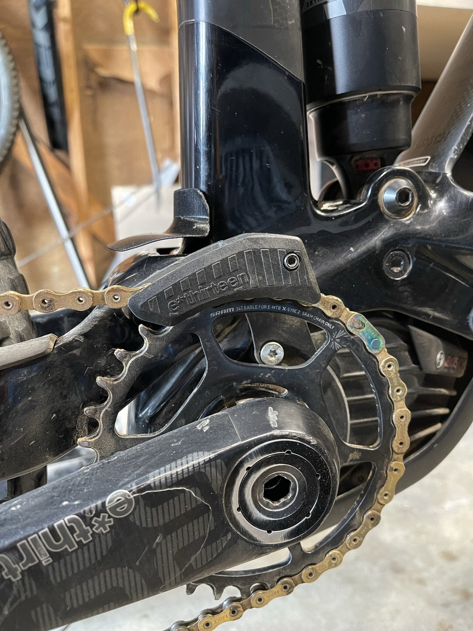

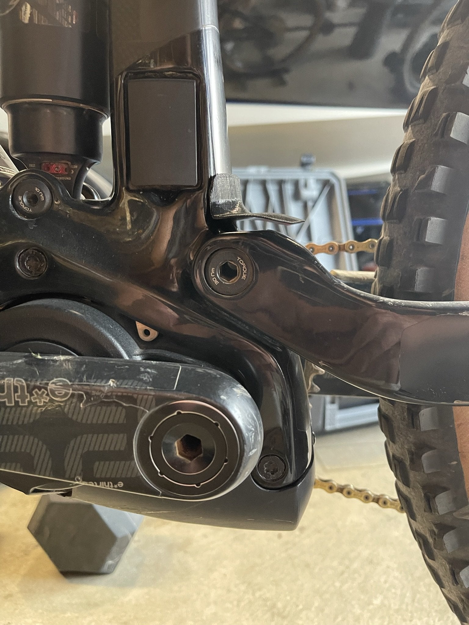

Well, the “flap” showed up today and it’s a very nicely done flap made out of TPU. Not sure that they were designed with VPPs in mind but I'm game to see if I can fit it to cover up the rear shock mount to the linkage.

Let me save everyone some time and money.
Trek 2023 Fuel EXe Carbon Main Pivot Mud Flap​
SKU# W5275234 MSRP $5.99
Using diagonal cutters you trim the nub flat (below flap) and tab going across from the top of the mount hole (above flap). Then attach to the seat tube on a Rail above the main pivot using strong double-sided tape (I used 3M brand and has held for over 1 year and 1,200 miles of aggressive riding). I bought two when I built my 9.8 in case it fell off, so I will try to post a picture of my spare so folks can see how I modified it.
