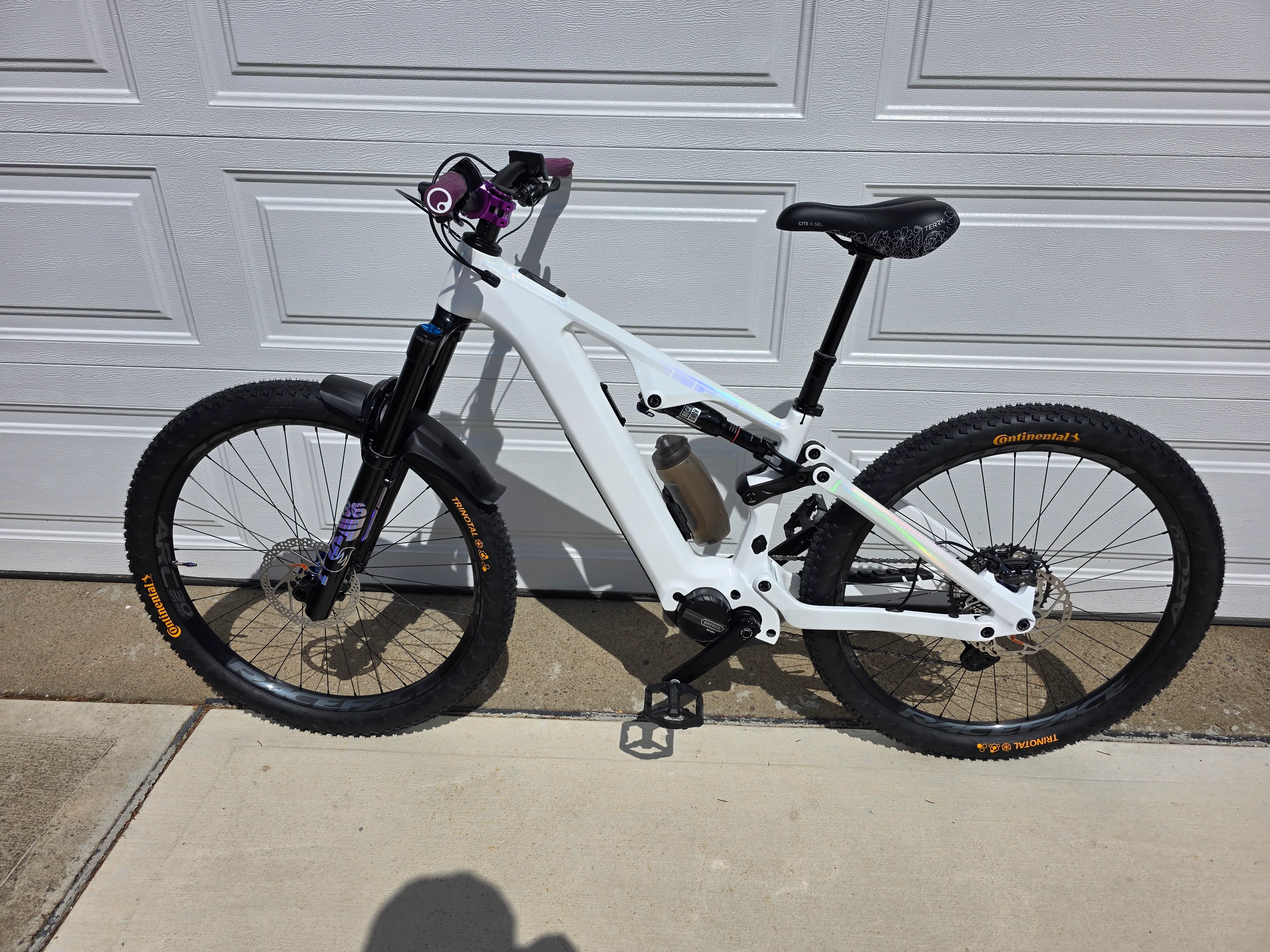

I just built up a m560 bike for my 5'3" wife using the cef69 in size small with full 27.5, the 835WH battery and aluminum wheels.
Fox 36 perf, and a 205x50mm shock to prevent bottoming out.
Came out to 20.9kg. If you got a smaller battery or added carbon bars and wheels, you should be able to do the same build in under 20kg. (Image doesnt have front brake on for silly reasons, its there now).
Seeing as her correct dropper post length was still much above full insertion with a 150, you could probably run a 180 if your wife is similarly legged as mine, or a 150 closer to slammed if she isnt.

I did just go through this though.
Ended up buying and building up SZZSBIKE CEF69 29/27.5ER Carbon Ebike Mtb Frame 48V 835wh Bafang M560/M510 Motor Full Suspension Disc Brake Light Weight Ma | ZSZT
In size small. Picture above. 20.9kg with basic heavy wheels and fox 36 parts.
