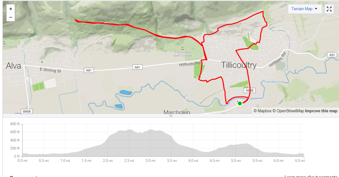

Anyhow I have had the bike for over 2 weeks now and continue to do the same loop as before - 6.5 miles with 950 ft of accent - time onthe bike aroudn about 55 minutes. Great news is that I can do 4 loops of the circuit on one charge of the battery giving a total distance of 26 miles (40km) with 3800 ft of accent - all modes were used on the bike..... profiel for one circuit is below.
