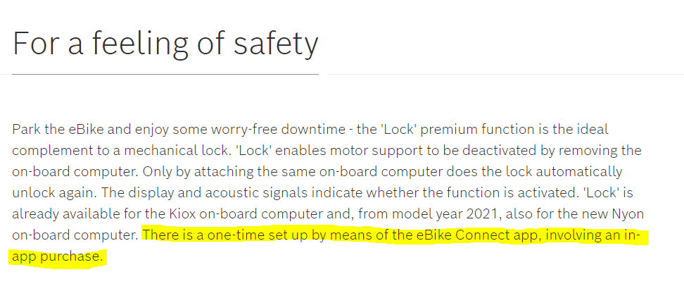

I have activated the kiox lock function, think it cost about £8. It basically locks the serial number of the Kiox unit to the serial number of the motor. If your bike is stolen and the thief tries a different Kiox on the bike it wont work, I have tried this with a freinds.
If you loose or brake your Kiox you have to provide Bosch with proof of purchase before its deactivated and a new one sold to you

What happens to the security function if one removes the kiox and just installs a new purion?
Jamy
Sep 24, 2019
206
122
rotherham
I asked the dealer the same question. He said the motor will remain locked unless the serial numbers match and the only way round it was to replace the motor and control. how true that is i don't know. He also said he does not sell controls to anyone without proof of ownership. At the end of the day its a deterrent not a fail safe.

Is the £8.99 cost a one off, or a monthly charge? I note it mentions a 24mth agreemen?
Its a one off cost
