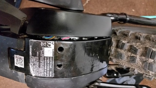

Hi
New to the forum
Got my Kenevo in August last year
So far covered a mighty 80 miles in that time!
Lots of motor issues which has now been replaced by Specialized in the UK under warranty.
1st problem was the remote mode switch not working
Then constant juddering on the bike. Almost as if i was constantly 'dabbing' on the rear brake
Then no power
Back to LBS in the UK (who have been brilliant by the way)
Back to me. Loss of power again. Back to the shop who suspected faulty cable
Back to me. Power failed again
Back to the LBS and sent to Specialized in the UK
Motor and all wiring replaced, but unfortunately they fitted the clip for the main
motor cable upside down which prevented the motor plate closing properly, leaving a 1cm gap
between plate and motor! They actually returned it to my LBS like that, plus somewhere along the
line the pedals have disappeared!
Anyway, cranks off, plate off and could'nt get the plate to sit correctly.
Could see the issue, the clip was preventing the plate from closing
Removed and fitted the clip and all seems ok now
Desperate to get some miles on this bike, so will have it out today

Hi EBG
When i had the problems, i assumed battery but that was fully charged and is charged after
every ride (or attempt to ride:))
When i change between either of the 3 modes (ECO/TRAIL/BOOST) sometimes i hear the 'bleep', other times i don't
The battery was removed and reset. No change
I checked the contact point on the battery and found some debris on the contact points, from a previous ride. Pine needles in particular!
I cleaned this and the connector and it started working.
Within 10 minutes none of the modes were working again.
Removed the battery and checked the connections, there was no pedal assist at all.
By this time the 'bleep' could be heard when switching modes, but no boost at all on the bike.
Every time i switch mode the battery lights on the side of the bike drop and then reset to 10 'bars'.
So looked like it is connecting ok
I was on a ride at the time and on heading home, i knew i had a fairly steep road climb (very unappealing with this weight!) so again removed the battery and connections. Now the bleep could be heard and the modes suddenly started working to my delight!
The one noticeable thing is the amount of debris between the connector cap and the electrical contact point of the battery. My understanding from Specialized is that this is "completely waterproof". As if....
LBS advised to use electrical contact spray on the connection points and on the mode switch device on the handlebars (altho not sure what use that is)
But since then, total power failures. Spesh had the bike picked up and returned to their UK HQ for tests
New motor fitted by Specialized last week and all of the wiring replaced
First proper ride today - 20+ miles, mud, water, poor conditions. Bike peformed very well. Most please i now have a bike that does what it says on the tin!
