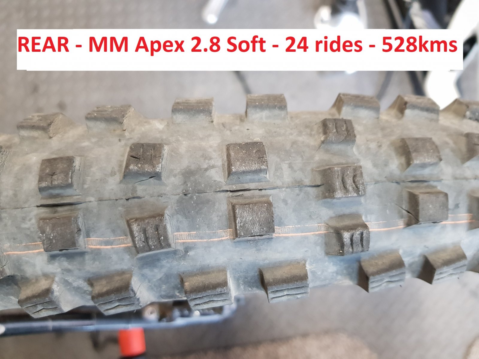

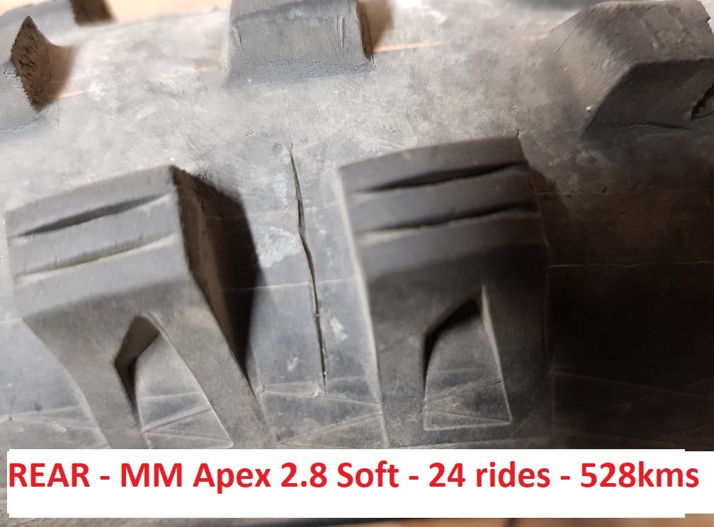

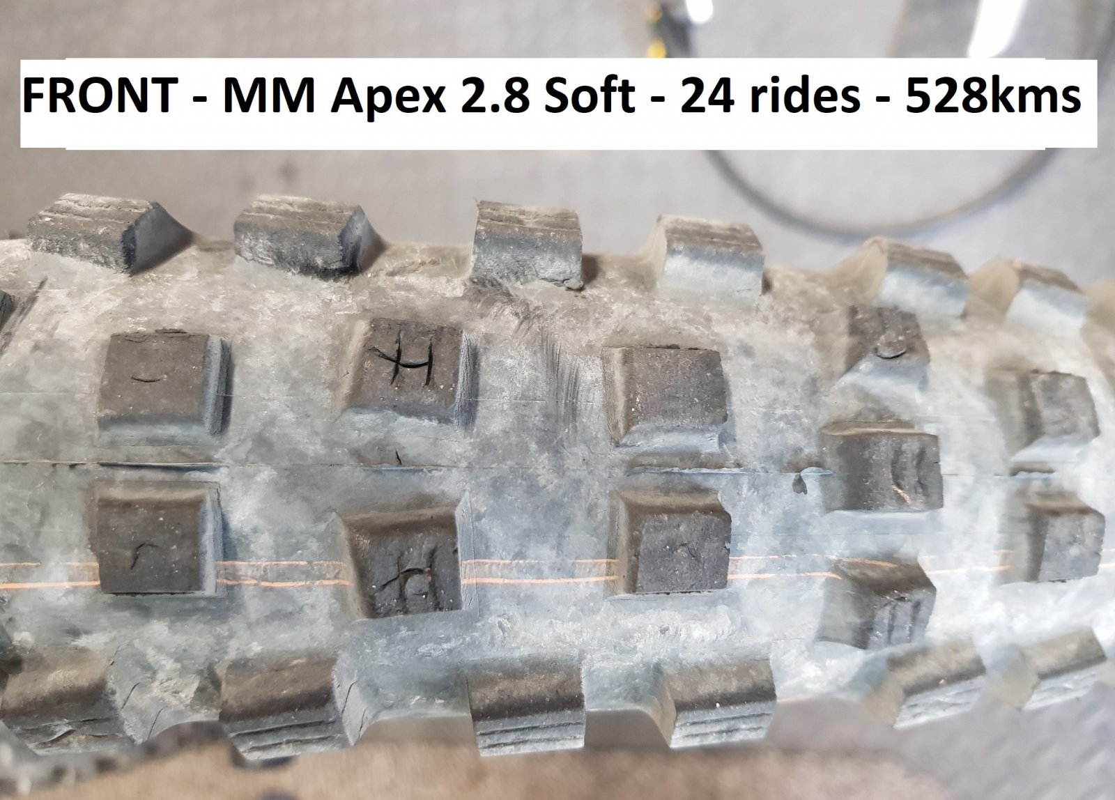

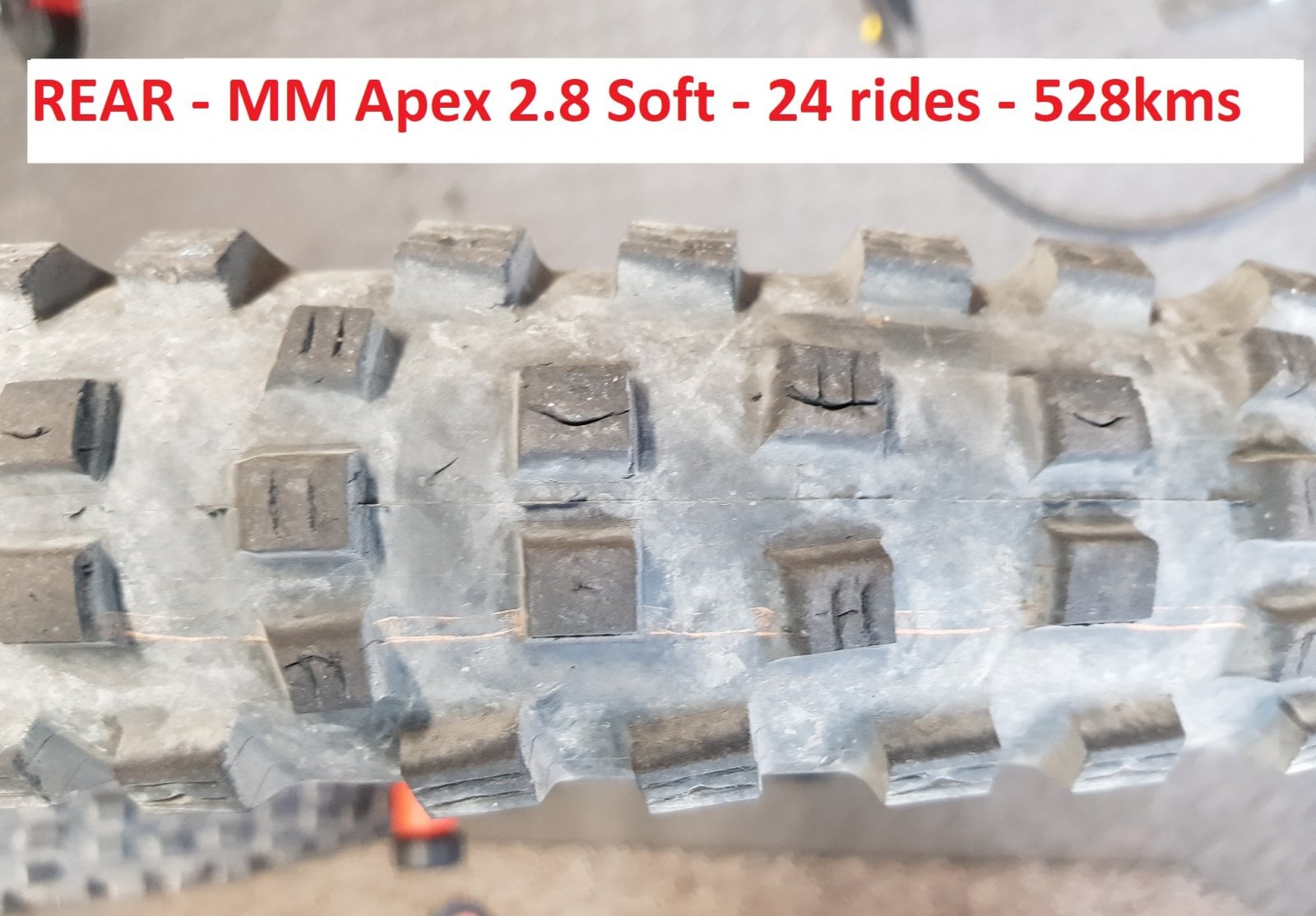

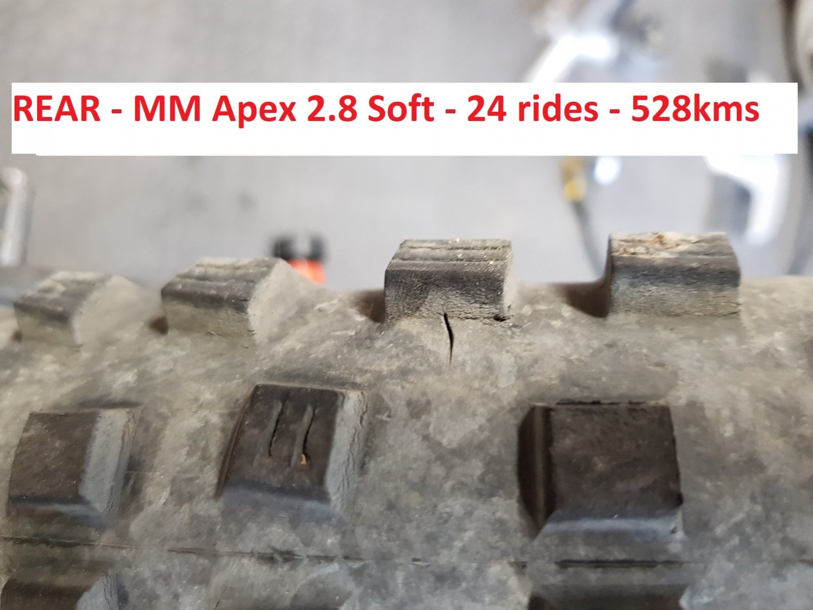

I fittted the Magic Mary APEX 2.8 Soft compound Folding tyres/tires 1050gms / 2.31lbs at the end of June. These replaced a set of Magic Mary DH carcass 2.6 Ultrasoft Non folding tyres/tires 1410gms / 3.08lbs
Since fitting them I have completed 24 rides and travelled 528km / 328 miles. (Ride and distance info captured using Starva)
I am running Tubeless on SRAM ROAM 60 30mm wide carbon rims with 120mls of Stans No Tubes Sealant
On the sidewalls the recommended pressures start from 17psi up to 35 psi
I am running Front 17 psi, Rear 17psi. You or others on the forum may prefer 'More' or 'Less' depending on how you like things set up.
Terrain where I ride
Typical Welsh slatey/rocky hard packed fire roads
Man made slatey/rocky hard packed trails.
Off Piste trails, very loamy, soft and rooty
Rider
73kgs to 75kgs with all my bike gear on and depending on how many burgers, chocolate, sweets and pints consumed the day before.....
I am a reasonably confident rider and more than happy to take on Reds runs and the occasional Black run. Jumps, gaps and drops are not an issue as long as they are not too crazy. Technical single track with roots and rock gardens are what I really like riding and now that I have an ebike I have effectively doubled the amount of trails I can ride as I can now do 95% of these trails in the reverse direction :). Obviously doing a run in the reverse direction needs to be carried out either really early in the morning or really late at night to avoid head ons with other riders riding the trail in the CORRECT direction..... :sneaky:
Feedback

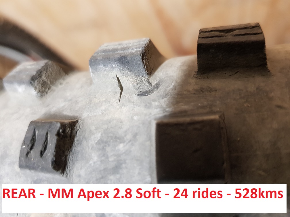

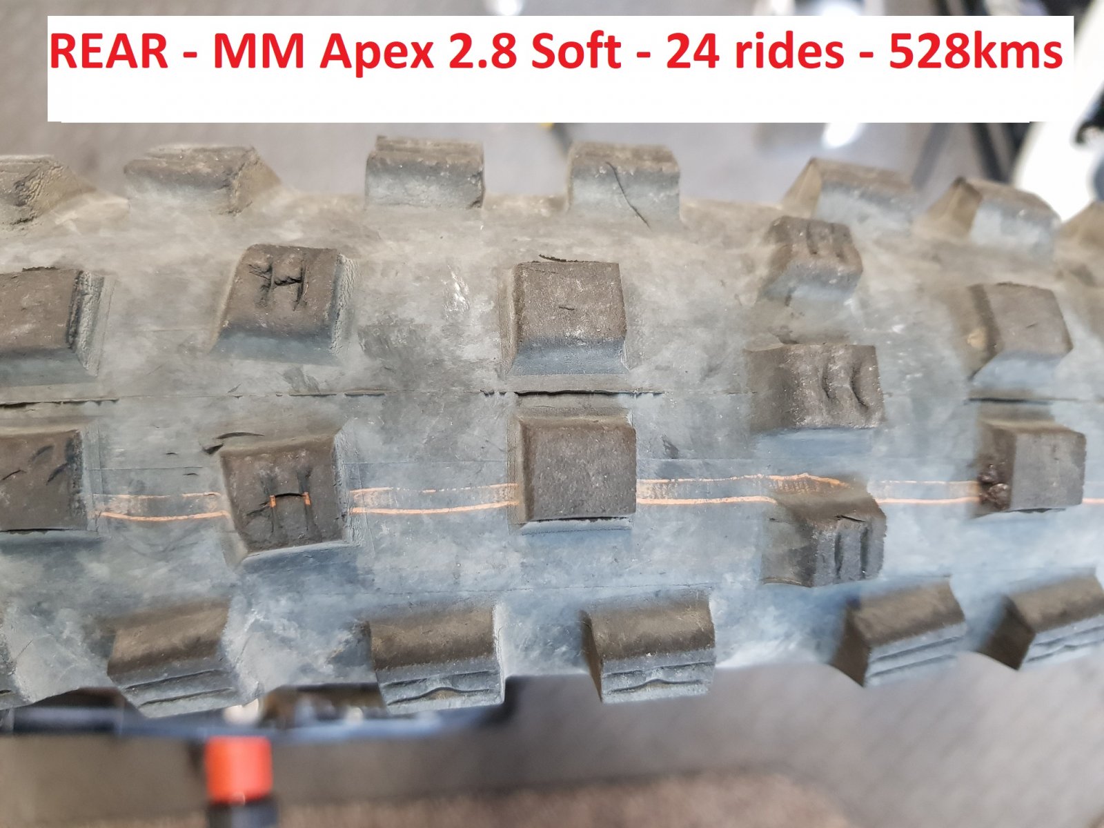

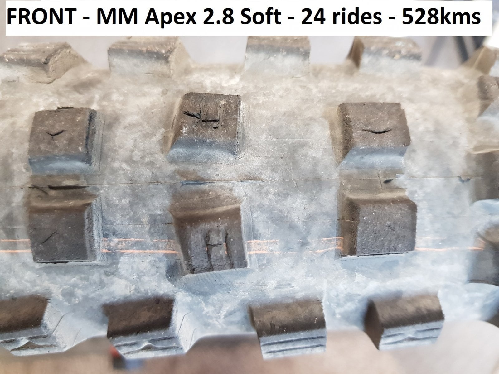

The Magic Mary APEX 2.8 Soft compound Folding tyres/tires seem to be holding up well apart from a few things.
  • I have had a few wash outs on the front where I just lost grip almost as though I hit some really loose fine gravel. The first one spat me over the bars and the others I managed to rescue just in time (More luck than rider skill….). I am not sure if this is just down to very dry conditions at the moment...... I think I need to put the 2.6 Ultrasofts back on again and ride the same trails where the wash outs occured to compare.
  • They do not like damp rooty sections as much as the 2.6 Ultrasofts. They are okay, but you definitely have to reduce your speed and be a bit more cautious compared to the 2.6 Ultrasofts.
  • The carcass of the tyre/tire appears to be much more prone to cuts and slices than the 2.6 Ultrasofts. The good news is I have not had any of the side knobs tear off like the old versions of Nobby Nics used to so this is a positive. The rear tyre/tire appears to suffer a lot more damage than the front for some reason.... The front only appears to suffer cuts to the knobs while the rear suffers cuts and slices to the knobs and the carcass. It could be that the damage on the rear is actually being done whilst braking which sort of makes sense to me. Please see the photos below showing the damage to the rear tyre/tire as there are a number of cuts and slices around the entire circumference which is more than a bit concerning.
  • Wear rate seems to be okay apart from all the cuts and slices. However, saying that I think these tyres/tires are not going to last much longer than the 2.6 Ultrasofts. Before I took the 2.6 Ultrasofts off I had completed 83 rides and travelled 1450km /900 miles. I would be more than happy to put them back on although I would put what was on the rear on the front and what was on the front on the rear. Doing that I would be confident that I would get at least another 600 to 800km / 370 to 500 miles out of them before having to get a new set.

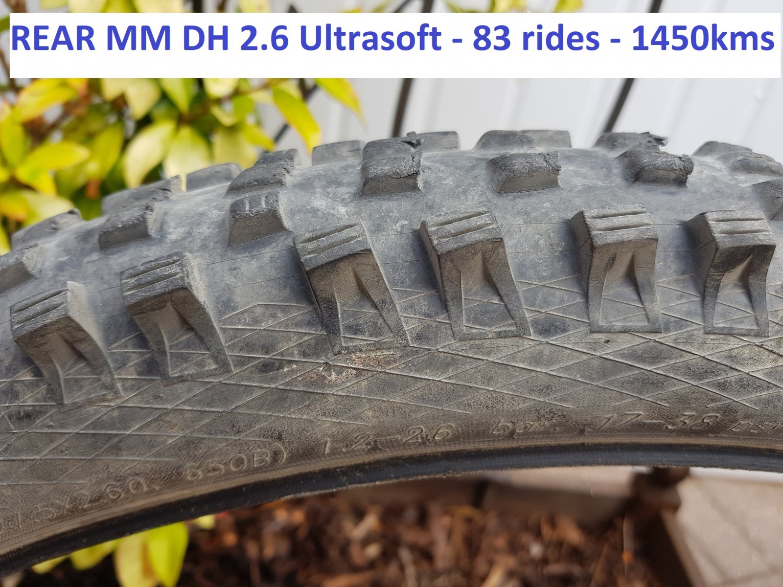

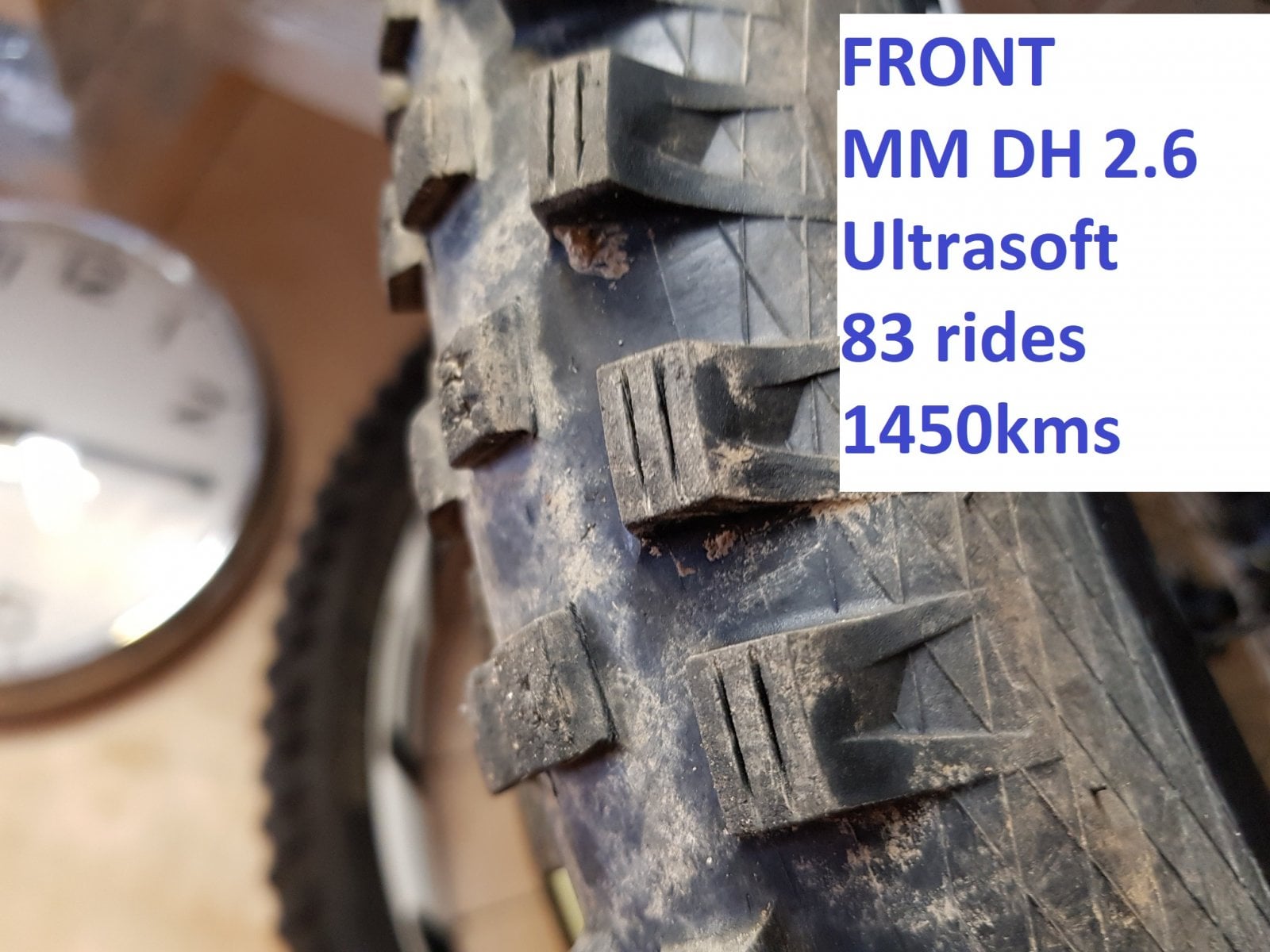

Alternative option - Magic Mary DH carcass 2.6 Ultrasoft Non folding 1.4kgs/3.08lbs
  • The 2.6 Ultrasofts are almost indestructible, you can run them at reasonably low pressures as they have a super thick carcass and DH sidewalls. (Check out the Screen shot below). The yellow bit in the screen shot is some sort of hard composite material that you cannot physically bend, unlike the almost 'paper thin' sidewalls of the 2.8 Butchers or for that matter most of the other PLUS tyres out there for sale.
  • They are super grippy and very confidence inspiring on all the terrain noted above in the dry. I also had the same experience when it was damp/wet.
  • Point and shoot the 2.6 Ultrasoft at any rock garden and she will deliver her magic. With the super thick carcass and DH sidewalls you do not need the latest craze of moose/foam inserts available. The 2.6 Ultrasofts really are ‘that good’ at protecting your rims from damage and giving you almost zero punctures.
  • The 2.6 Ultrasofts are heavy, 1.4kgs/3.08lbs plus for each tyre.... Who cares!!!... Well, some of you probably will but on the positive side, you have an ebike, it has a motor and to be honest I did not feel I was having to push any harder to get up to speed or to get up steep hills or my battery ran out any earlier.
  • Almost the same wear rate as the Magic Mary APEX 2.8 Soft compound but less prone to cuts and slices
  • Sticky clay conditions tend to clog them up. However, Sticky clay conditions tend to clog most tyres/tires up. Changing over to Maxxis Shortys or Maxxis Wet Screams or any other purpose built mud tyre will get around this issue. However you will lose the indestructible sidewalls of the 2.6 Ultrasoft by doing so and risk dented rims and pinch punctures unless you can get a mud tyre/tire with a DH rated carcass or Super Gravity rated carcass.

Hope the above info and photos below helps with your decision.
View attachment 3688View attachment 3689View attachment 3690View attachment 3691View attachment 3692View attachment 3693View attachment 3694View attachment 3695View attachment 3697View attachment 3698View attachment 3699

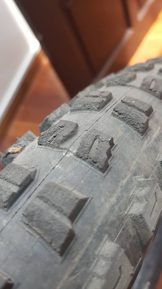

I dont have grip issues with the stock butchers...but this is the condition of my rears after just 180km...less than 2 months of riding.
On my manual Yeti, im currently running Hans Damphf which are over a year old, with better looking knobs
I think its the combination of heavy bike + soft compound + heavy rider (85kg)

what?? I'm 100kg and did 300km on my Kenevo now - my Butchers are looking much better. Do you ride tarmac often? Or do you slide the rear on breaking?
trail rides only. yes im a slidey rider...but have never had issues with DHR, DHF, MM, or my current hans
okay, that explains the wear on your pics :)
I had the Nobby Nic on my other bike and some nobs were just missing after the very first ride - 100kg weight and hard breaking on roots have just torn them out. The nobs on the Magic Mary can take that much better.
