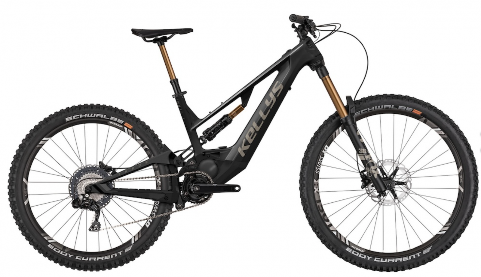

EP8 and 730wh battery, looks like a very similar battery set up to the Levo

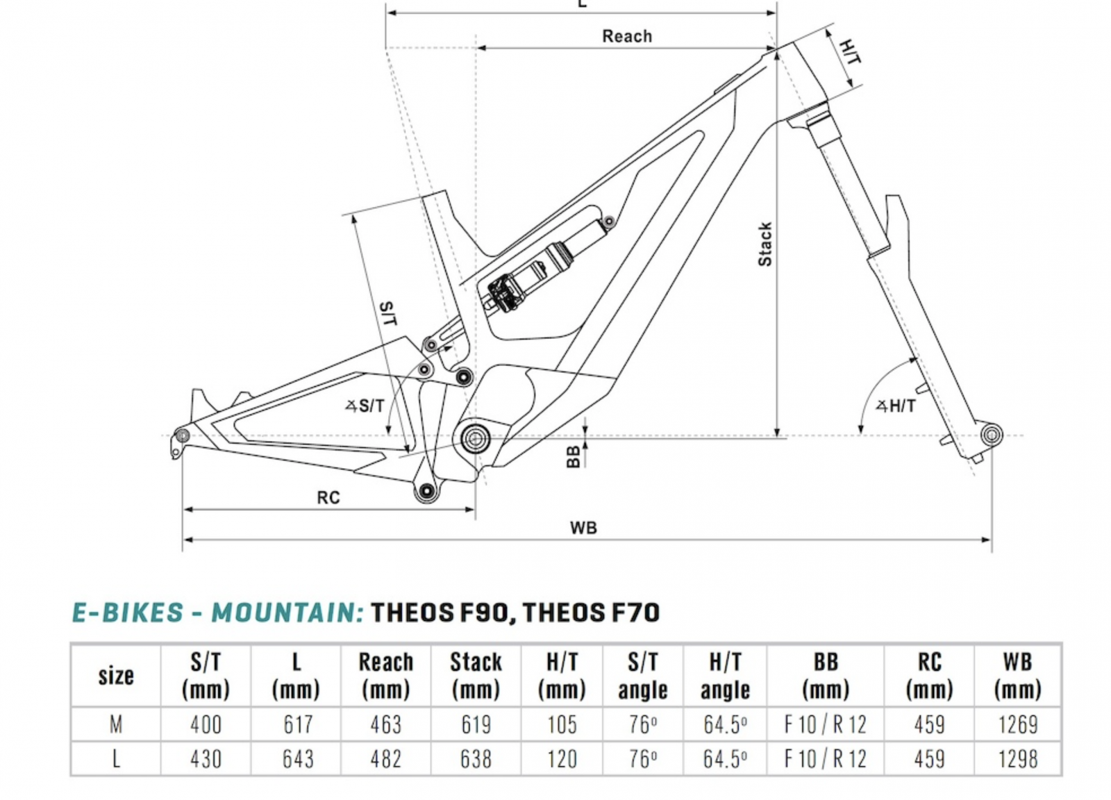

Beautiful bike! Design team put together a weapon. Unfortunately 450 is my personal max cs length and closer to 440 is where i want to be. Id like to see companies that spec their own battery somehow make it possible to use the motor brands battery

Very slick design!
I like the setup with the battery completely inside the frame, but it must have created stress points on the frame in the motor area. However, with modern eng’g methods I am sure it’s dealt with.
13,805
20,498
It is quite neat. Similar in a way to the Levo as @R120 says, but maybe more exposed and less frame in that area.
It's curious they say in the video that they didn't want a hole in the frame for the battery as it would weaken things, but then there's a whopping great hole where it slides out and a lot less material around there and the motor as you say. That section on a Levo looks considerably more braced.

Almost looks like the battery might have more cells positioned at the bottom by the way the downtube is shaped. The downtube is narrower up towards the headtube. Lower COG.That might help with the turning radius if a person wanted to use a triple clamp fork as well

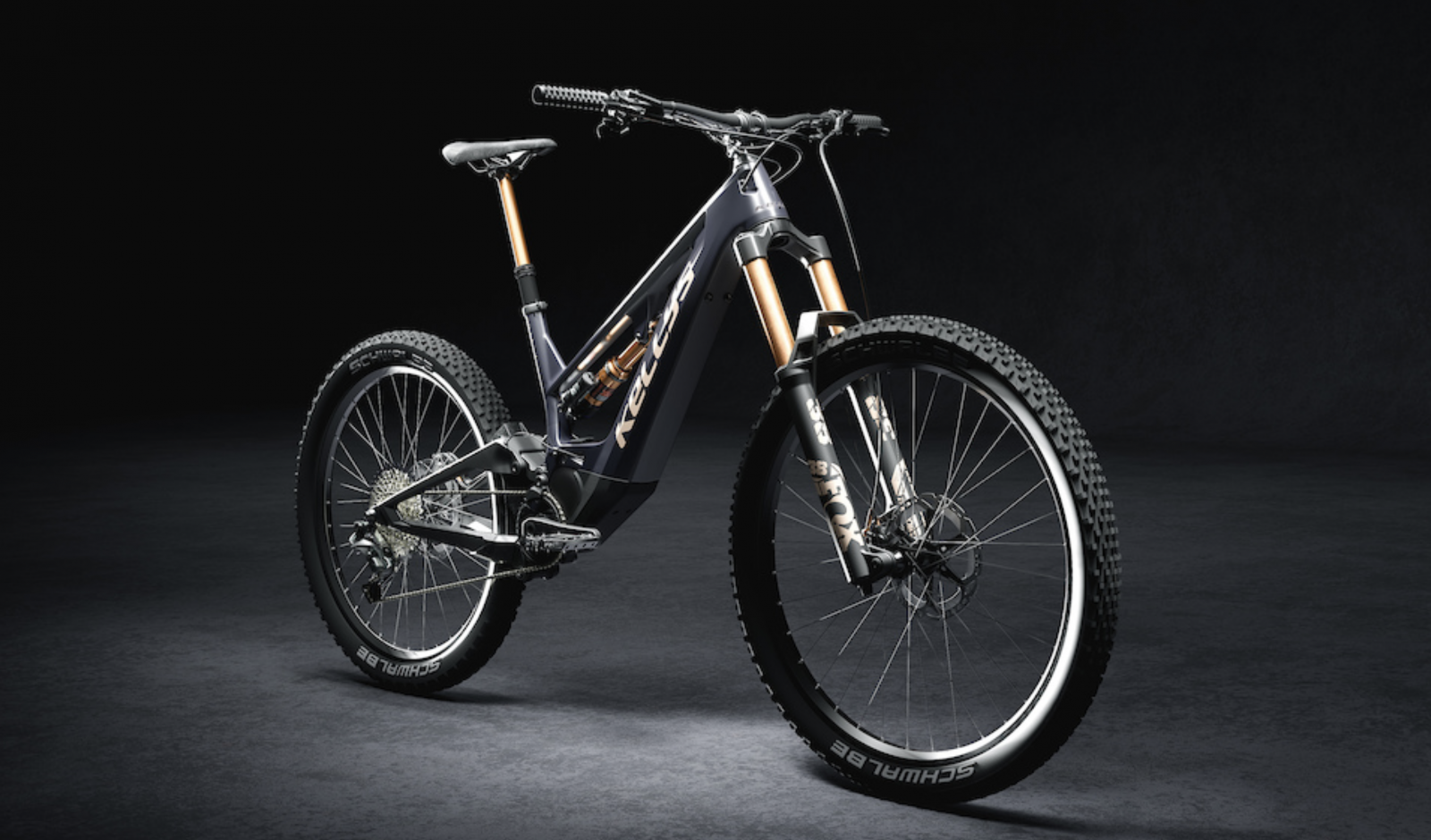

it's the new shimano ep9 ( they can't write it before shimano expose it )
prices starting from 5000 eur to 8000
three models
new kind of carbon type
full carbon frame
no fxcking sram but shimano
i really like it!

Very slick design!
Considering the new material , twice as strong as carbon, and manufacturing process I don't think stress will be an issue on this bike.

f90 is 170mm , f50 is 140mm
they have same rear shock excursion of 65mm , but f90 is 230x65mm and f50 is 205x65mm trunnion mount , i do not understand why one is 170mm and the other is only 140mm if they have the same sock excursion
Well, every mechanical and electrical device has some level of noise, vibration & harshness. NVH creates stress and engineers take care of it.
I am confident that the eng’g team took care of it. Would be great to get more info on the design, materials and testing.
