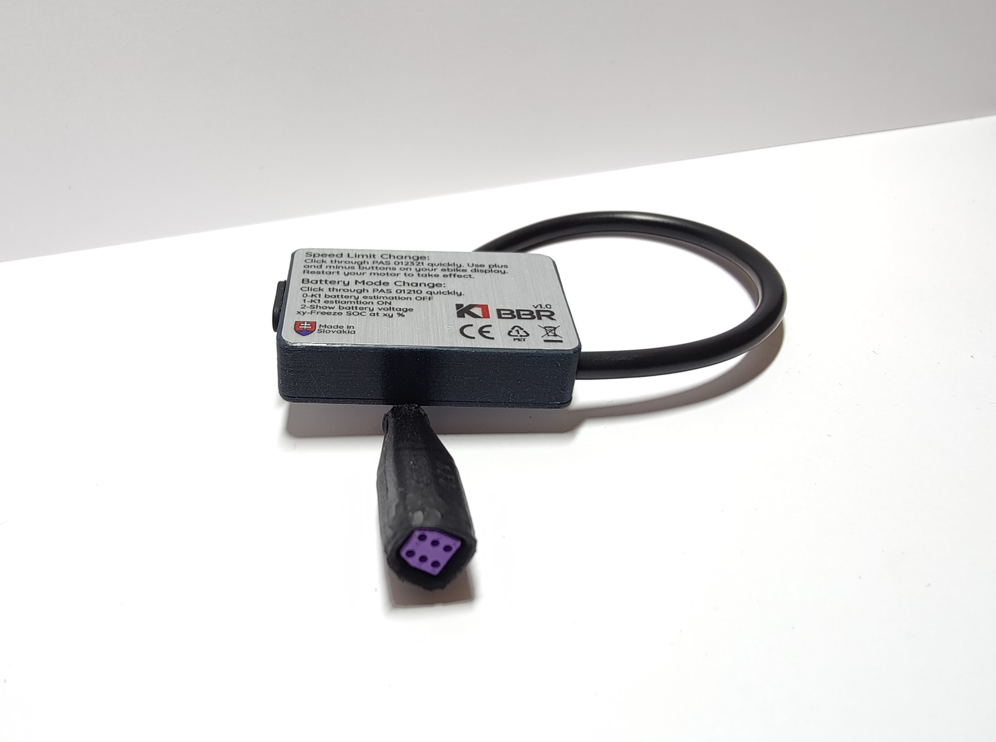

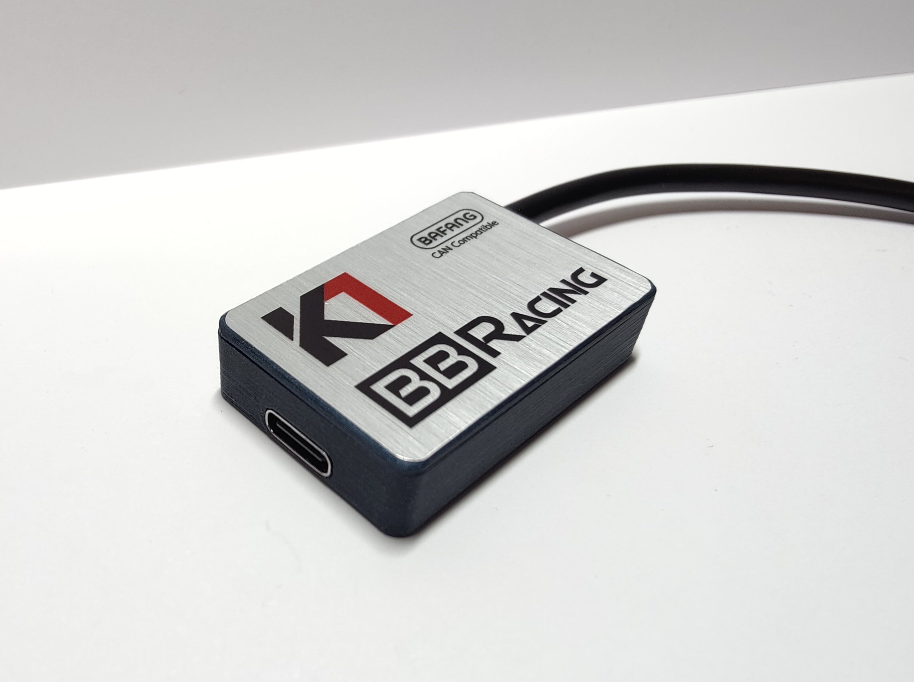

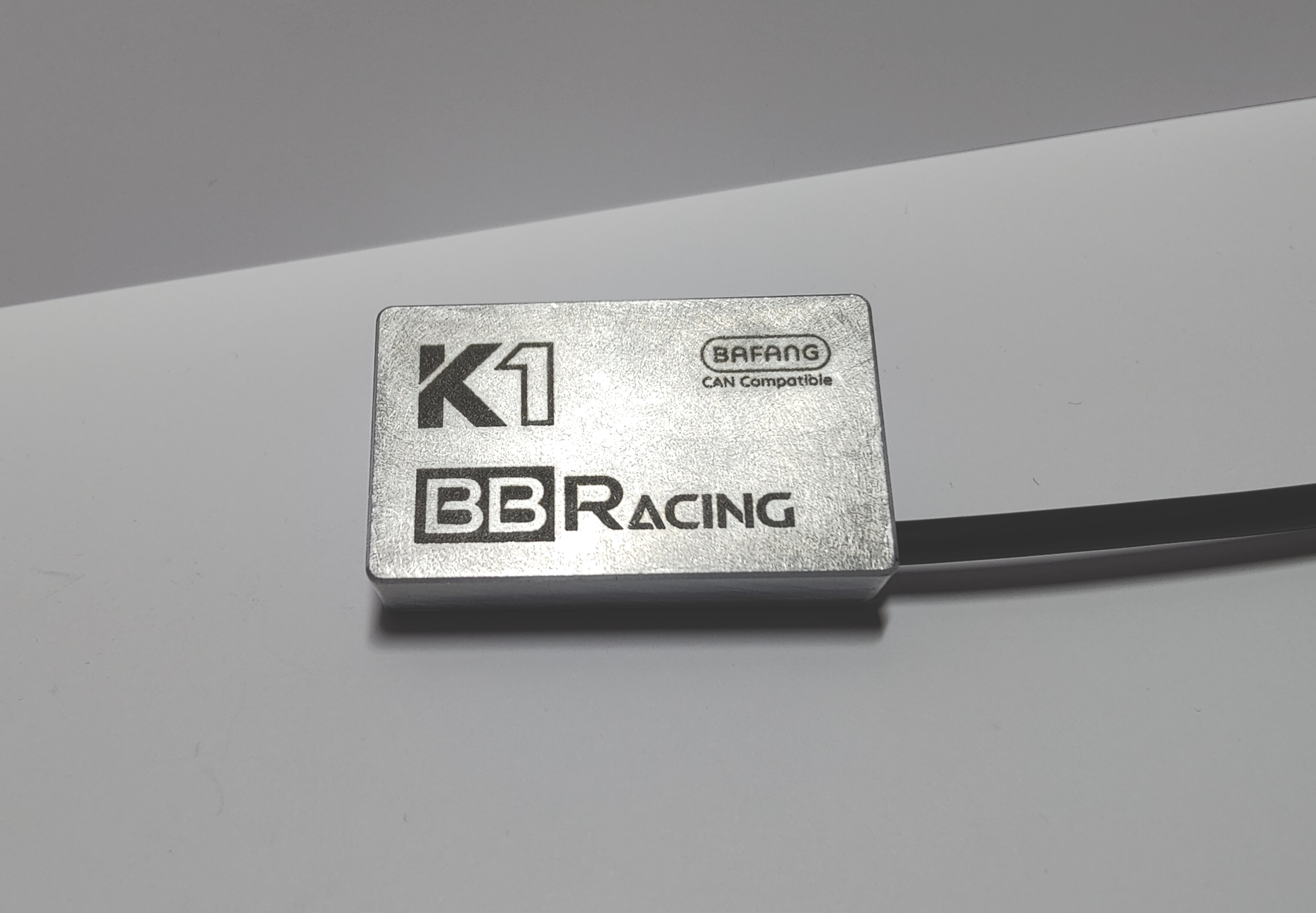

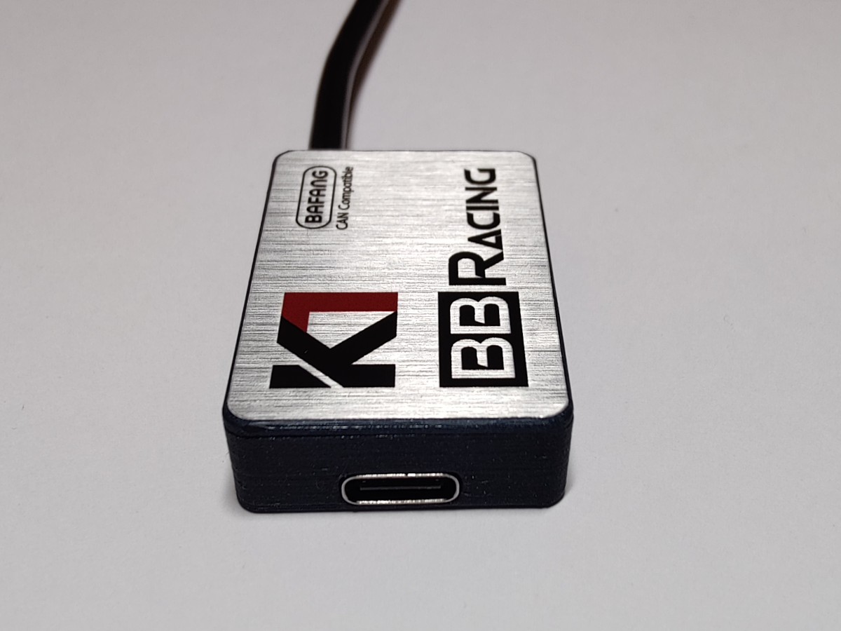

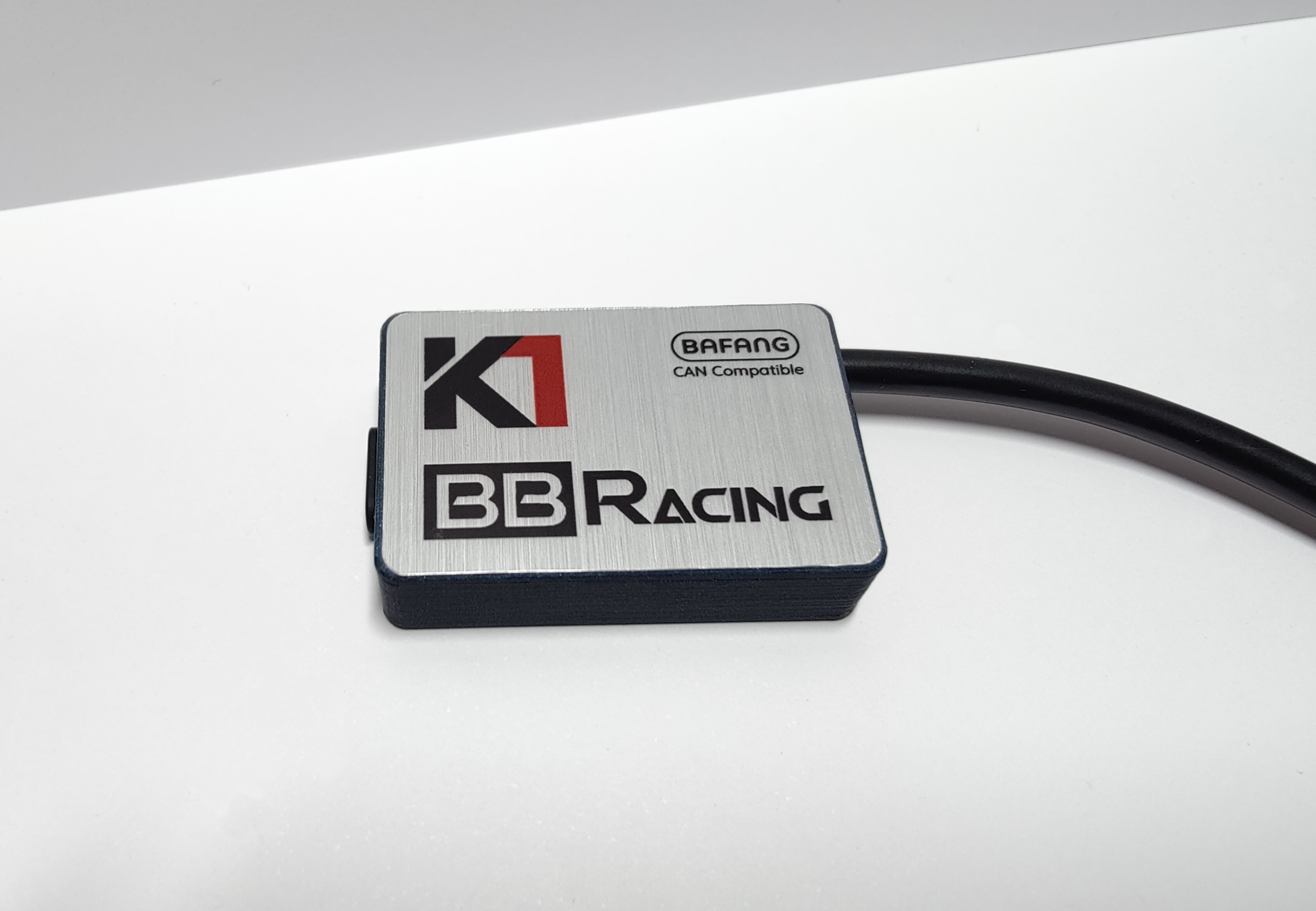

New version of BBR v2.0
Smaller dimensions. But no new functions. :(
Supporting also all the new motors: M560RS, M630, M510RS, Bafang HD and BBS02 CAN versions. (Also M500, M510, M600, M820)
Now in February discount 10% on all products with code "We want RS" (put into order form comments).

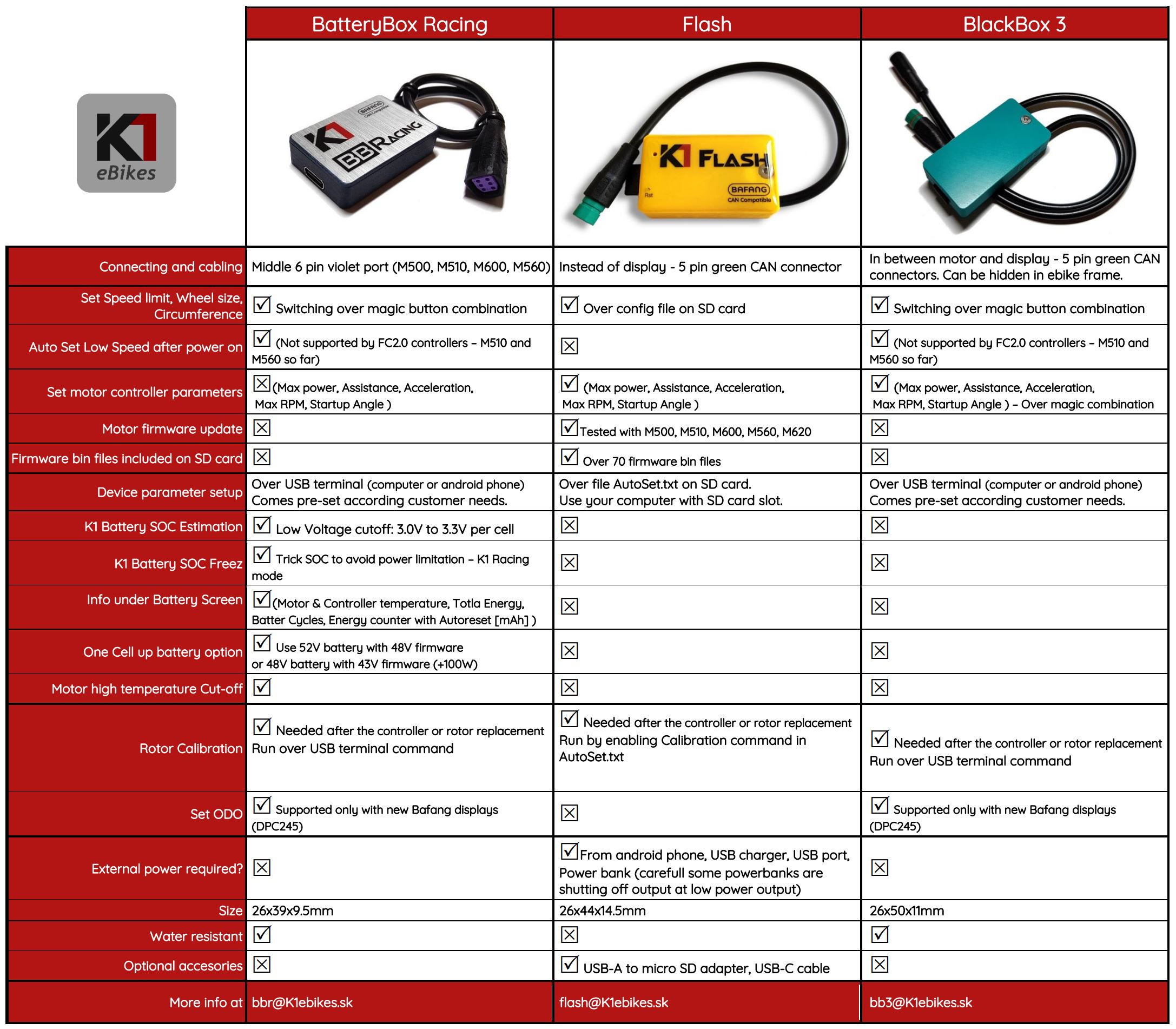

Yes, it is little confusing. Supports any CAN Bafang motor. Device is storing serial numbers of connected motors. You can update first 3 or 7 connected motors as many times as you want. I will think of this and maybe remove this restriction.

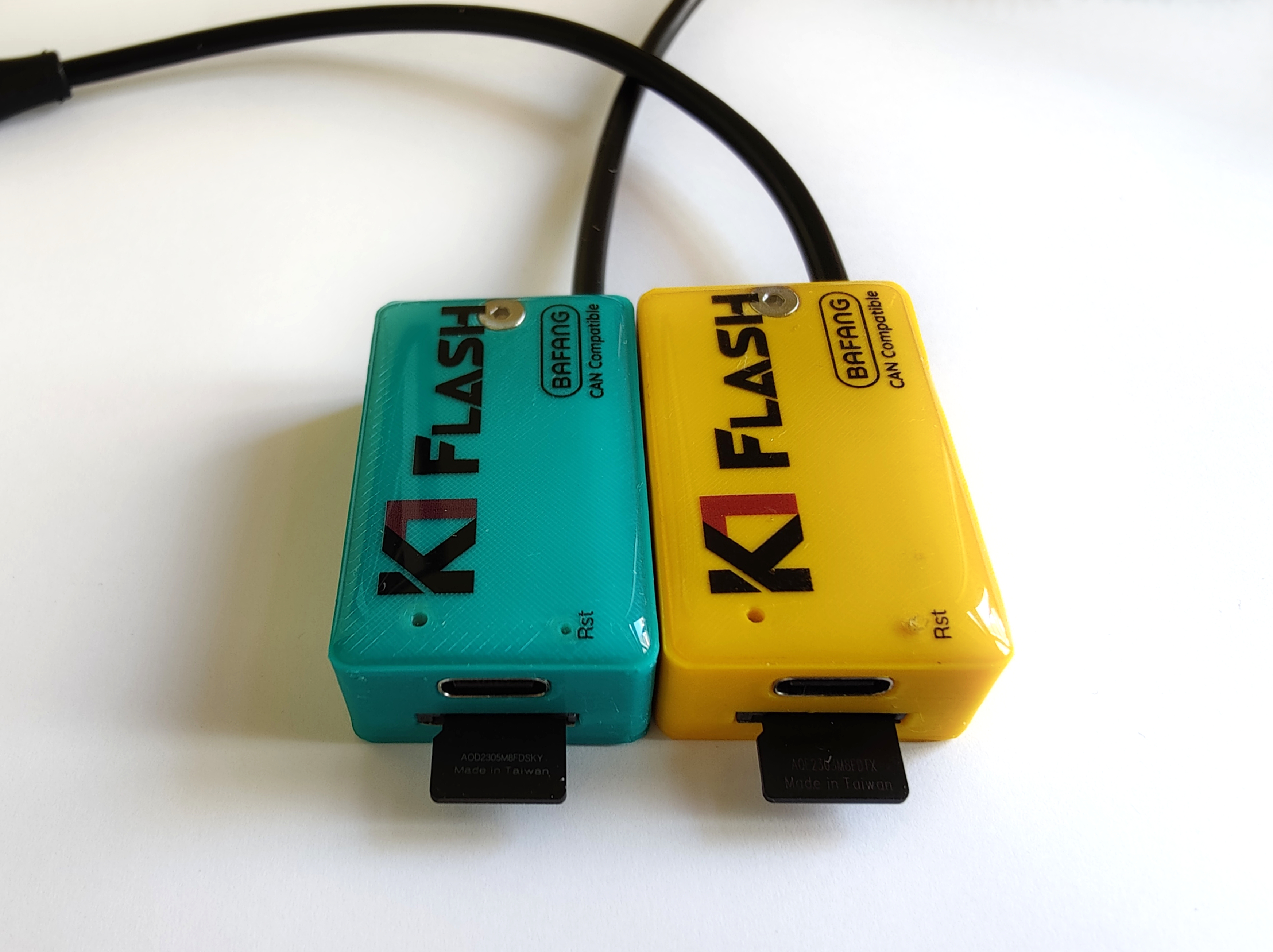

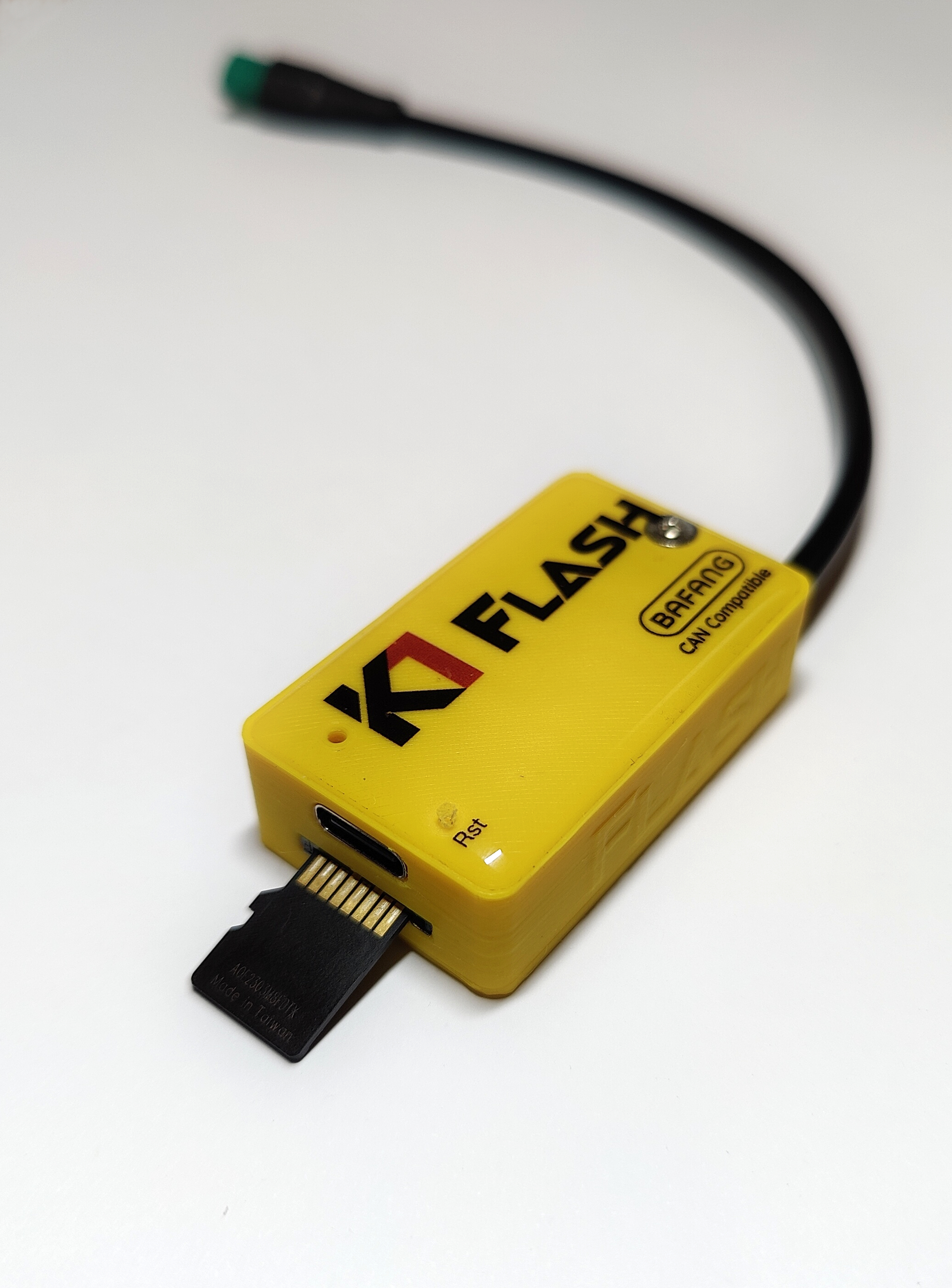

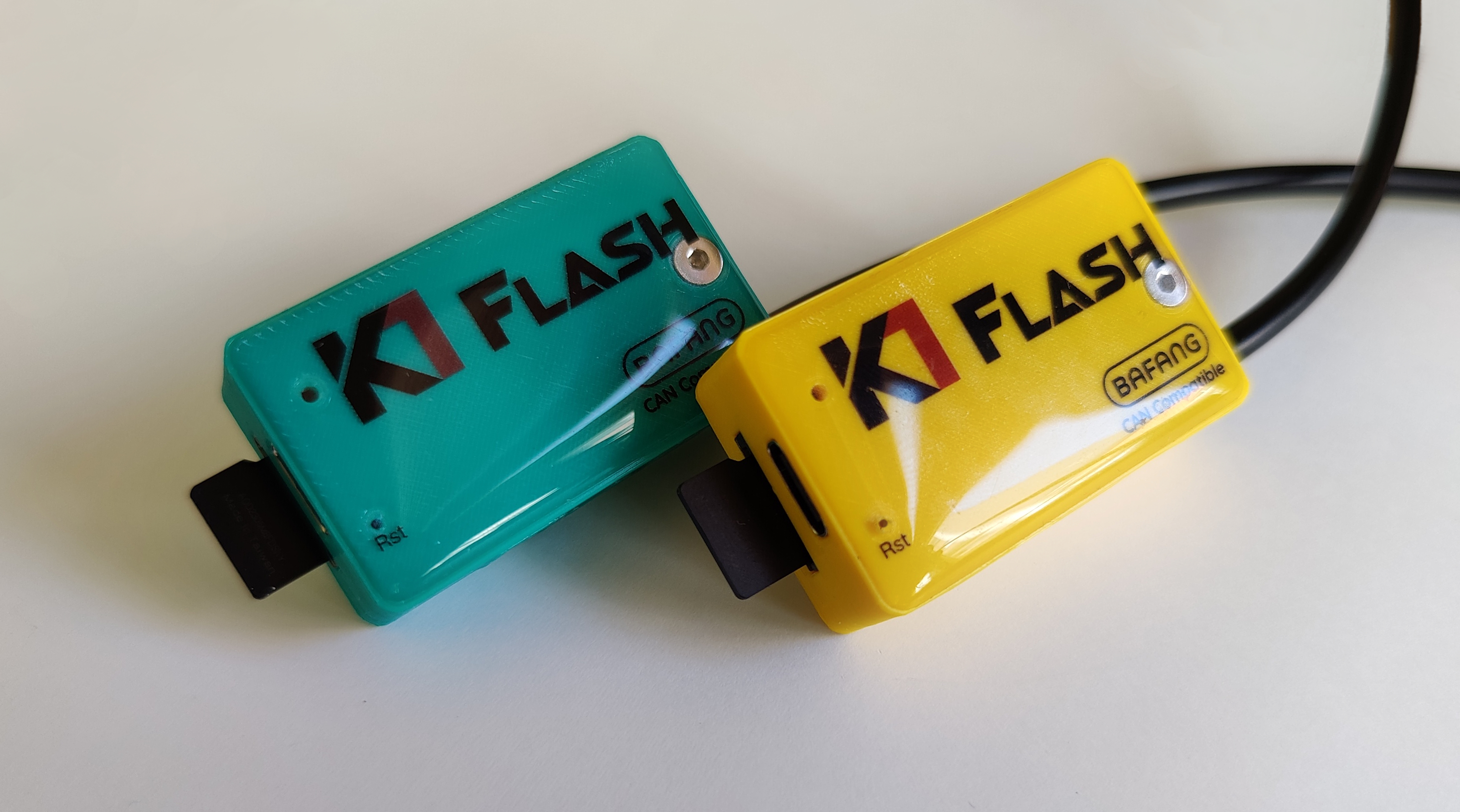

K1 Flash is now history and replaced by Flash v2.
It has same logic - independent over SD card - only USB power is needed. Has exactly same functions. Is new hw (better SD card slot), different internal logic - better compatibility. "ForceFlash" directory was renamed to "AutoFlash".
And added a function which reads "riding" statistics from controller. So km driven and time spent on each PAS level. Will still store these numbers in cfglog.txt file after connecting to motor. (of course only with motors and firmwares which support it - so it is new motors like M560, M510 and now also latest firmware for M620). This is not possible to reset which is good. As you will know how many km has motor driven.
Also support 1000% of assistance where firmware supports (I saw this in RS models and also M510 FC2.x is taking over 500% - just needs to be tested in real if works)
130 Eur version for 7 motors support (you can set parameters or update firmware as many times as you want on first 7 connected motors - device is storing serial numbers)
Or unrestricted version for 160 Eur - good for ebike shops or motor sellers. Or somebody who has lot of motors.

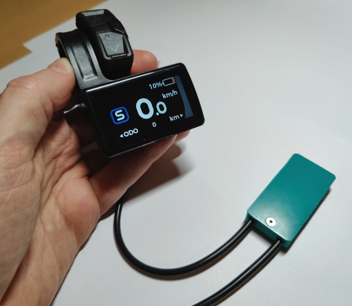

My M560 setup. :)
Firmwares are loaded from the cloud. Over 170 firmwares I am collecting for years.
If you have some missing firmware please share at [email protected] - will load to server and we can share with comunity. I can load also FakeTaxi firmwares and new custom firmware for M560 (but this firmware needs still lot of work. Walk mode was turning other way. ;) But it is great project, will also get one day to my own FOC implementation)
New firmware loaded into motor in seconds. (Info: Your current firmware is not possible to download over CAN and store as a bin file. So if your current firmware not listed is hard to roll back to original)

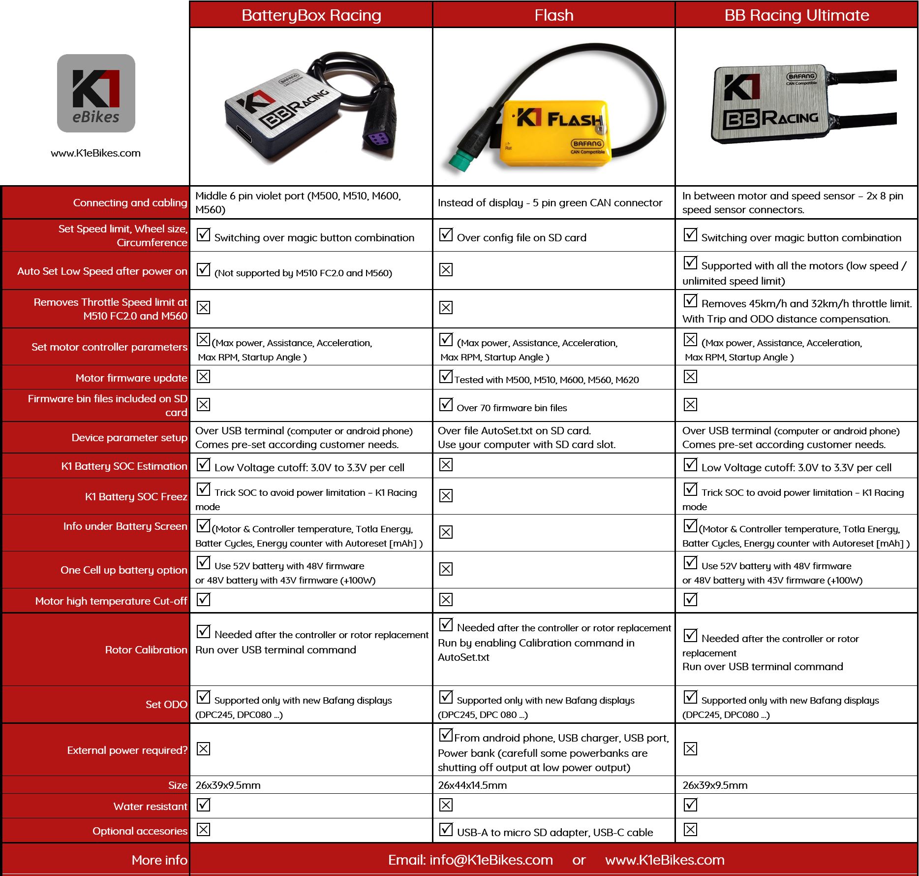

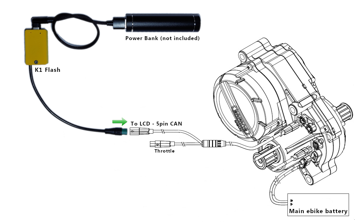

Hello Marek.
K1 Flash is not dependant on display.
You plugging K1 Flash instead of display, set parametrs, or upload firmware. It is stored in a controller and then you can put back your display.

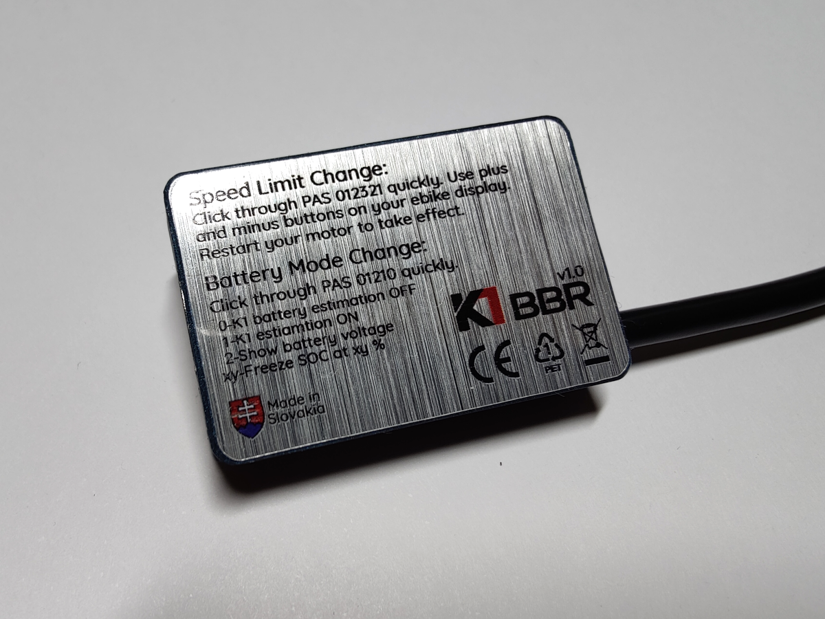

There is BBR device and this is listening on a display buttons (magic combination). And here was some issues with 3rd party displays (as not following protocol fine). But with original Bafang displays is all good.
Hello Marek.

Yes, works fine with all Bafang displays. I like DPC245. ;) Some people saying integrated can make some squeking sounds from that hole in top tube.
What motor you will have pls?
With older motors also ASLS function did work. Automatic set speed limit to 25kmh at each start. Then in M510 and M560 Bafang did change little a logic (new speed limit is took just after motor restart) and this stoped working.
So with these new motors only option over BBR Ultimate and AC function (tricking the speed sensor signal).
