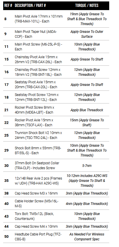

Torque settings

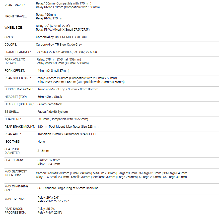

Frame specs

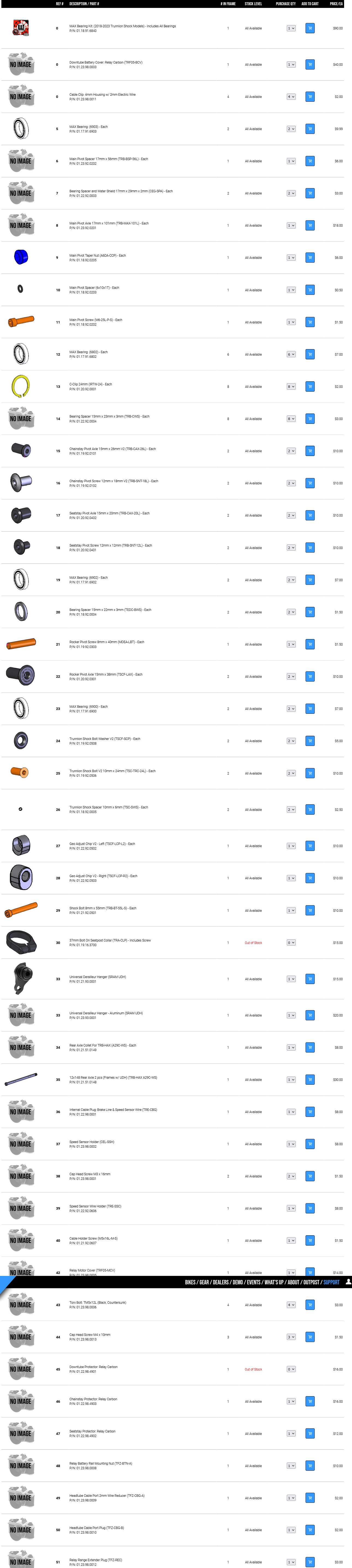

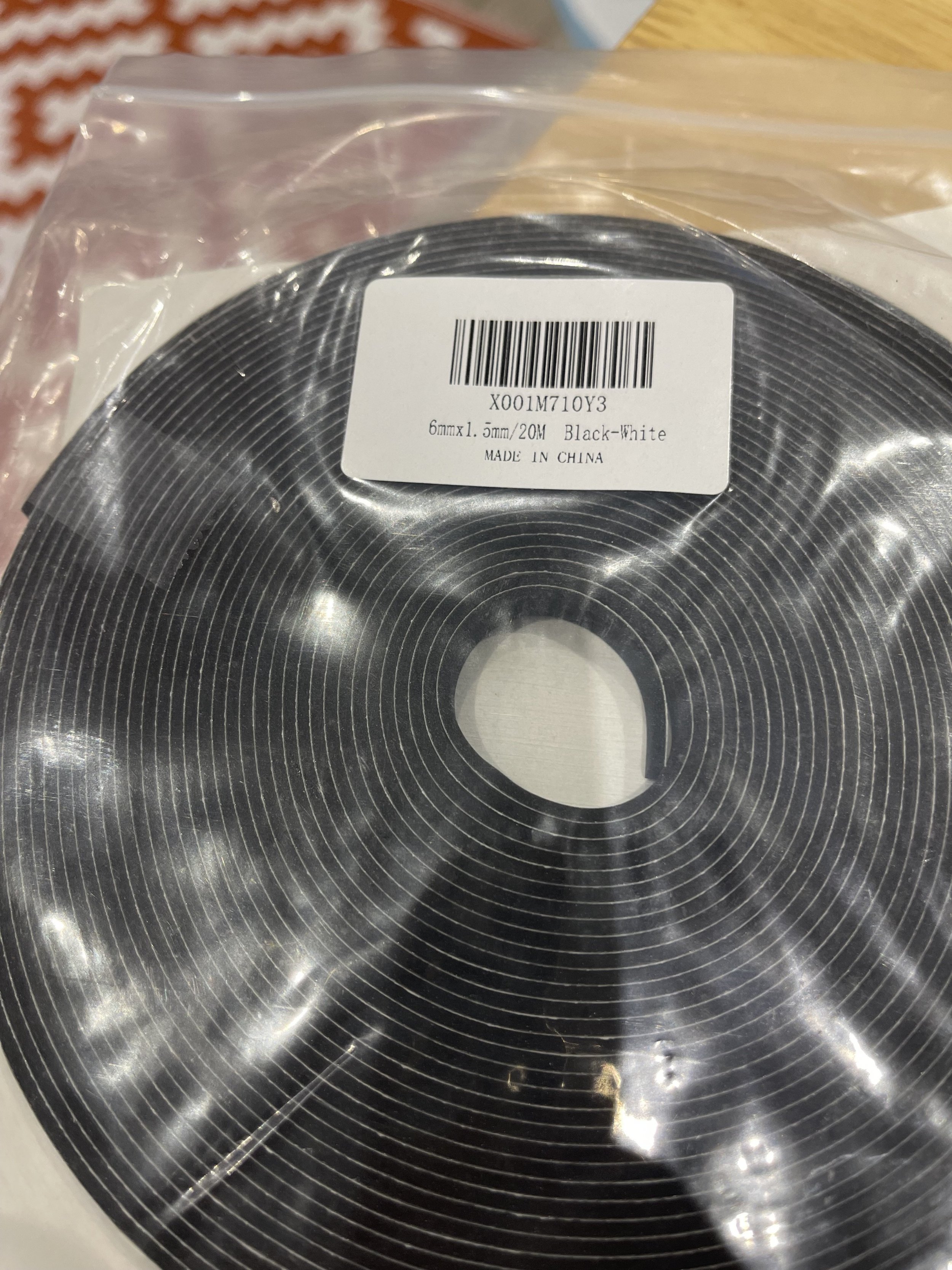

Just received this in post today to seal battery door better

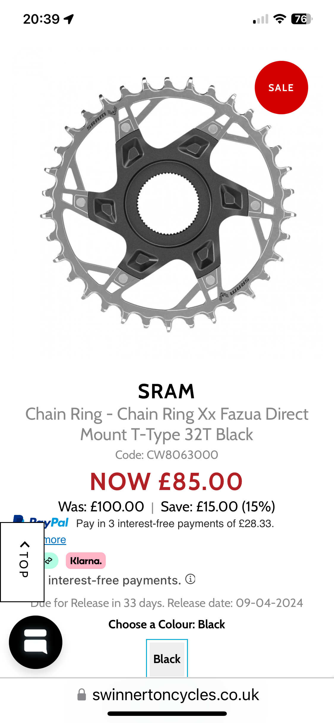

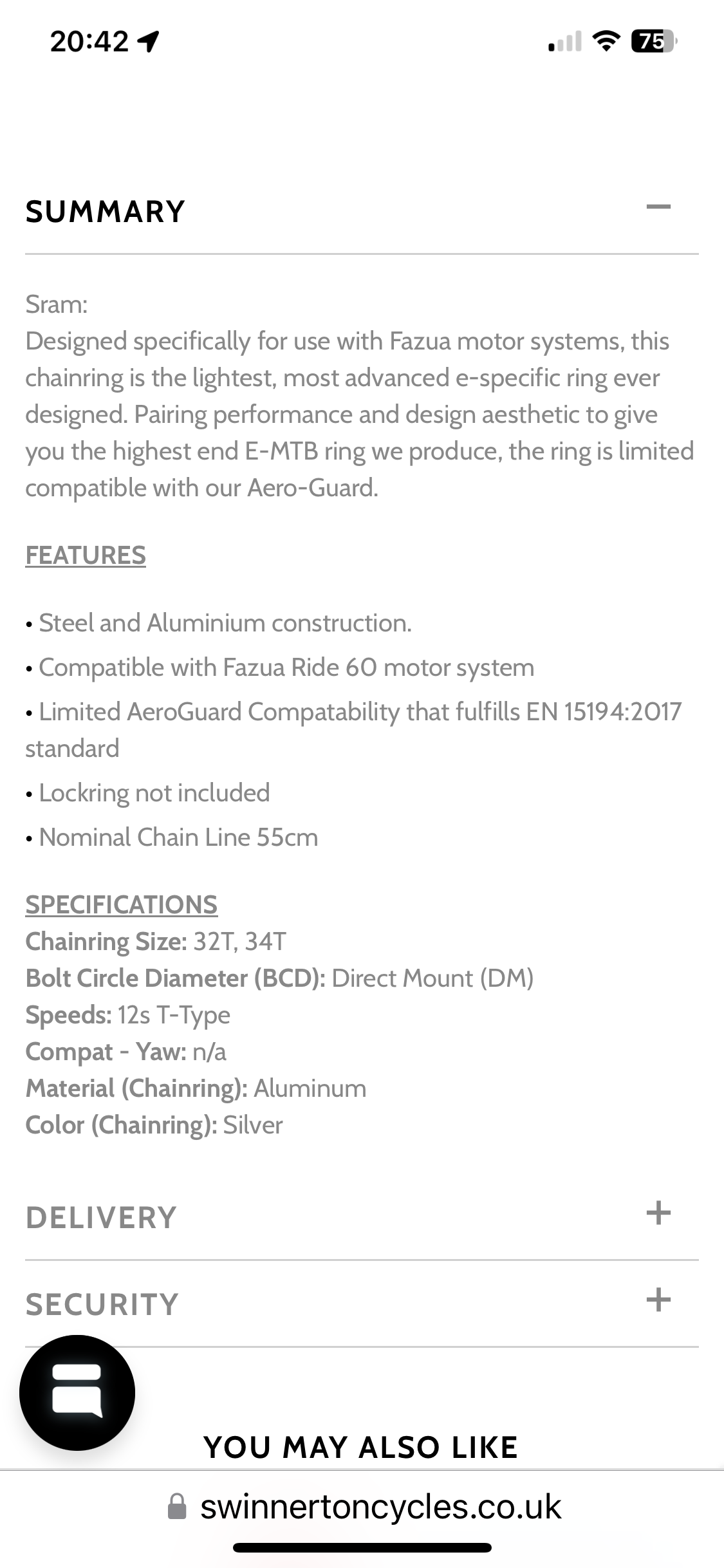

New Fazua ride 60 specific chainring about to land. Looks way better than the supplied one, in my opinion. Of course, I will need the tool to replace it. Not available in uk at mo
it does look nice. Ill replace it when mine dies, but yeah, would recommend the new parktool tool for this.
I haven't examined it closely -- is the stock bash ring separate from the chainring or is it integral? Would I be able to run the bash ring with this SRAM ring?
No you would not be able to. It doesn’t bother me - I’ve never run a bash ring. Would have been nice to have a chain device though.
Thanks. This is the first bike I've had in awhile without a chain guide. We'll see how things go...
The bash ring is a separate piece - but it takes a special chainring, so yeah, wouldn't work. With that said its also a fairly heavy thing and your mileage may vary. I did hit a few times on it so far, which is more than i normally would, not sure why, the bike is low but not that low. Either way, i'd also take the risk, most of my bikes don't have one and unless you hit really hard its fine. Plus i'd rather damage my chainring than the motor's axle...
Thanks for your input. I've only had a few rides and my bash ring already has marks on it from our rocky trails so I feel better having one on there. On my other bikes the bash guard is mounted with an ISCG mount rather than to the chainring. I wish that were possible on the Relay because mine take a beating.
I've tested the bash ring pretty thoughtly. LoL. It's held up. Definitely would have had to change the chainring if it weren't there.
Btw, which torque should be applied to the chainring screws?
Ahh and I ordered the Park Tool BBT-59.3, hope it works as well as the FAZUA tool 🤪

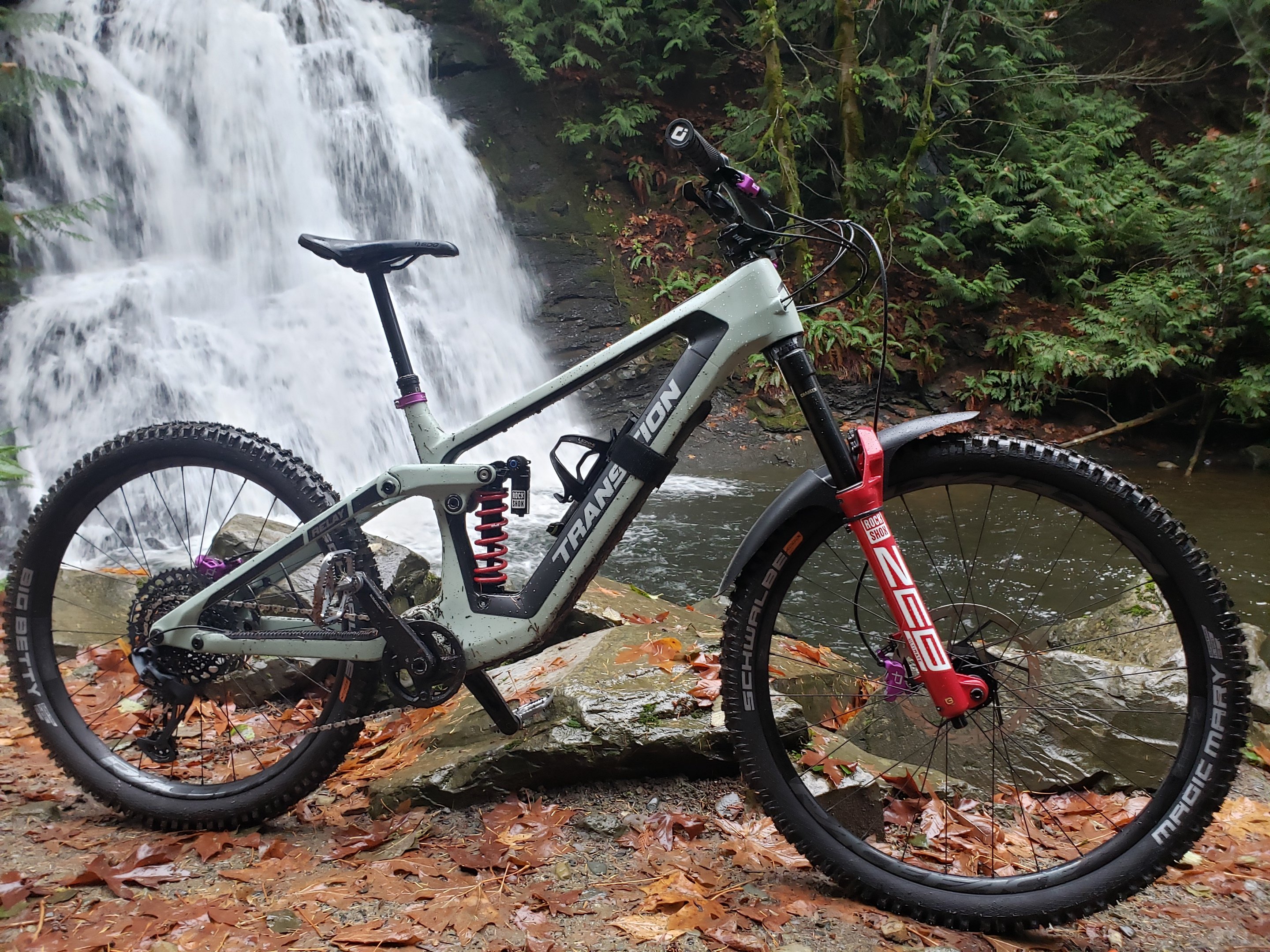

PS. LOVE the color and is that the 2.6 Albert in the back? I just got one in the mail for my own Relay yesterday. Mind if I ask the actual width?
The rear tire is a Schwalbe Big BettyS uper Trail, Soft (2.4). I've never measured retire before how do you actually measure that? Is it from the outside of one of the outer knobs to the other side of the outer knobs?
yeah i love the new colors too :) the pic's awesome. im curious how much folks will like the vivid coil. i have a dhx2 with a progressive spring on mine right now and its pretty good, but the stock dhx was just always a bit off for me (good, but not great type of stuff)
