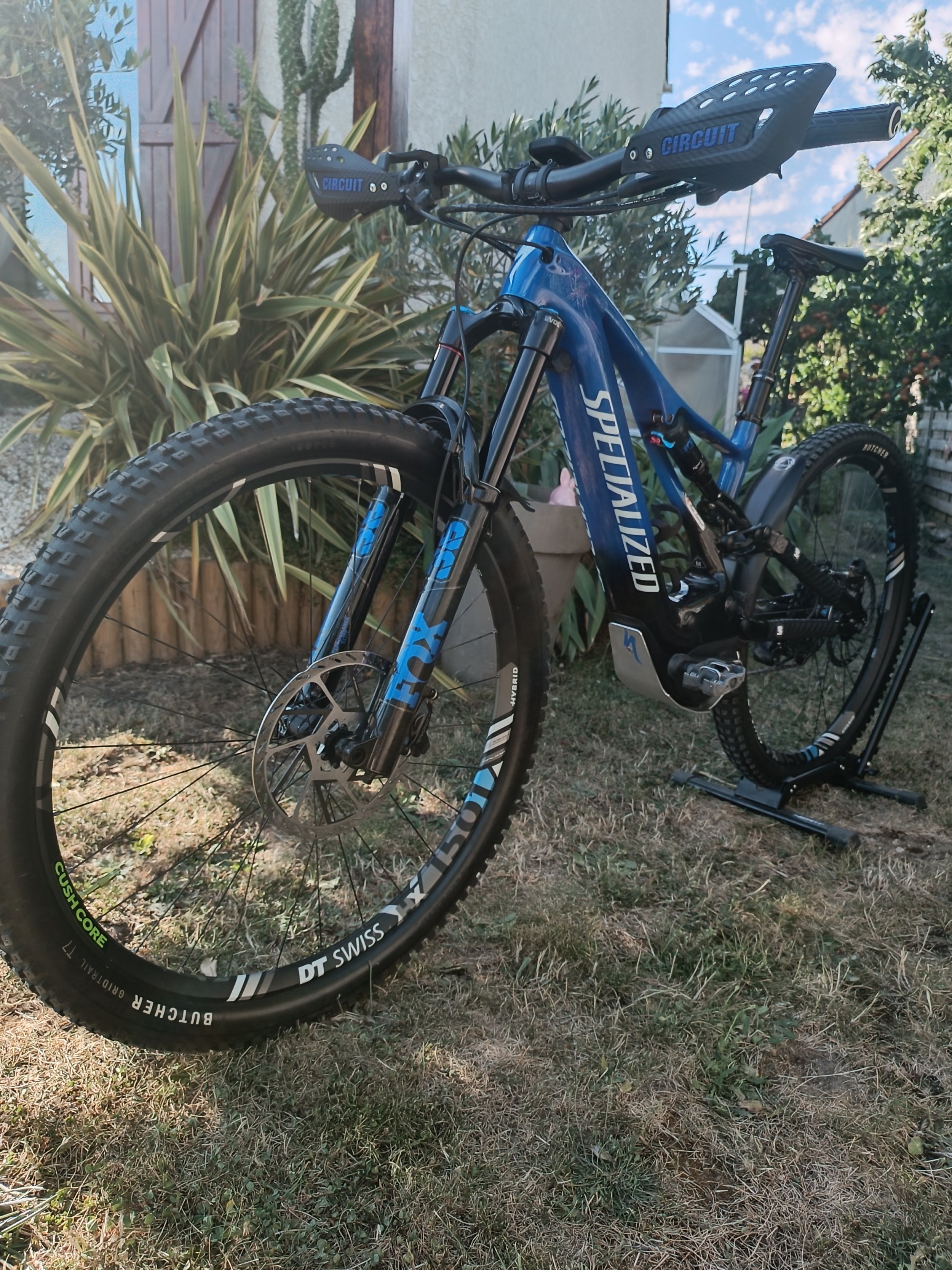

I've broken 2 battery rock guards on my 2020 Levo Comp.
Only one bolt hole you can attach other end with industrial Velcro only trouble I find is if I remove battery the glued bit comes off as it's always rainy here's so use another piece of Velcrco I used it with bolt only for 800miles and it was ok but not enough thread in my opinion . Still look for bolt M12 x 1.25 pitch 19mm the one for battery but I would get another 5mm and cut if needed. Other hole lines up with drain hole .
what's the thickness of this aluminum sheet? 2 / 3 mm?
I want to make me one just like it.
Some sizes and numbers will be great ;)

E tôle d'aviation ep 3mm, fabrication maison avec gabarit, attention c'est une tôle qui ne se tord pas en principe
ALu ordinaire trop mou,bon courage
